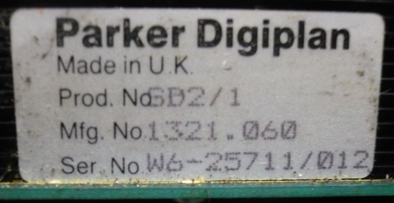

So here goes my first question...My lathe X-axis drive(PKS-DIGIPLAN  SD2) lights up a red LED. Then  a TO-220 Transistor or maybe a triac, I have no idea what this may be found dead. It has  a printed code _PKS0320 but nowhere in the Net I was able to find data or a cross reference for this . So, I have no idea what it may be .  I am just guessing this has to be a triac. In the Parker SD2 drive user guide  though, only block diagrams I  have found so far. Electronic schematics of the boards... nowhere.
Just in case  someone of you  had access to a stepper drive like this and happen to know what kind of IC this  is  please help.

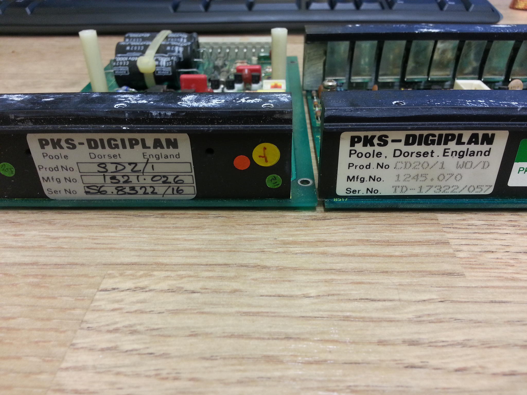

		Hi Asto, i'm a bit confused here. The first picture you posted shows a parker sd2 drive, but the second picture showing the component is of a parker cd20 drive.
Is the lathe an Easiturn, if so the drive should be a cd20, and to have an led showing it would seem the drive is a cd20 rather than a sd2.

		Well... i2i,
 I only have machines driven by SD2's. So, both pictures are from the SD2 drive. What you see in the 2nd image is the component side of the PCB which is visible_ copper side_(well that's o.k double sided board) in the first photo.

 that is a wierd one then, as i have an sd2 and a cd20 in front of me and the second pic looks exactly like the cd20. But not to worry, i'm glad you've identified the component. I spoke to parker today regarding a schematic, and they put me onto a company that may be able to help.

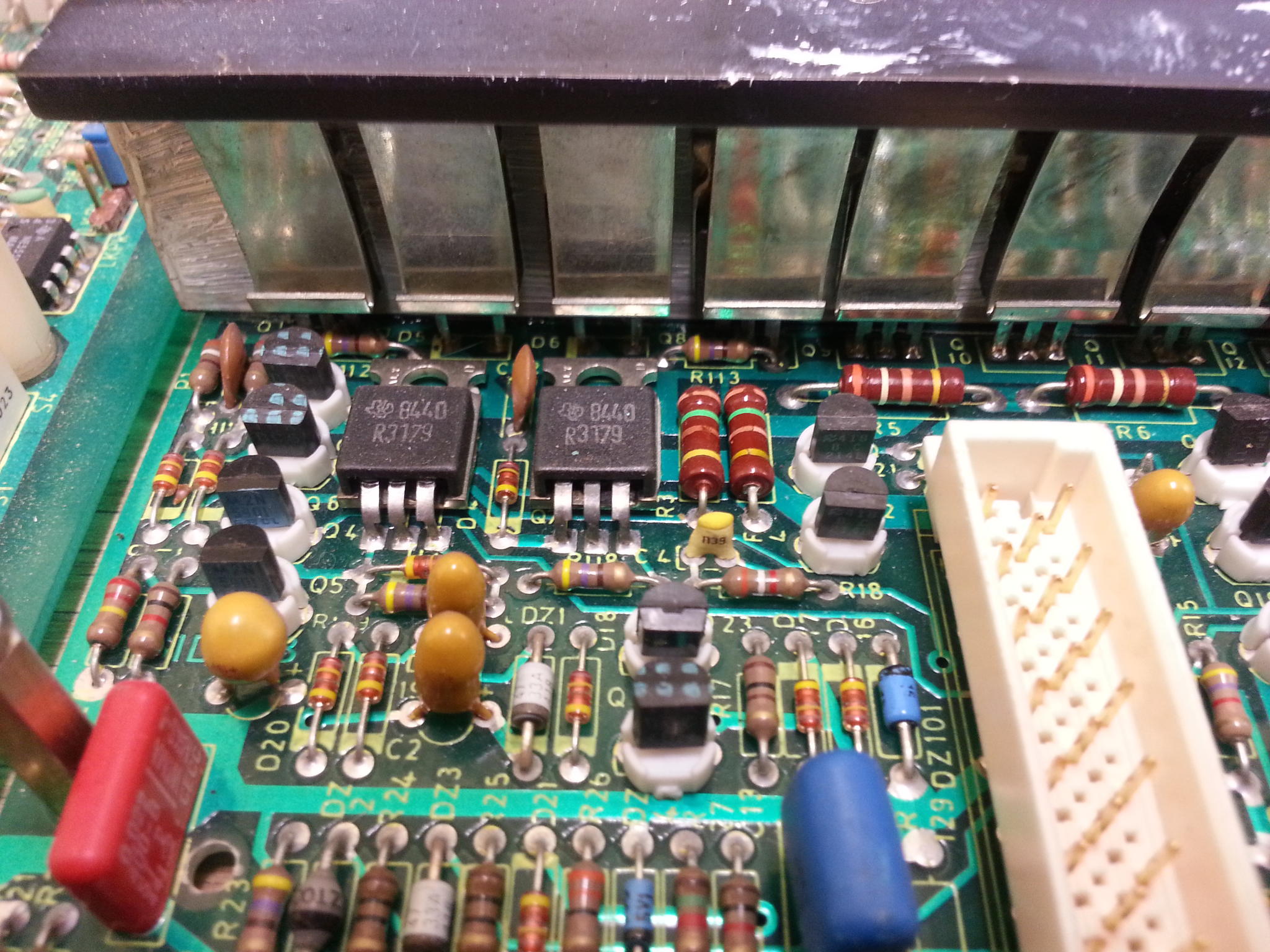

		...i2i  trust me. What you see in the second picture is what I took out from the SD2.
If a similar PKS-DIGIPLAN called cd20 exists I totally disregard. But this is my chance so please educate me.
How many Amps drive is that cd20 capable to deliver. Probably the machine you took this from is a more powerful one compared to the little Orac.
And this was not the first time the SD2 needed to be dismantled for fixing. In the past, it blew a 40xxx series CMOS. The CD40106.
But today it looks a bit different because I have added DIP sockets for every single chip. and the appropriate  sockets for  transistor or diode in the PC boards.

		Attachment 8565Attachment 8566Attachment 8567Hi Asto, this is a bit strange.
I've posted some pics of an SD2 with a CD20 next to it. The cd20 has another board in the centre of the two heatsinks which is removed to show the main board, this board has four leds on the left hand (rear) edge.
The Denford Orac used both types of drive, the cd20 version has a higher voltage psu (around 65v-80v), and the sd2 version has a 35v ish psu.

		i2i...the second  pic from left to right and the 4rth are pretty similar to mine almost identical but i see the white plastic socket contains three lines of contactors.  Mine has two connecting the main board where the high power transistors are with the signal processing board where the logic ic's are located and the leds are on this one the one on the top. You re right!
The first pic that i sent was borrowed from the internet not real mine...So it looks you have some point here.
The one with the exposed PKS0320 was taken by me few days ago.
 I can send you new photos that i can have from my machine tomorrow.
The first board though which i see must have come off a Triac mill. My Triac uses them because I can see the driver ic there covered under the flat springs. It is the L298. I had to replace this once.

		The Triac does use the sd2 drives on the x and y axis, and an sd3 on the z axis. This is on models up to the early 90's, and then they changed them to the sd12/13 drives.
Is your Triac one of the green ones with the open frame or a mixed white and green one?

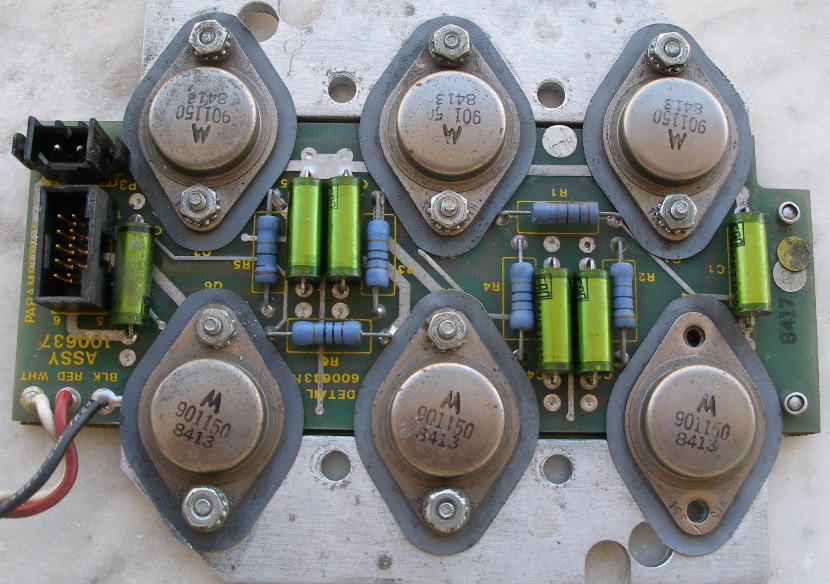

 Attachment 8644
This isn't a drive question but, again this module(Parajust single to three phase inverter) carries coding which is not common for TO-3 Motorola  transistors.
cheers
Re: Pks-digiplan sd2 driver IC help please
		Educated guess...   2SC901  NPN,....     if PNP then maybe MJ901 darlington (but doubt that)
asto

...Then I have another one for you Swarfing..
Can you tell what type these transistors may be?
cheers
		Asto please don't confuse me with some genius in component identification. Irving is probably in your best ball park for this one. It was an educated guess with the last one and a power of deduction. Looking at the age of the rest of the components  I would not even try to repair this...........There are some limits to when you just have to let go of this stuff. To also put something into perspective i worked in there 900/1800 phone division a very long time ago.
		Thanks Irving!
My DMM shows these are NPN ones.
cheers

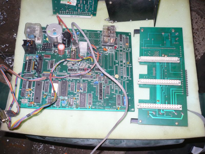

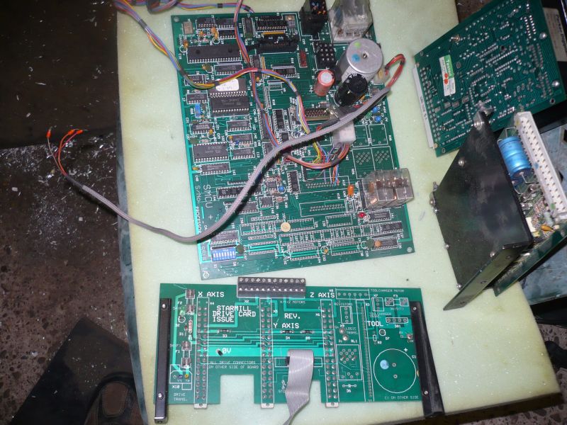

		Just found some sd2 boards tonight, 3 boards, mother board and backplane off a Starmill.
machine would home and that's all, suspect something on the MB went bad as the axis all moved but gutted it and put everything new in.
Any idea what these are worth before I bung them on Ebay ?
		Images are of great help in this case. Can you post some?
cheers
5 Attachment(s)

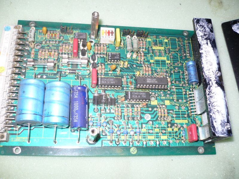

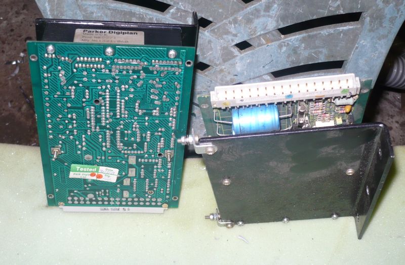

		Here you are.
Attachment 8699
Attachment 8700
Attachment 8701
Attachment 8702
Attachment 8703
I have taken the top shield off one driver for the photo but they are all identical.
the mother board has all the plugs attached to the sockets with some of the cable attached so it can be colour checked.
I'm guessing the fault lay on the mother board as it would home but after that nothing.

 Hi John-S!
It is nice I can view the images. Please tell me if your machine was modified ever. In case you are not sure please check the underside(copper side) of the mother board for non factory solder joints or wire bridges.
And, would you please make these images around 300K so I can tell if the boards are compatible with my Triac?
In case this image size is not allowed here you can use my address <[email protected]>

I can pay you 125 Euro for the boards because the motherboard is faulty.
If my offer is fine with you we can talk about the details. There is my email address in my previous message to you.
cheers
Asto
		Asto, will email you later tonight, on the road at the moment.
I have taken some more pictures but lost my bloody camera, put it down somewhere and can't find it.
However no jumper underneath on the mother board but two of the chips have jumper wires on top,
Drivers look clean both sides.
