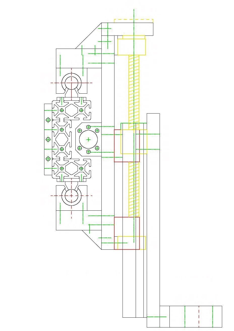

		Ok my mistake it is  2.85Kg and not 3.4Kg I made the mistake when I converted from 6.283Lbs to Kg.
Right now we know I'm an idiot I have changed the design round to the rails on the same plate as the spindle, The reason I did it the other way round was there would be less weight for the stepper motor to lift, I also have a question about the gearing, If I used a 2:1 will I not lose torque but gain the speed from the stepper motor?
Here is my new drawing see what you think, I would have liked to put the two bearing blocks in line with the gantry blocks but i would lose a lot of travel, Anyway how high should I make the bottom of the Z mounting that holds the router from the table.                          Attachment 8737

As Jonathan said this is all covered in most of the previous builds. Revised plan is much better but you could gain a bit more rigidity by moving the lower block down to match the end of the rail as your z axis blocks look a little close. The z axis is the weakest part as it is a cantilever and will flex the most, A larger distance between the blocks will also reduce the bending moment on the y axis (rotational lever arm effect) What travel where you looking for?
The z axis blocks don't have to be in line with the gantry blocks and it might be worth centralising them on the plate so the bottom of the router plate is in line with the bottom y axis beam as that will mean you can lower the gantry sides (whilst retaining the same clearance)to reduce the force on the x axis bearings.
My comments are only to help maximise the performance of the parts you have and are not a critisim of your design. Happy building
Edit. whilst supported rail is stronger with regard to the rail, the bearing is weakened by not completely wrapping around the bar therefore the bearings have reduced strength when pulled away from the rail , this is easily solved by mounting the rails back to back, or in your application on top and bottom rather than on the side. For example in your sketch when the gantry moves to the left the z axis (due to cutting force) will rotate about he lower bearing on the y axis and try to push the top bearing (strongest direction) how ever when the gantry moves right it will still rotate about the lower bearing but now will be pulling on the bearing which is the weakest direction.
Again this point is just a way of maximising the machine strength by design and I'm not saying that the method you have proposed is not good enough as it is probably more then adequate for most uses but my option just increases strength for free....
Height of the gantry needs to be as lower as possible but allow for the max depth of you work + how deep you need to to cut. for example if you work piece is 50mm and you want to cut all the way through you need to allow at least another 50mm for the cutter + shank and collet so say 125mm.

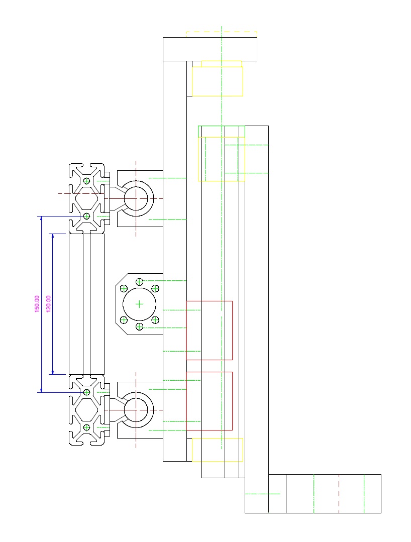

		Hi Ross77

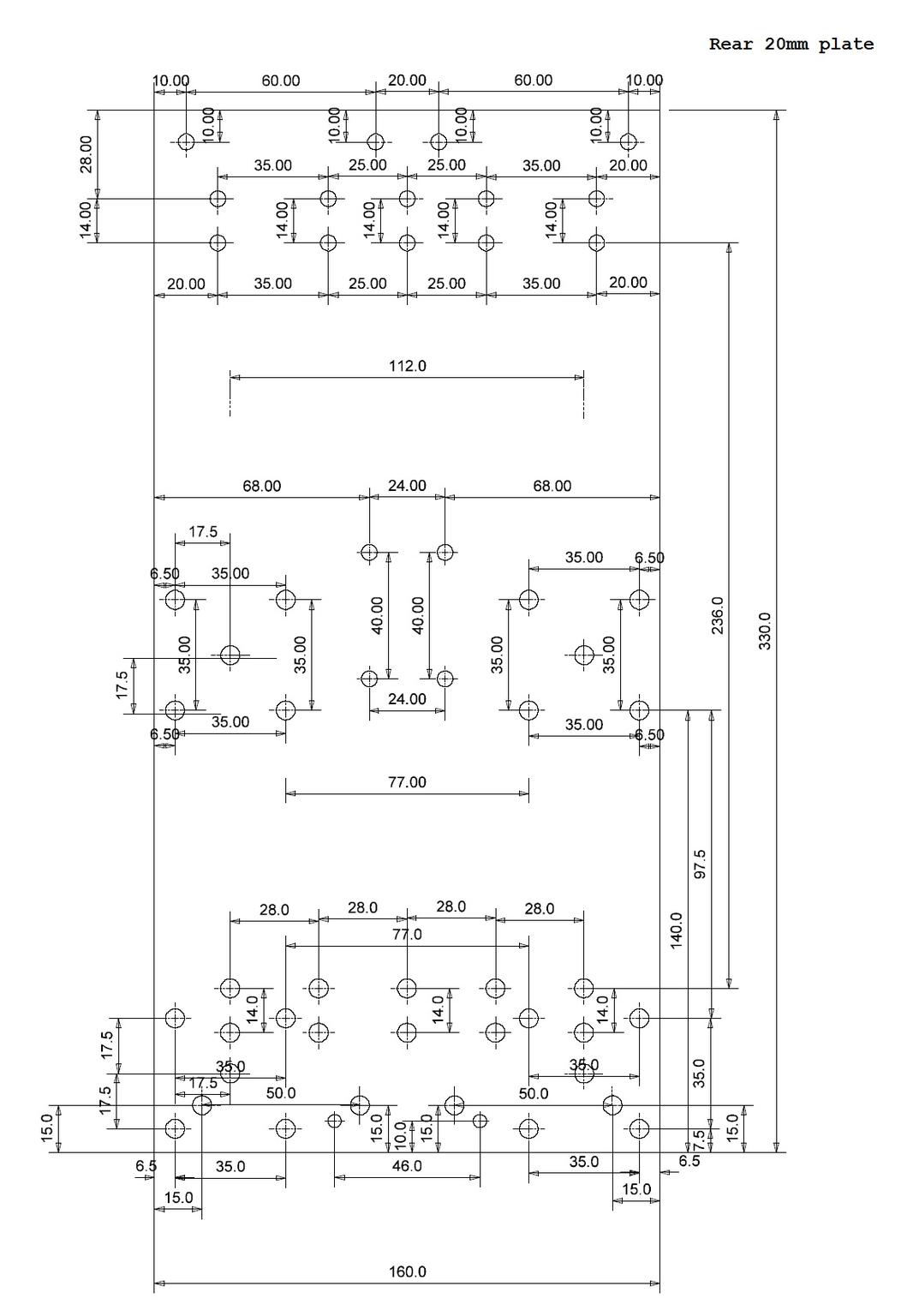

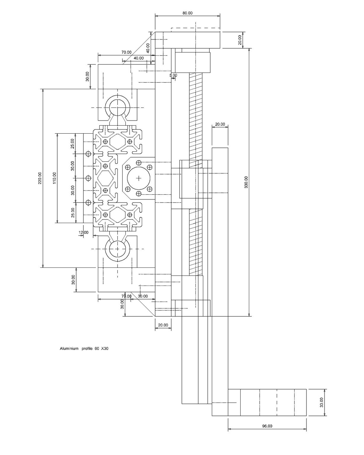

Right here I am again with the Mk10 drawing of the Z axis, I may see one or two other ways of doing this but I thought I would let you see where I am at this point.
I have about roughly 120mm of travel in the Z axis.
Now about the height from the  bottom of the router mounting to the table top. Do you mean that would be 125mm?
Attachment 8755
Re: Let The Fun Begain, New build on the Table.
		Yep that looks good. Mk10? so you have only just started then:friendly_wink:
I would increase the distance between the y axis rails to match the z axis plate to increase bending and torsional resistance.
If you have mounting clashes with the blocks then widen the plate, it would be best to make any compromises on the y axis side of things as this is more forgiving than the Z axis.
Yes I did mean 125mm from the bed to the router base. Is that not what you were asking?

		Just thought I'd better check but the 125mm was only an example, actual value will depend of your router collet and cutter length.
What router/spindle are you using? can it be fixed at the top as well? as the L shaped mount is also a bit weak.

		I have now reinforced the L shaped mount. Its now braced right to the top now.
The router that I will be using is the Kress 530 with a 3.175mm and a 6.35mm collets and I was going to get the mount from CNC4YOU.

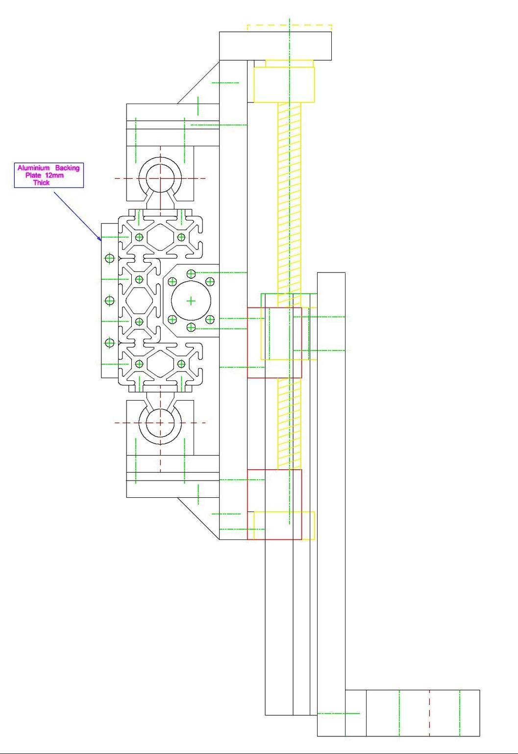

Here is the latest drawing of the Z axis.
Attachment 8782

			Here are the final drawings
No they are not at all final, they're still crap :very_drunk:
Look at the distance from the tool tip to the bearings above. 3 miles is too much.
Find a good solid cardboard box. Remove front and back. Try standing something on top.
When you figure out how to stop it collapsing, go back to your router drawing and try again.

I would agree that the gantry sides are way to slender. You either need to reduce the height of the y axis or thicken up the side plates with some of that profile section. Having now seen the whole design I would reiterate my earlier comment about increasing the distance between the y axiz rails as that will reduce the torsional force on the gantry sides and also give a better ratio of supported to unsupported plate (not sure if that's the best way to describe it?)
The Z axis is way to complicated , get rid of all the blocks and wedging plates. i.e. make the bottom plate as one piece that bolts to the bearing and is also the spindle mount. Do the same with the top plate and make it bolt to the bearing and be the ball screw mount. this will make it lighter, stronger and much easier to build.:smug:

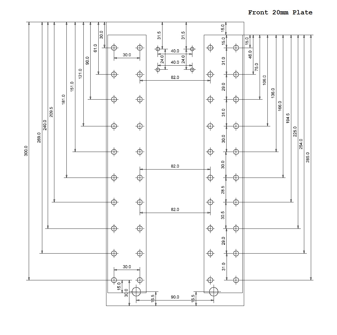

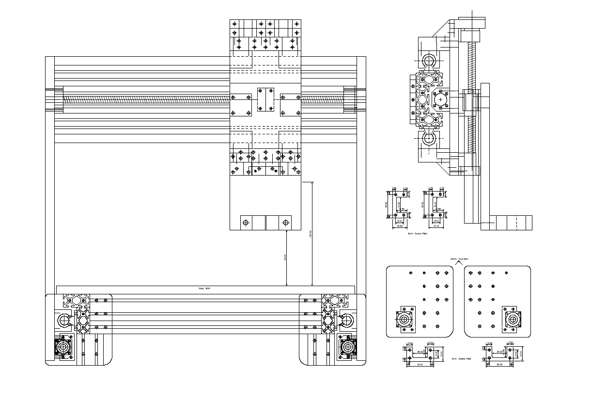

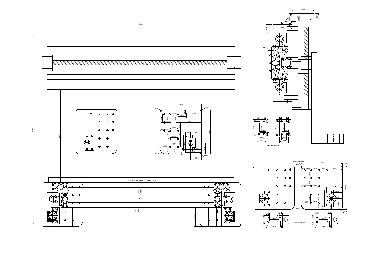

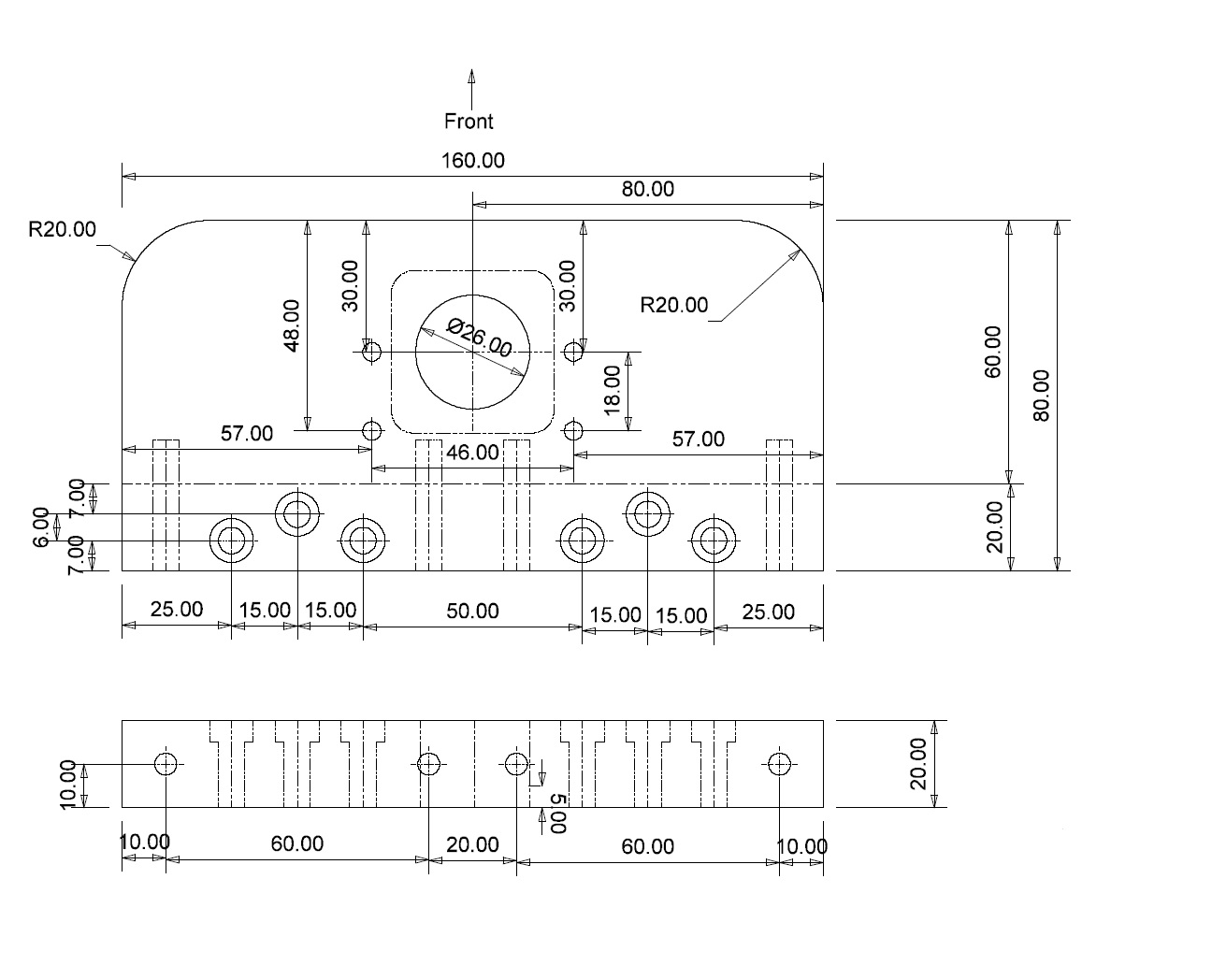

		Hi all,
Here is my new drawings for my 1100mm X 700mm X 300mm CNC, the only thing that I kept was the bed, everything is new from there.
I lowered the height of the gantry the Z axis from 125mm to 55mm (that's back to the height that I had my very first drawing) from the bed that should let me put a thin mdf board as a sacrificial board. The travel in the Z axis is 110mm.
The gantry sides are made out of two 20mm thick plate aluminium which will be bonded and bolted together, the first one is solid the second one will be  lightened. The Z axis will also use 20mm plate aluminium. The backing on the Y axis is 12mm plate aluminium bolted to Aluminium Profile Extrusion. And the X axis can easily  be stiffened buy adding more Extrusion to the Bed if needed.

		A quick thought!
Flip the 'Y' axis (top to bottom) arrangement over and add another plate to the back to mount the ballnut and you will always have a nice clean screw :thumsup:
		Looks good mate. are you happier with this as well?
Whilst myself and others could carry on making suggestions to tweek if further I think you have got to the point of a build-able machine, without going into calcs you have gone as far as you can.
The only point I would make and it is minor and that is that you might need to add additional support to the top of the X axis bearings to stop them opening up due to the weight of gantry, placing the rails and bearings on their side will improve load capacity but some of the cheaper bearing holders can give and open up the bearing.
I apologise for misleading you with the table distance as I presumed you meant with the z axis at the top of its travel. I see from your drawing you are talking about it a full extension.

			If you are making a box to encompass the supporting rail then you are actually increasing rigidity.
 Yes but its not so much the bearing mounting but the bearings themselves, open bearings can have quite a large radial clearance (10 to 50 micron), with the current set up and using a conservative 10 micron clearance (could be to 50), 100mm bearing spacing and 200mm spindle distance that results in 39 micron of free movement at the spindle. moving the ball screw the other side increases this to 51 micron.
This is free movement just to take up play, if you add any deflection due to load then this will obviously increase further. for cutting Ali the open bearings can run close to the max load capacity and as rigidity is a function of imposed load and load capacity then deflection will be high.
On the face of it 10 micron is a very small amount but remember this is only One element and doesn't include deflection in the part. if you lose 10 micron at every junction then it all adds up to a considerable amount.
Any way that's my take on it!
		Ross i did say that the plate could be moved further back. In this design there is no reason why the ballnut could be more central and the spindle moved closer to centre. There is no need to have the nut pushed further away from centre.
Ross77
			Ok better explain myself in case I'm wrong. :nevreness:
 I thought your first explanation was good, but the latest one is even clearer. I agree with the 39-51um figure and as you say it's likely to be more. Any compromise like this will reduce the stiffness of each element. You can analyse the stiffness of the overall machine as springs in parallel, so if you reduce one a very small amount it's not likely to make a tangible difference, however if one is reduced substantially such that the stiffness is lower than other elements, then that will dominate the system, causing the overall stiffness to be low. This means compromising one part can waste money you've spent on other quality (stiffer) parts. An extreme example would be using profile rails on two axes and unsupported rails on the other. In that instance changing the profile rails to supported rails isn't likely to make a difference, since the weak point would still be the unsupported rails. Similarly, 'making a box to encompass the support rails' wont make much difference, since that part of the assembly is already at least an order of magnitude stiffer than other parts.
You can get the ballnut in a more optimal position with the current design - it doesn't have to go behind to do that. Similarly the current design could easily have a 'box to encompass the supporting rail' added.
Swarfing
			Switching would save a lot of hassle having to sort extras like seals and way covers etc.
 Just stick a 15mm shaft seals, like these, either side of the ballnut and the swarf is wiped off easily. They're working well for me and not showing signs of wear, although admittedly I've not been using them for long.
 Paul I think we must be looking at different drawings:friendly_wink:
If you look at the Z axis drawing in post #18 there is barely enough room to flip the plate over. if you then centralise the ball screw you will have to move the Z axis assembly further away, making the situation much worse.
As I said there are other more pressing issues with the design but as the parts are bought and he wants that size working envelope then there's not much that can be done other than maximise the other components. Another reason for not moving the ball screw is that despite the large plate on the back the y axis could still twist if Mike decides to cut larger pieces of Ali. with the ball screw in the front it is a simple case of widening the y beam to increase its torsional rigidity.
Anyway I think we will just have to agree to disagree on this one.:beer: We all have different ideas and its up to mike to decide as ultimately he knows what is needed from the machine.
3 Attachment(s)
		Right, I have made one small change to the Y axis to tie it all together. So no more changed till it is built. I ordered some 6082 aluminium plate and have started to construct the Z axis.
I can only do a little at a time before the pain is to severe and I have to stop, It will be a slow build but I will get there. Anyway one drawing of the change and two pictures to keep you going.
		looks like some good progress Mike. that back plate will help stiffen it all up.
glad all the comments didn't put you off. keep it up

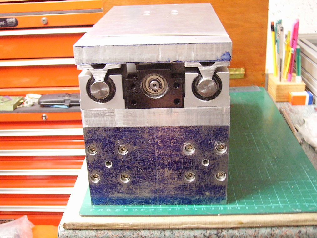

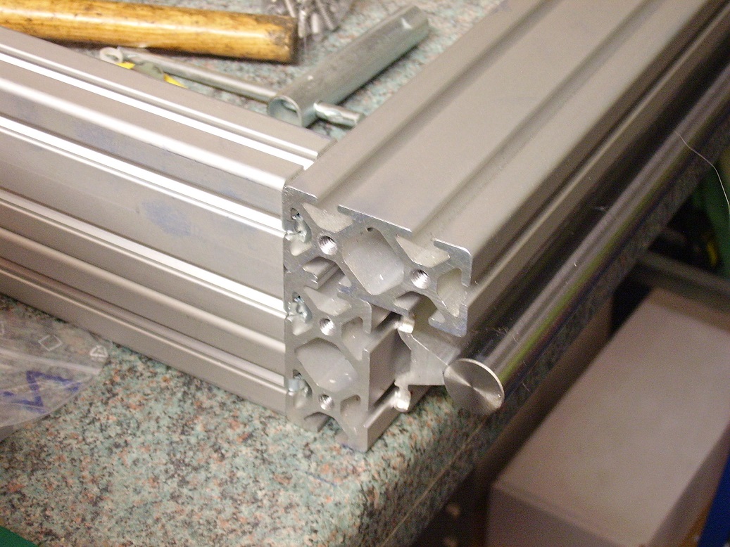

6 Attachment(s)

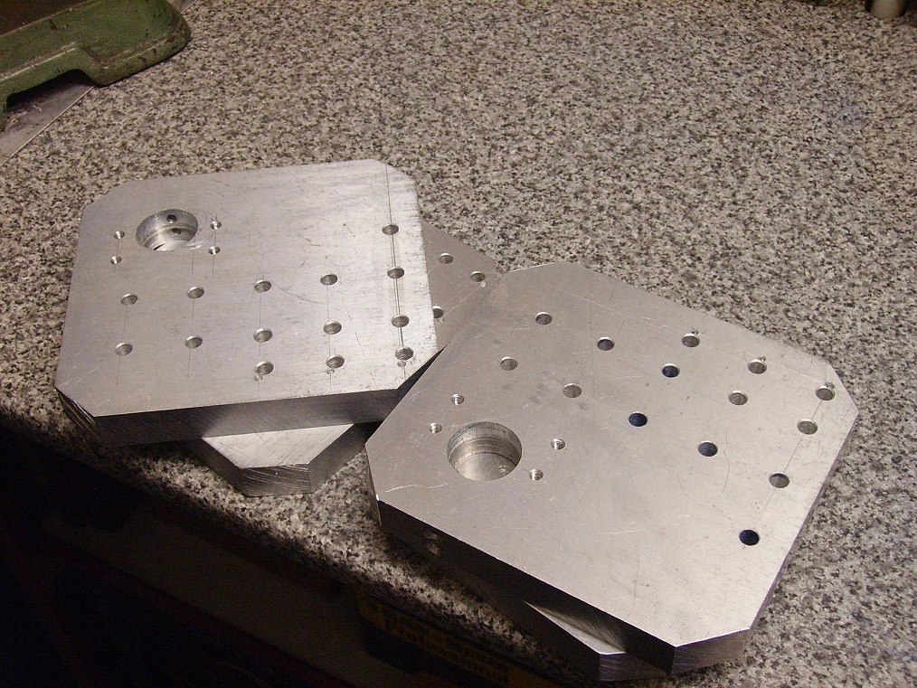

		Ok here is another part done I had to cut 3mm off the aluminium plate, as they came to large. Now the only way I could cut the 3mm off was with a hand held router and a M6 end mill with the plate held in a wooden jig. That was hard going. Anyway with stops to rest I did start to assemble the bed.
Attachment 8975Attachment 8976Attachment 8977Attachment 8978Attachment 8979Attachment 8980
		Looking really good. Any estimations on how much you think this project will cost?
Just wondering.... Where did you source the aluminium extrusion from? Thanks

		Bit late now but a chop saw would have been a good investment for you if you have problems using a hacksaw.
With the right blade you could have cut all the aluminium both plate & profile yourself which would have made things a bit easier, plus it would also be handy for cutting aluminium to size before machining it once the router is up & running.
 To get it up and running I hope it will not be more than £1500.  I tried to work out what It would cost then added 22%, I cost the bolts at about £40 but it has cost £59 in bolts so you need to add about 22% to what you think it will cost I have done this with everything that I have made and it's stood me well. It will always end up at the higher price.
