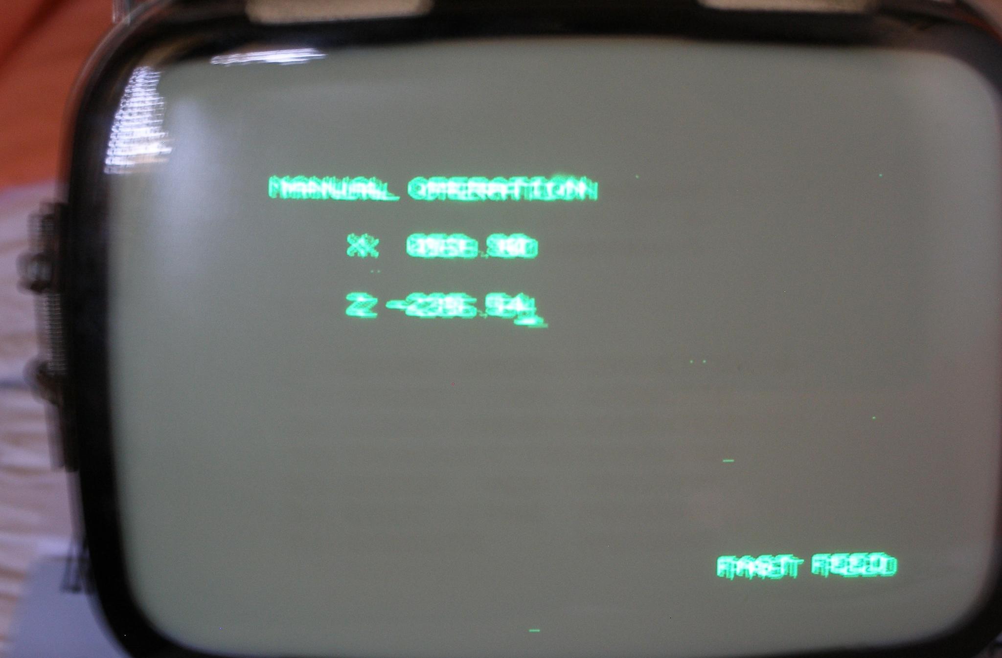

Asto,
Have you had a look at the interlock on the key/stop button I understand you turn the key to the right press button and it will not lock down, will display man opp but will not move axis, press and hold for 3-4 seconds to energize the 2 relays before the axis will move.

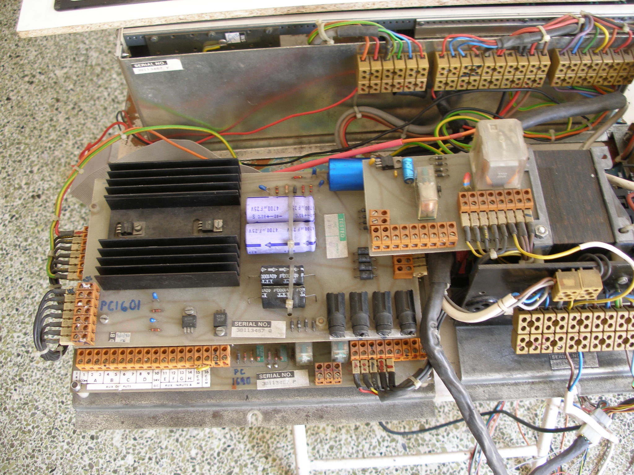

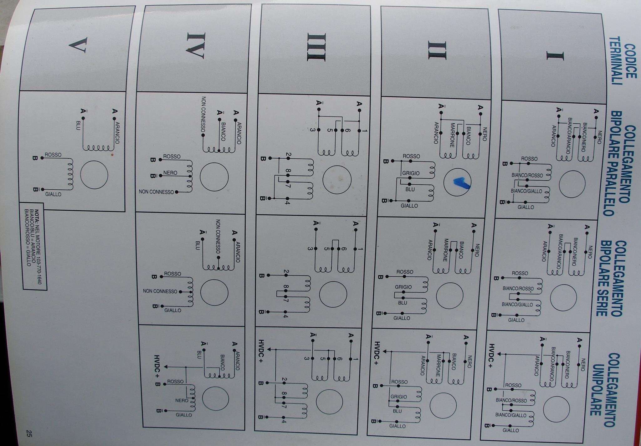

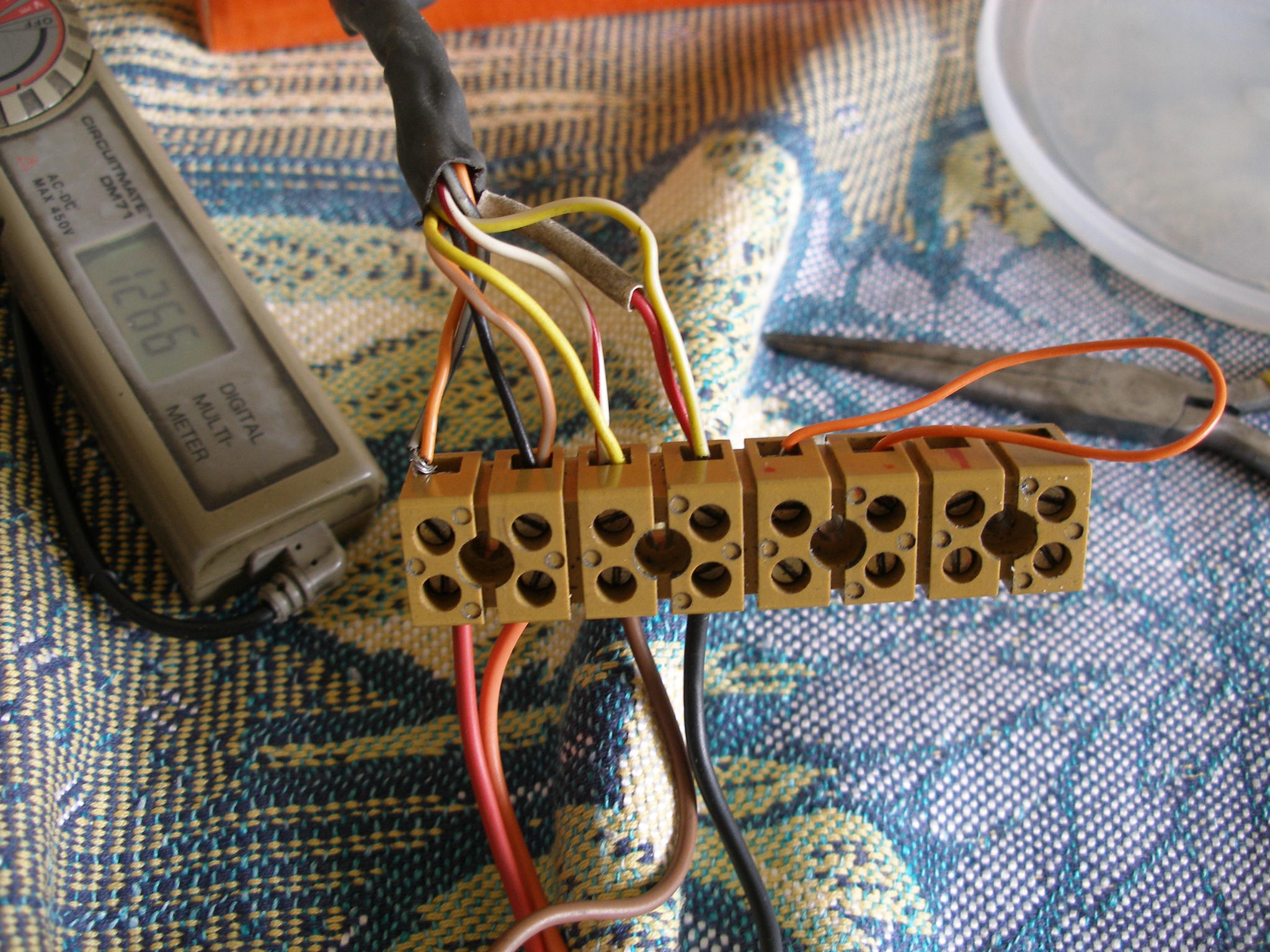

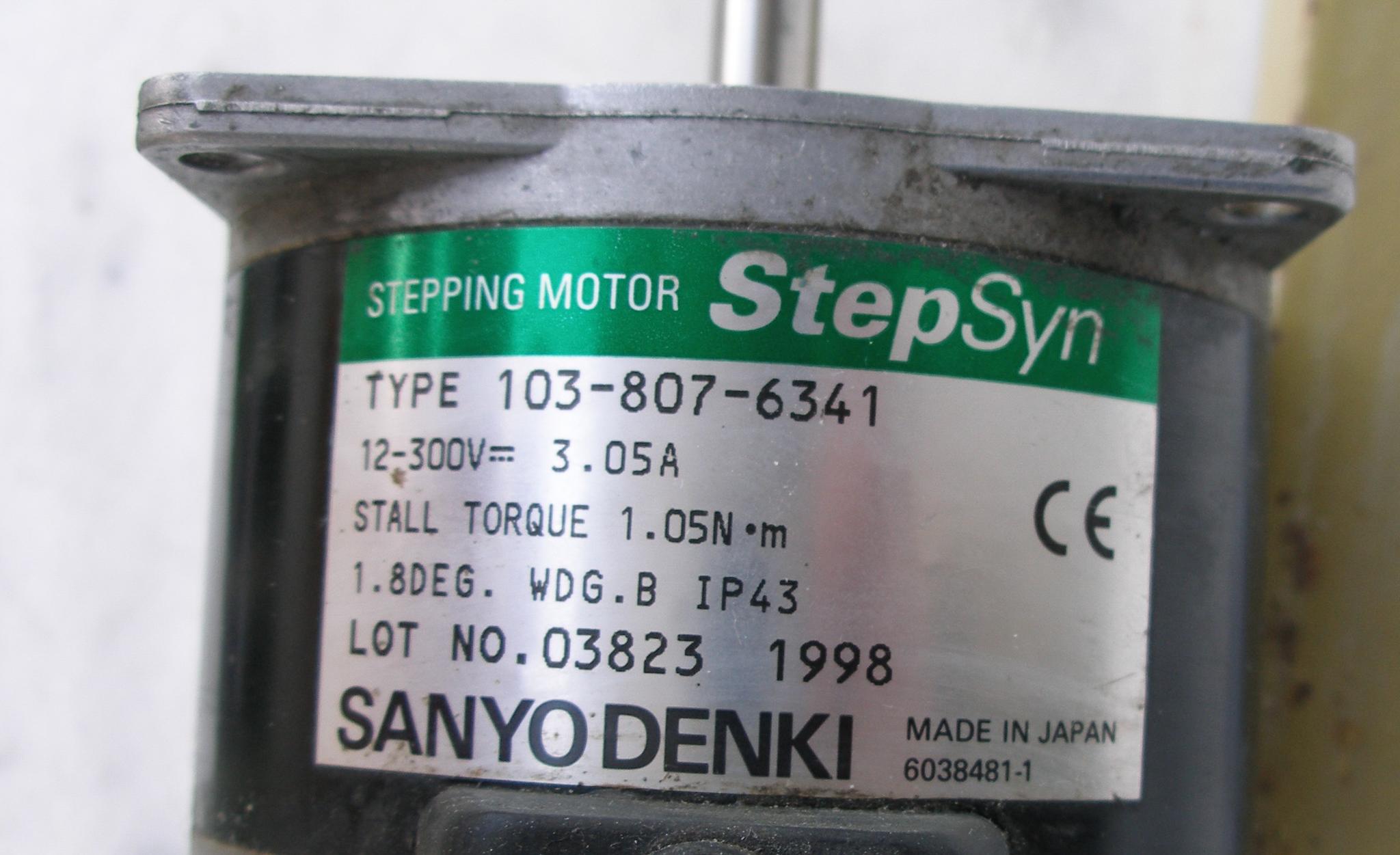

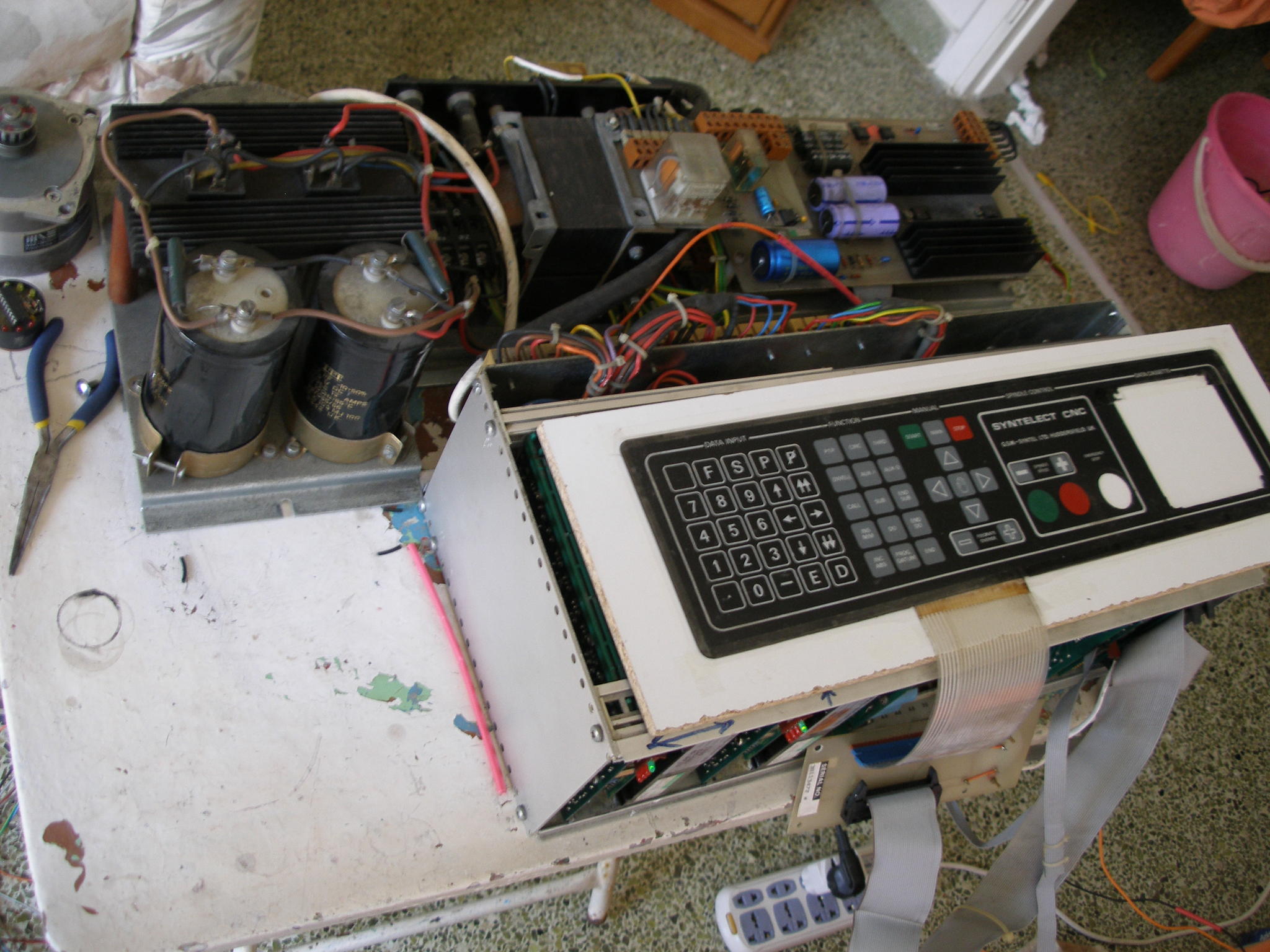

Hi phill05 and thanks for your participation and helping effort.
Well I just followed your suggestion but there was no difference. I need to tell you though that all the operating electronics and hardware are not tightened/screwed on the lathe. It is all on the bench where I will instantly notice when the change comes. I believe might have been a wire left unconnected or disconnected I am not sure which one is the right word here. Please correct me. For example I have omitted signal wires coming from the perforated speedometer disc, those coming from turret indexing sensor, as well as those directed to power chuck electropneumatic solenoid, those directed to Parajust VFD pot and stop/restart inputs.
When the machine's X-axis was losing direction 2 weeks ago, searching for faulty wire connections I found that the X-stepper was not wired correctly. When I restored this, both axes worked perfectly responding to sudden commands. Both motors now retain good holding torque.
Last night I replaced the 30 year old stepper with the one seen in the attached image...With the StepSyn steppers this Orac worked non stop for 5 years 4 to 6 hours a day...
regards
AstoAttachment 8767Attachment 8768Attachment 8769
