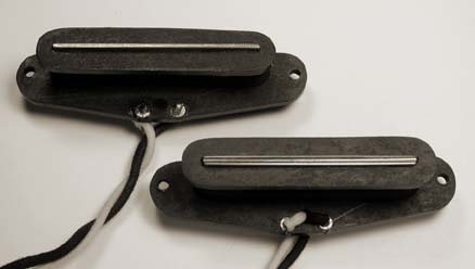

How do I get this widget made (a small rectangular bit of 1.6mm mild steel)
It's now looking like I'll need to source some of these in number, not even sure what it would be called (presently I refer to it as 'a small bit of rectangular 1.6mm thick steel'! - not that catchy - would there be a more appropriate name as used int he industry?)...
http://hostmypicture.com/images/part.jpg
If I know how it would be made, then I know who to approach.
Spec is ....1.6mm thick mild steel, about 33mm(ish) x 4mm (I'll also need some about 20mm x 4mm)
From what I can gather....laser cutting is out (deformation?), water jet cutting is a possibility but would probably need tabs...else the part falls into the water tank below! (which means a bit of a hassle tarting up the de-tabbed part) ....could something like this be stamped/pressed out of 1.6mm sheet? (sorry if this is a naive question....but this is all a brave new world to me!)

What is it ? A key of some sort like a woodruff key?
Could you not do them easy enough with a jigsaw? Use a guide & cut longish lengths, clean up the edges then cut them to correct lengths.
Re: How do I get this widget made (a small rectangular bit of 1.6mm mild steel)
It's a 'blade' for the inside (pole piece) of a guitar blade pickup, I found this on google images to give you an idea....
Attachment 8850
But these will be very low profile....& I really need the accuracy that I'd not be able to attain with a jigsaw (each long thin edge needs to be nice & flat...the top visible edge must look good, the bottom nice & flat so the magnets attach well) ...also, I'm not talking a few - probably at least one thousand pcs initially (& that'll get old very quick with 'me and a jigsaw!)!)
33mm long? where did the other 2 strings go?
For looks I think ground would be best, but then again gutiarists being the funny lot hey are you will probably have to have the option of chromed, black chrome, polished steel, ground and nasty gold plated.:thumsup:

Good spot...perhaps I could sell to banjoists or maybe back to the drawing board ;-)
Joking apart, that's just the blade for EADG...there's a small gap of 1mm & then B & E get their own blade/treatment (I didn't want to cloud the issue, hence only showing the EADG blade!)
