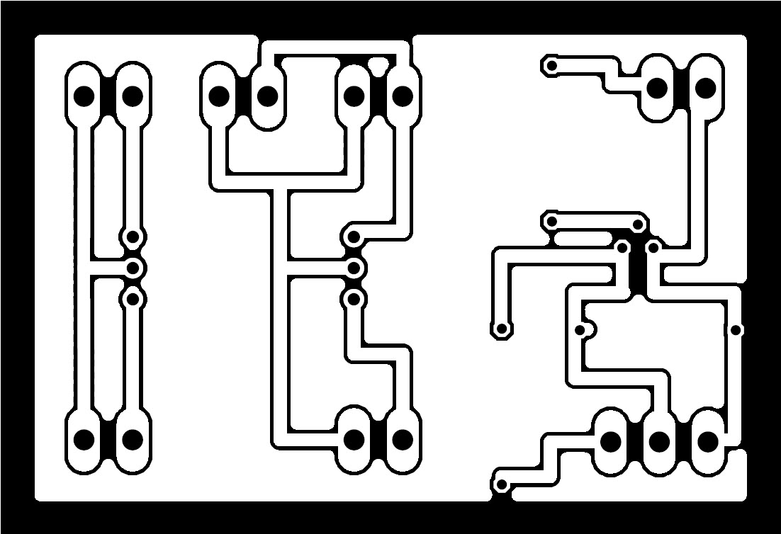

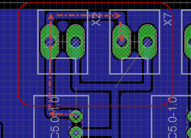

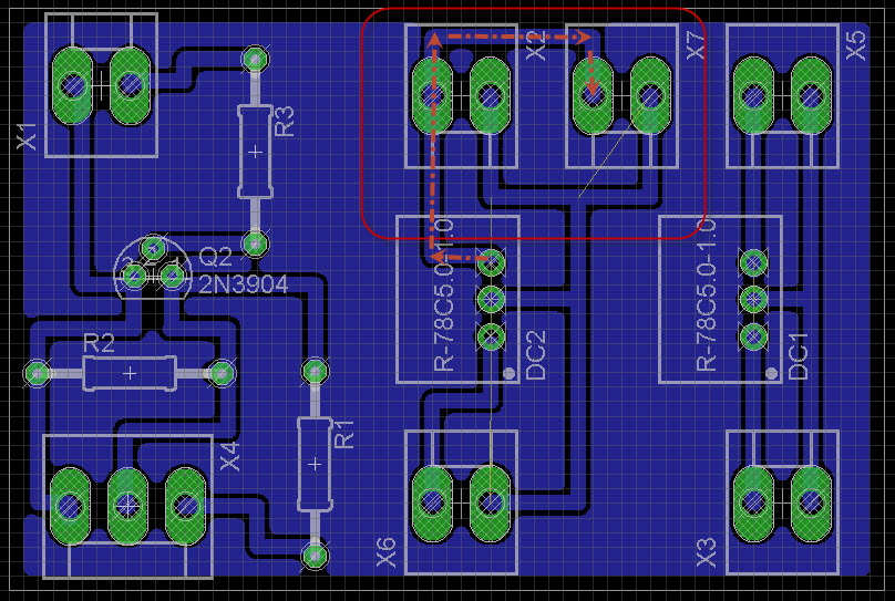

Question on PCB and routing , well more .. will it work I guess ? Anyway I have hammered the tutorials and finally got to where I think I can start to mill the board. Only thing is is a question on power voltage etc. as you can see I have highlighted my concern in a red box , this is two molex 2 male pin plugs , I want to draw power from both as they go to different parts of the hardware .. will this work ? Will this affect the voltage ?

and blew a close up :)
Attachment 8908
any help as normal appreciated :) only had four beers so far .. record lol BTW the board is tiny only only 60mm x 40mm .
Re: Question on PCB and routing
As long as your within the limit of what the regulator can supply AND the traces are wide enough for the current desired, it should work.
Depending on current, it may mean a slightly higher voltage drop at X7, however provided that whatever you're powering from the connectors aren't going to be affected by noise/voltage spikes from each other, and you're not going to overload the tracks, it'll be fine.

I've made the traces as wide as possible, I think it should be able to handle the current , suppose I wont know until I try it Bubba lol , again thanks for the reply mate :)

Hi MC , nah the last on the rail powers two 5v servos the first powers a raspberry pi , i'll have to rethink if it drains or spikes to much, but they are 7 quid a pop I would expect then to have some umthh ! lol

Use this: The PCB Track Width Calculator to calculate track width...
Incidentally, 3-pin regulators should have 10 - 100nF ceramic capacitors on input and output else things can get noisy. See their datasheets.

I normally include an electrolytic cap on the output of linear regulators, then add a ceramic near the input of anything that may be affected by noise.
Although things may work without caps on the linear regs, it's not good practise. Lots of linear regulators specify minimum capacitence on the output lines in their datasheets.

I usually go for 220uF electrolytics of a suitable volatge for throughole linear regulators, but that's probably overkill.

They would be fine - you don't need anything special like low ESR, but no problem using them. Still need ceramic capacitors on the input.
What voltage are you supplying to the 5V regulators and at what current?

The idea is to drop 7.2 v to a 5 v 1 amp and the other is 7.2 to 5 v 1.5 amp...the first feeds the raspberry pi the 2nd a USB hub
Ok, so you have (7.2-5)*1.5=3.3W dissipated by the regulator... you'll need a heatsink on that. The datasheet for your regulator (link?) should specify the junction to case thermal resistance which you can use to find the required size of heatsink, which may well require making more room on the circuit board.

Oh so they're switching, not linear, regulators - disregard what I said about the power dissipation then as that's irrelevant. I'd still use some small capacitors though.
You're pushing your luck asking for 1.5A from a regulator rated for 1.0A.

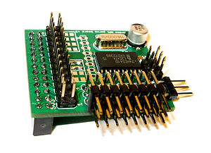

Hi Jonathan, yes there are 2 regulators R-785 0-1.0 and R-78B5.0-1.5 the 1 amp is for the Raspi and the 1.5 is for the USB the 1.0 amp has 2 output 2 pin Molex’s, one powers the Pi itself and the other powers Independantly RC-servo controller board for Raspberry PI Version 3
