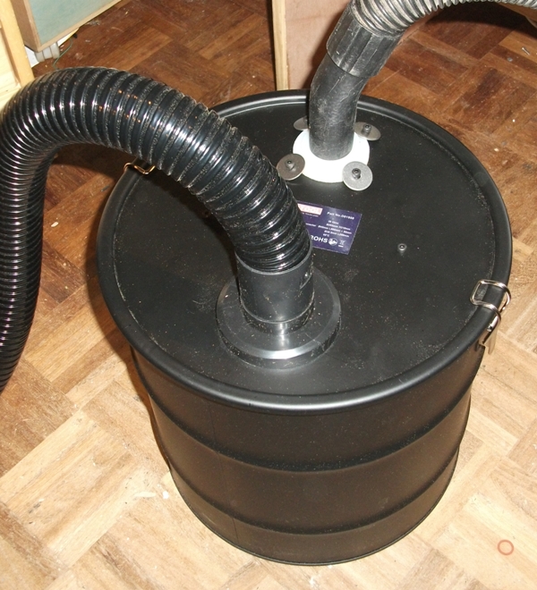

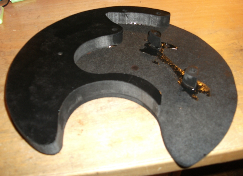

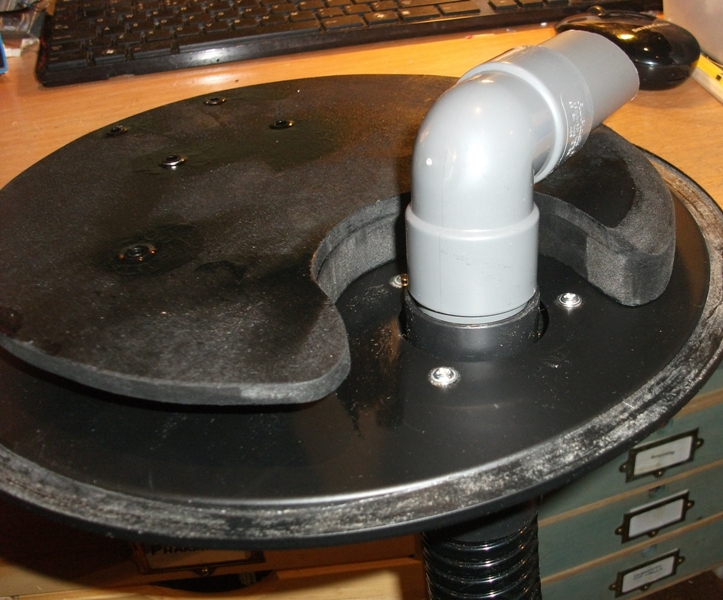

		BHF the thing arrived this morning ! It has now been converted to a cyclone (or if I have the direction wrong, it will be an anticyclone). I used mdf for the internal baffle and nylon to make an adapter for the vac hose. The swirl is a bit of 32mm FLOPLAST waste plumbing.  It seems to work OK, so I have dismantled it to paint the mdf. I have to clean out the vac to check the effectiveness of the cyclone, but when the paint dries I will photograph the bits and post the results.

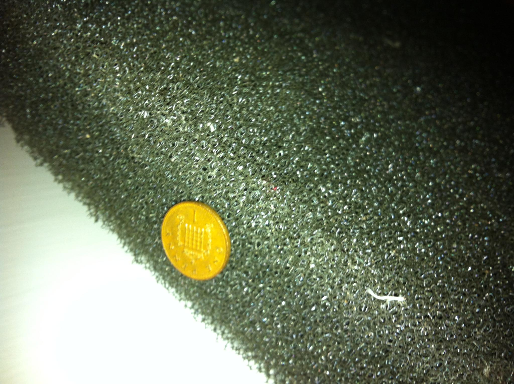

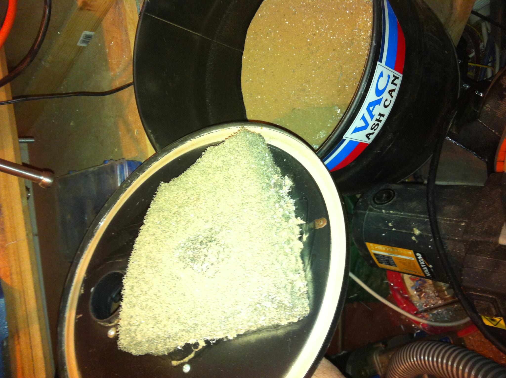

		iv been using an ash can from machine mart for about 8 months
i removed the mesh dome from inside and stuck a peice of HVAC filter medium over the vacuum inlet hole to filter the fine particals its been working fine and the cheap tesco vacuum rarely needs cleaning out.
Attachment 8921Attachment 8922
iv got a few peices of filter medium going spare if anyone wants one just PM me.
		7 Attachment(s)
		Re: Ash Can Filter very cheap dust filter :)
		Attachment 8923Attachment 8924Attachment 8925Attachment 8926Attachment 8927Attachment 8928Attachment 8929

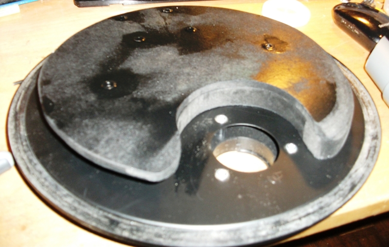

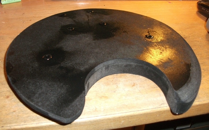

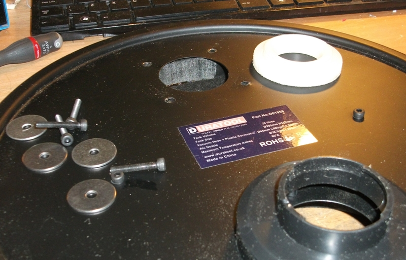

These pics show the baffle plate, the vac hose adapter and the swirl nozzle.  from the CPC ash can I didn't use the filter and the original vac connector. The handle holes were used for fixing the baffle plate to the lid.  This meant I did not have to drill or cut the original ash can at all.
So the whole thing cost me £10.75 for the ash can (free delivery) and the rest I had :-  a couple of bits of scrap mdf, a piece of 60mm nylon rod, 200mm of 32mm waste pipe and a bend, 4 washers, 6 25x 4mm socket caps and 6 improvised t-nuts (riv-nuts backwards).
I just hope that the device works properly, preliminary tests are promising :encouragement:
