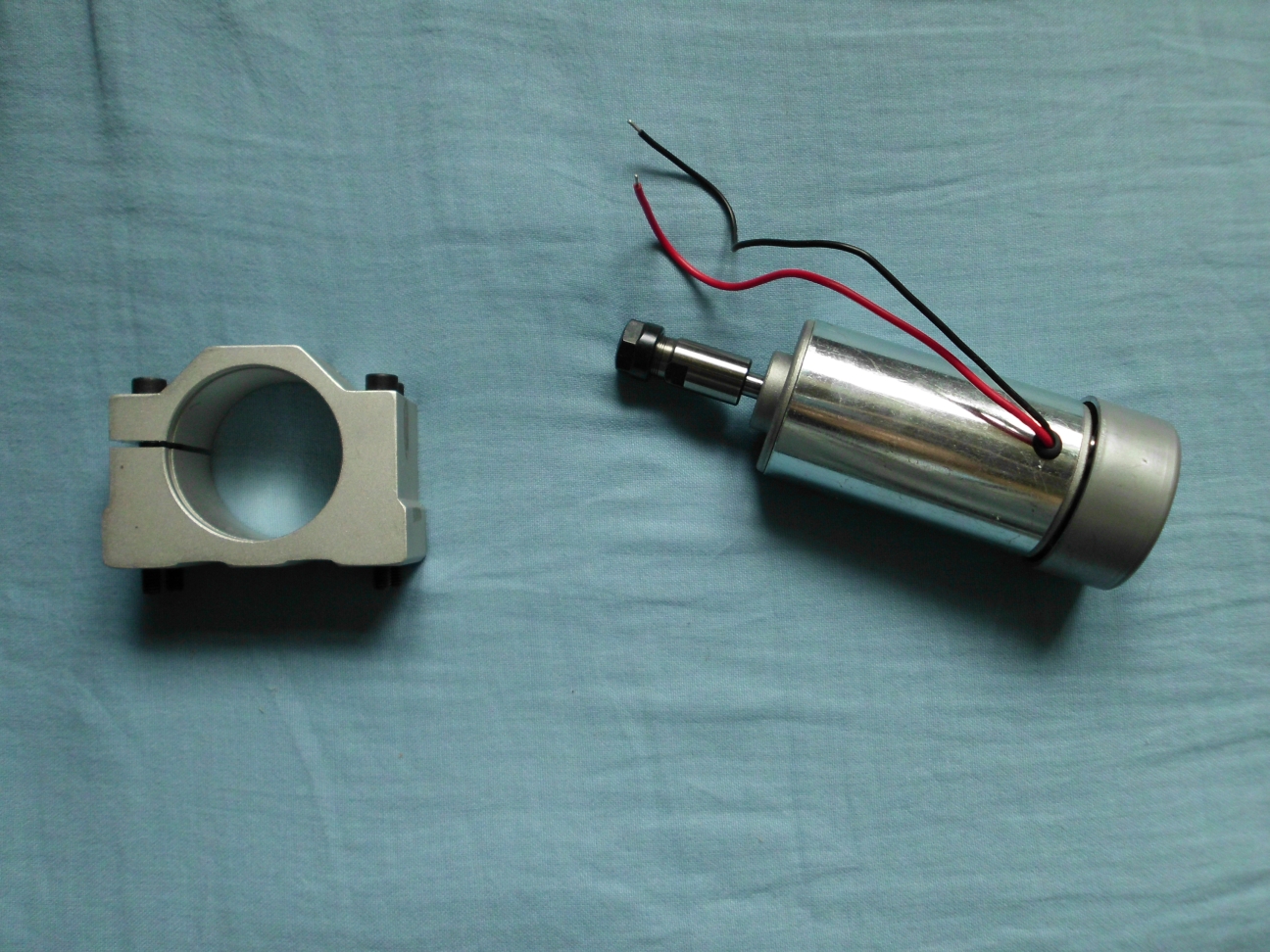

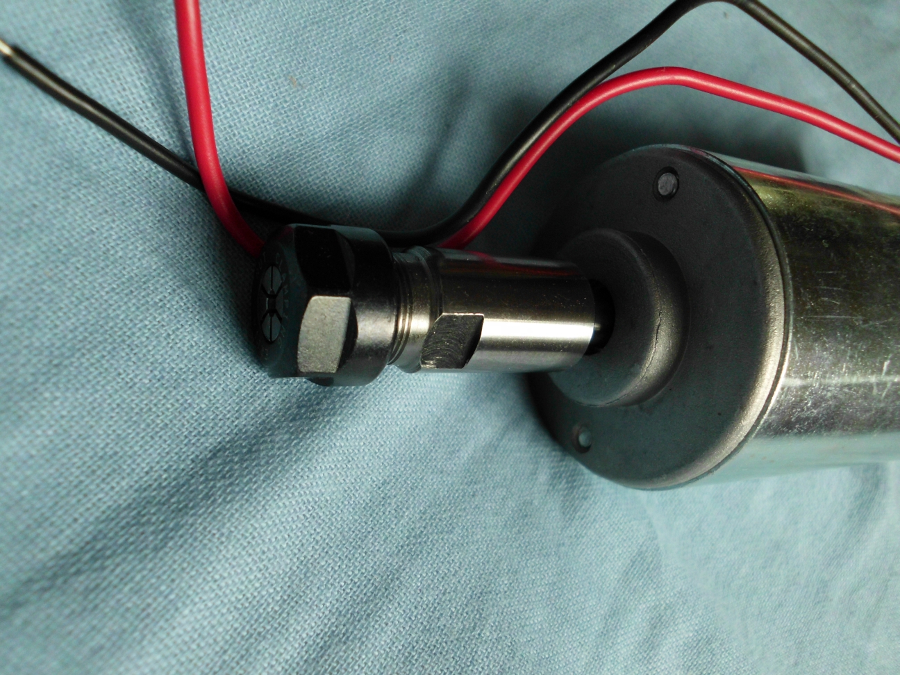

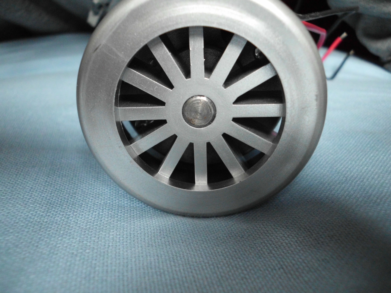

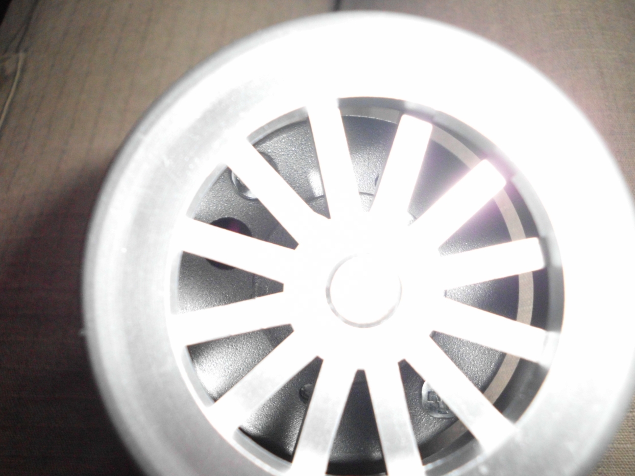

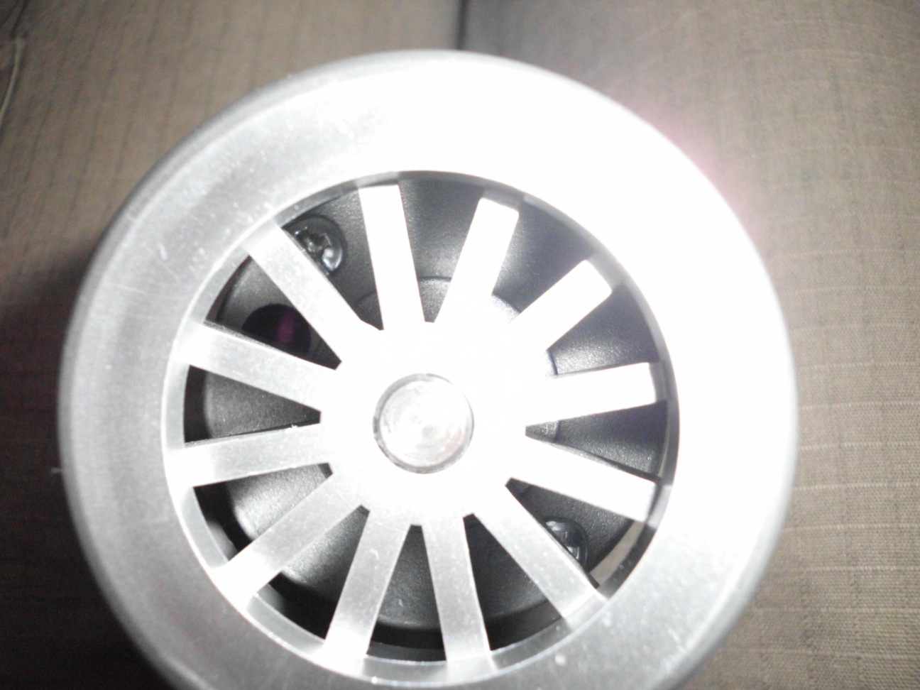

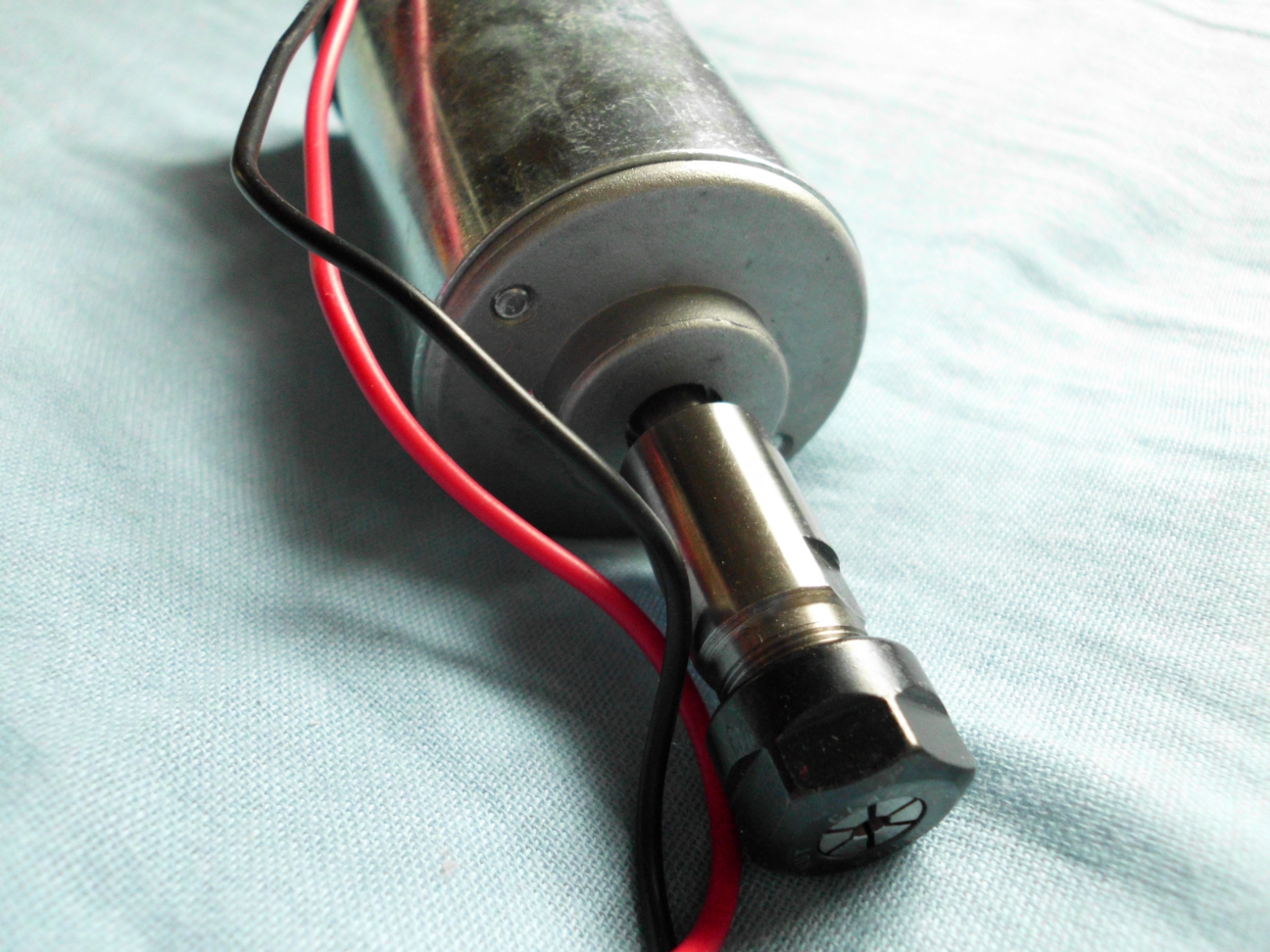

OK here are some pics of mine.
I've checked again and there is still no continuity between the body and shaft. Although maybe I've lost a few more marbles :highly_amused:
There are two screws under the plastic fan thingy on top which presumably would allow it to be disasembled, but I'm not sure you'd get the plastic thingy off without breaking it.

I have one of those spindles on my 3020 and it works fine for PCBs. I just measured between the thread the collet nut screws onto and the silver top end of the motor and got 2.4 ohms.
My spindle has had less than 5 hours use and I'm looking to sell it soon. I can confirm they are fairly quiet.

Well asbo's spindle arrived in the post today...as expected the bracket mount holes didn't align with my machine's Z axis, so an adapter/ bracket was quickly knocked up & it's all mounted now.
First impessions are favourable.
I can confirm that asbo isn't going doolalley.... ie there's no continuity between the chassis/casing & the shaft ....wtf? I'll look at lashing something up as a kludge, because putting a croc clip on the spindle shaft for every tool change is gonna get old very quick!
