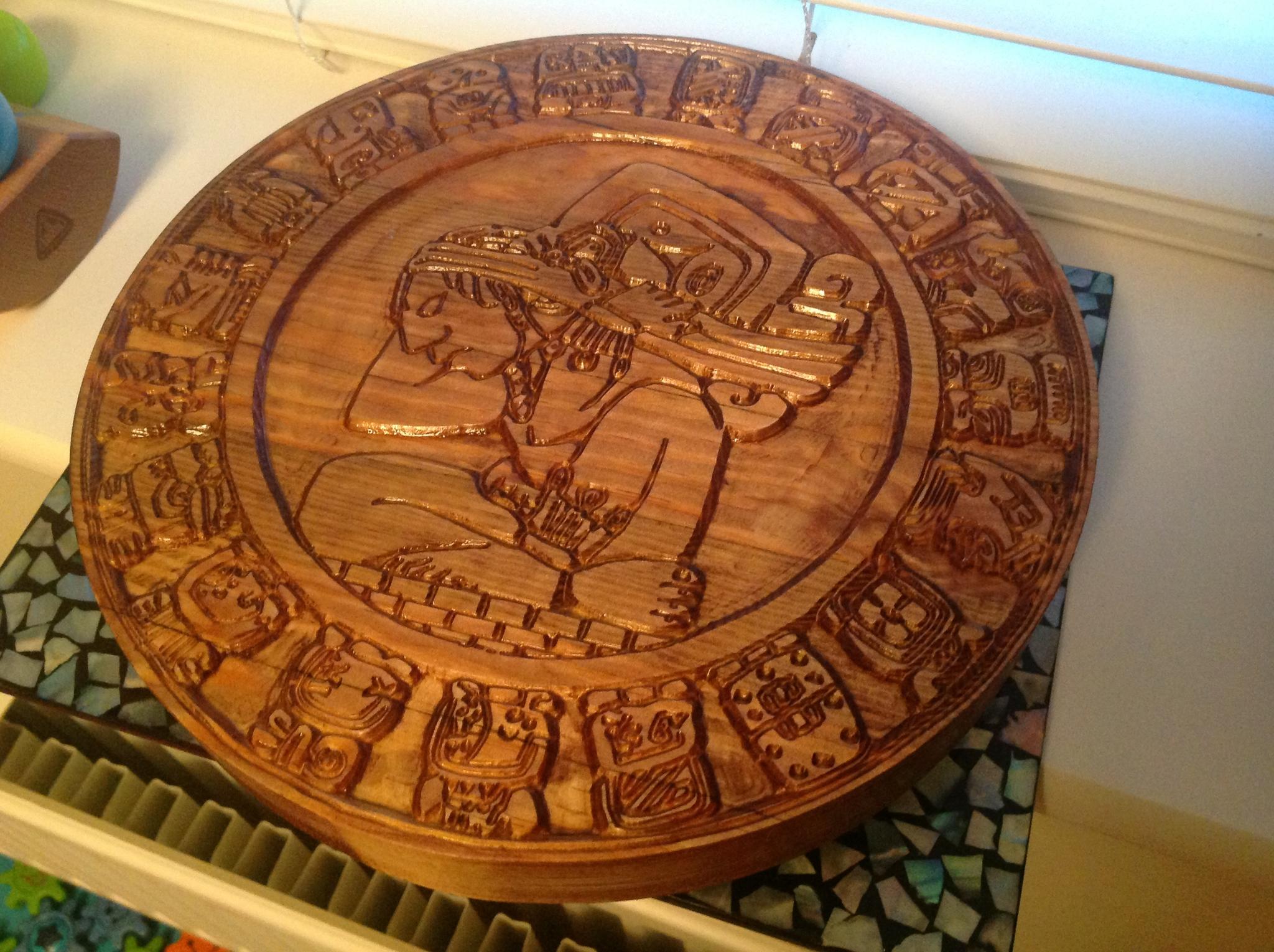

Ok here is my first go at something since my shocking egg shape circle test cuts and I have to say I am proper chuffed with it!
I have seen the aztec sun stones many of you guys have which look great but thought it may be a bit ambitious for my first go so i decided on a maya calendar design which looks far simpler!
I don't have any nice wood but I had an old piece of timber in the garage (pine I think) so I cut into 3 bits, surfaced the sides on the cnc, glued them together and then cut the calendar design.
A little bit of tweaking after the cut to tidy up and happy days!
Attachment 9087
I know there is lots of room to improve so if you guys spot anything and have advice I would be happy to hear it.
Very happy! :thumsup:
Jim

What was the total run time for the job, cutter used and the size of the part?
.Me
re: First project! A Maya Calendar
Thanks Lee!
Finished size is 260mm diameter and 35mm thick.
90deg 9.5mm v bit - 40 mins (it was quicker but I had to slow the feeds right down as I have a bit of flex in my machine and slowing it down seemed to compensate well enough)
3 mm end mill to tack the flats down 2 mm - about 10 mins
6mm end mill for the profile cut out - 4 mins
Jim :smile:

How much sanding was involved? did it frey on the detail? Ive looked through your previous posts no photos of your machine? lets have a look....

I used a brand new v bit and there was hardly any clean up on the detail to do after. Just a couple of sections needed a scrape with a blade. Unfortunately the flat areas was a different matter..... Very bad fraying around every edge! I do wonder if it would have been better to do the flat spots first followed by the v carving? I imagine the v bit would have cleaned it up quite a bit?
Also the flat areas really showed up the alignment issues I have the z axis. It left lots of lines on every flat area, which needed a bit of sanding. I have been looking into getting a dial test indicator to measure and sort the alignment but I also think I have an issue with flex on the gantry....the z is fixed to the gantry by two (thin) unsupported rails....yeah I know, the unsupported rails are not great and I think one of my next posts will be to ask advice on how I might approach changing them. I will strike some pics of the machine up then for everyone to have a laugh at! :courage:

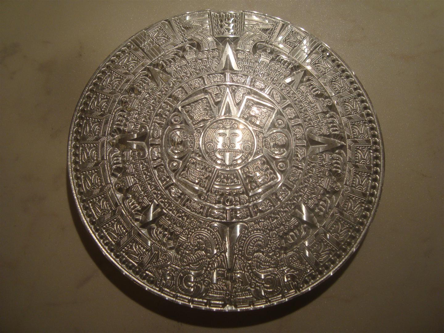

That looks good. There's a more ambitious one here if you want to try it. This is the one I cut, aluminium naturally:
Attachment 9101
