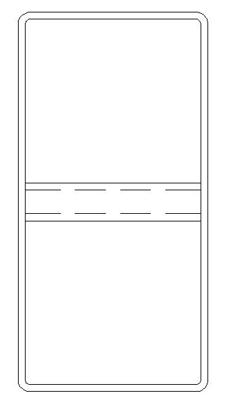

How about using a thinner wall and reinforcing with either plates or tubes inside the box? The tubes go across the inside faces to prevent the walls collapsing when you tighten the bolts...

Normal practice with the tubes is to saw them to about 0.5mm undersize a tack weld them inside the box. Obviously you can't do that if your holes are not near the ends of the box.

If using thinner wall box, you can drill right through enlarge the bottom hole to allow the tube to pass through end extend at the bottom by say 5mm. Bolt up (long bolts) very tightly and then weld the tube extensions to the underside. The use of lighter tubes would certainly make any future move easier. G.
Re: Buying SHS and RHS Steel.
In my honest opinion, I think that 6mm wall thickness on those lengths is way OTT. You'd have to use something like M16 or M20 bolts to match the shear strength of those sections. It is generally poor design to pass a bolt through a box section as it will crush the walls unless you use reinforcing tubes as suggested earlier. The next option is to drill a clearance hole in one face and use short caphead bolts and nuts so that you're tightening face to face rather than across the section. If you insist on having threads in the box section, you could also weld a nut or threaded block inside the box section. Or you could use rivet nuts: How to install a rivet nut (rivnut) and the tools you need - YouTubehttp://www.youtube.com/watch?v=KeaMsvai0FA

Ermmm...so that brings us back to the beginning...why do you need such thick wall box sections? Is the frame going to be supporting several tonnes?

Heh, no, you're right. I'm not going to be supporting a great deal of weight. To re-cap:
The frame needs to be built in situ (in my cellar) and will at some point in the future need to be dismantled, so - welding is not really an option.
Bolting it together is very much an option. To avoid issues with rigidity and to give me a reasonably good starting point in getting the frame square, I have decided to build a squat floor level frame (as in the animation at the top of the thread). This means I'm using less metal, but I still need the frame to have a fair bit of heft to it. In it's current theoretical spec the frame alone weighs 110Kg. That's not super heavy, but it's also not that light. A reasonable compromise, I'd say. Using 6mm wall box section not only adds to the weight of the frame, but it also means that I'll have an ample 6mm of thread for the holes that I'll tap. That, to me, is important.
Attachment 9168
Yes, I could use a screw and a nut through oversized holes, rather than tap into the box, but for now I'm favouring the former (threaded) approach with the screw passing through an oversized clearance hole.
Because box section has a slight curvature across it's profile (exaggerated in the pic below) using section with a thinner wall there'd be more of a danger of distorting it when torquing up the screws - 6mm wall will help to mitigate this.
Attachment 9169
So while I am over-engineering this a bit, it's for the right reasons: weight and rigidity.
