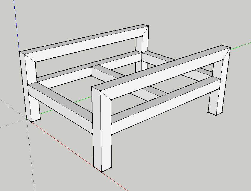

		So I have been interested in making a CNC machine for at least six months now hence my membership of these forums. I have been thinking of this design for the past month and have had it rolling around in my head playing with different ideas. So far this is what I have come up with.
http://i550.photobucket.com/albums/i...S_RENDER_1.png
It's 800mm long and 600mm wide - I'm aiming for a cutting area of about 650 x 450. It's small compared to some but I want to keep it very strong so I've used 50 x 50 x 3mm box steel and have welded it together instead of aluminium and bolting. I want to use two 1600oz Nema 34 motors on the X and one on the Y for speed and accuracy. I will also use a very high power spindle to ensure my fast feed rate.

I also need some opinions on how to do the gantry. I want to just have a peice of 100mm square box steel resting on the carriages spanning the rails but I can't really decide where I will mount the rails on the gantry like one on the side and top or both on opposite sides etc.

		That what I like to see a man getting on with it and not talking about it. . :applause:
Couple of suggestions.! Put some triangle plates on those upright legs to support them.!! . . . I know your thinking is he on drugs this things built like brick shit house but When machines cutting you'll be surprised just how much those legs resonate and this will transfer thru the gantry and down to the finished cut quality.
I'd also do something on the inside to help keep the frame square, either with similar triangulation braces or plate with holes in each corner then threaded rod between to pull square.
Because you have welded the top rail box section it means your linear rail mountings are going to have to be cock on parallel because you have no adjustment. It also means your top rail surface or plane is fixed so again if you have any discrepancy between each side it will be difficult to get out.
If you bolted it to plates then you have a lot more freedom to shim and adjust into parallel and same plane. There are ways around this like Epoxying the top rails so they level to each other but this is more involved. Depends what you plan to do with the machine but building in adjustment helps greatly with setting up.

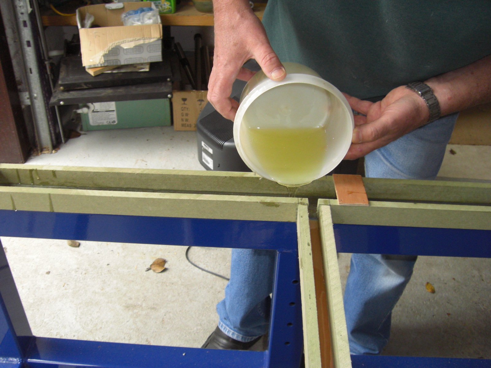

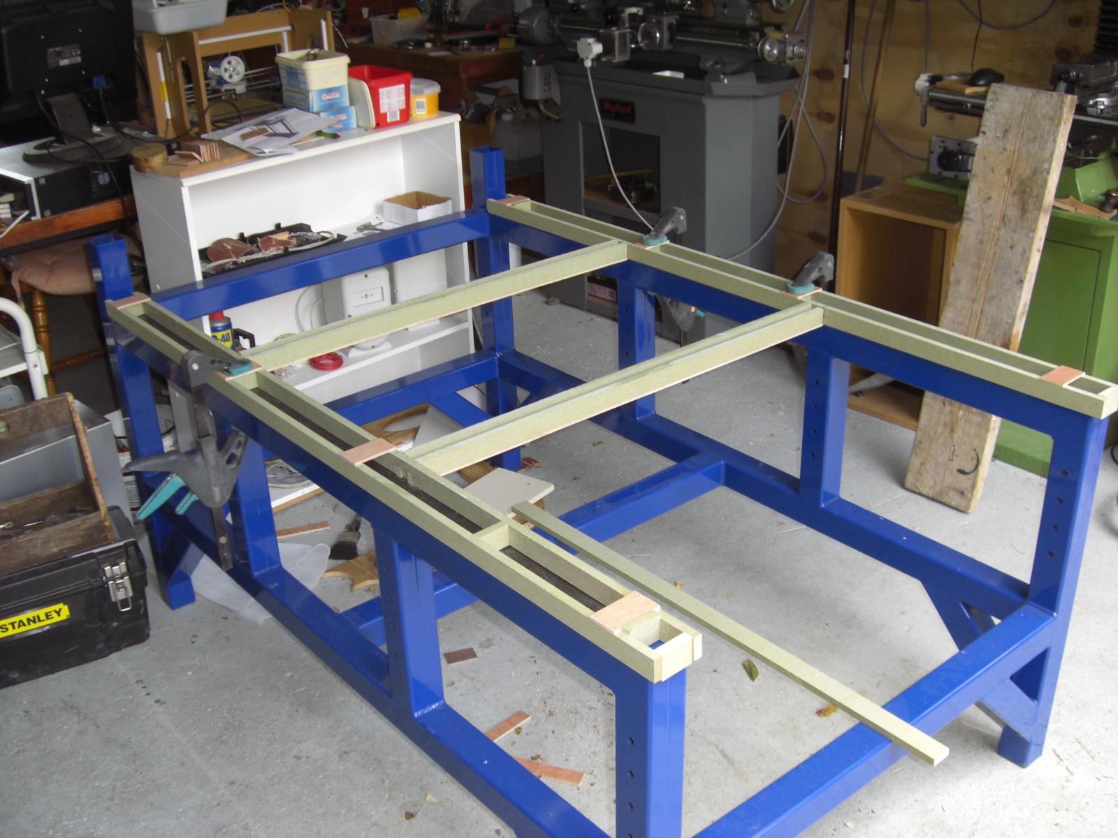

			 There are ways around this like Epoxying the top rails so they level to each other but this is more involved..
 I sort of made a similar frame and used epoxy like others have done on here like this:-
Attachment 9411Attachment 9412
The bridges from one rail to the other is to allow the epoxy to self level.
The Epoxy is Wests System 205/109 very slow setting hardener   ..Clive
		Re: My first project: A fast router...
Clive S
 Now I wonder who gave you that idea Clive.? . . . Lol . . . . Looking good.

 Maybe wrong but not sure your understanding fully what's meant with being level.? . . . Rails Being level makes no difference, they could be at 45deg and machine will still perform fine, it's the relationship between the tops of both rails. They MUST be on the same plane if not then you'll never have a accurate machine. Measuring for this is not so easy and angle doesn't come into, both rails could be perfectly level but still not on the same plane.
Has for top rails moving out 1.5mm again that doesn't matter so long has the linear rails are mounted parallel to each other.
What would matter with the top rail is if they were tilted which would make the top surface plane tilted at an angle relative to the other rail, effectively creating 2 planes at different angles to each other.
To imagine what I mean look at the top rail End on, now imagine there's a line extending parallel to the top surface or plane across to the other top rail. If either rail is tilted they won't align and you'll have 2 planes at different angles.!
Now this won't affect you to much because your planing on using round rail and the way they work it allows some error in this regards and I'm explaining this in case you win lottery or decide to blow your grant change your mind and use profiled rail also for the benefit of others who may not understand the importance.!
If you did use the much better Profiled linear rail then it would cause serious problems because when you fasten the gantry to the bearings, the bearing plates are at angle so when tightened down the gantry will try to twist them into the same plane has it and make them lock solid.
These may seem like small things but they have HUGE impact on how accurate and smooth the machine performs and sorting any error here at this stage is much much much better than trying to deal with it when machines built.!!
