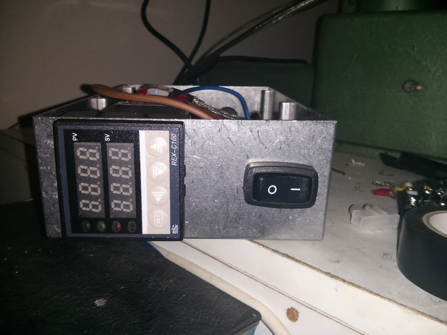

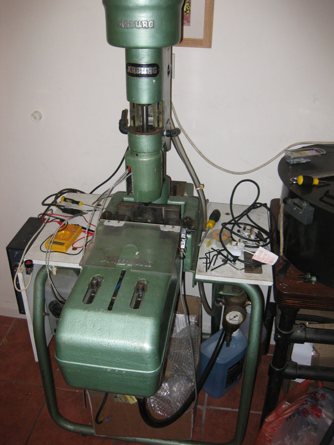

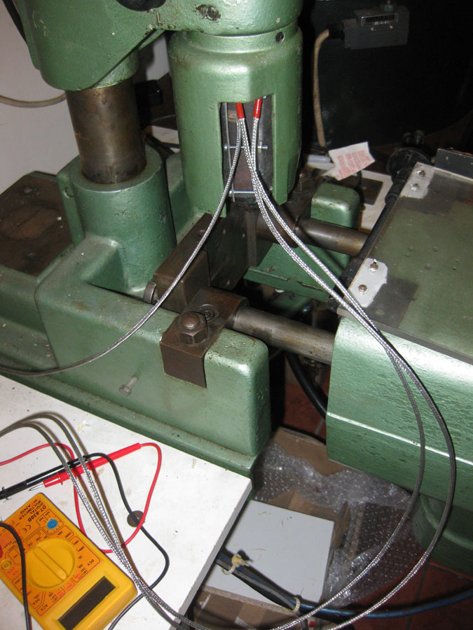

 Hi deisel,
I'll give some more details of my machine as a number of people have now asked about it. I have a little Arburg C4 machine, it runs on compressed air. It has both automatic and semi-automatic modes. The machine was built in around 1953, so it rather old. I have spent the past few weeks cleaning it up and it. It can hold little 95mm x 95mm mould plates (hense why im looking at a milling machine to make them). I'll attach some pictures of it, I won it on ebay a little while back, and cant wait to get it running fully.
Heres my little beauty!
Attachment 9441

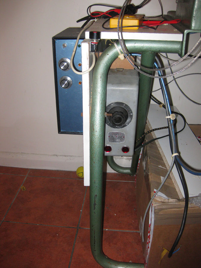

Here is the Electronic timer and old thermostat
Attachment 9442
The mould plate area and injection nozzle
Attachment 9443

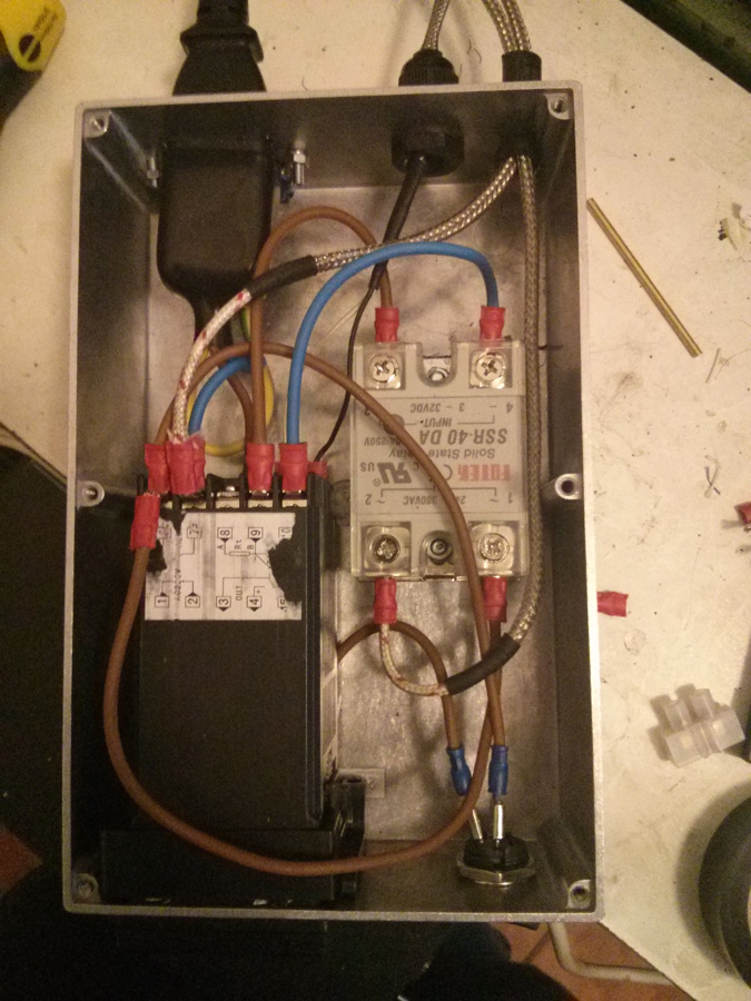

Inside the new Thermostat i just finished
Attachment 9444
View of the PID from the front with on/off switch
Attachment 9445

		You have my attention Deadmeat3d love the injector would be interested in how you go with that , keep us posted :)

		That little machine looks like it will be very useful when up and running. War gaming figures sounds interesting, I make small scale dolls houses and have considered doing some "derelect" structures for the WG market. I think making the moulds for your figures (I presume not flatback) would be quite difficult as I believe the most common method is wire errosion. Do you sculpt your figures yourself? Interested to hear you cast resin into silicon at present, I do a bit of white metal casting (centrifugal) into silicon moulds. G.

 Hi Fivetide,
yeah its almost ready to go! Just need to hook my compressor up to ensure the pneumatic's are working fine, then it'll be time to get the mould done! There is a german company called Hasco who make small mould blocks, so can pick up everything i need from there, bar the actual cutting of the tool. I tested the PID lastnight with the thermocouple, and worked a treat, definitely better than the old dial one.
 Yeah i hope it will be. I managed to track the original manual down online, so have good reference for it. Ah nice, have your pictures of you work? The WG scenery market is becoming a flooded area, so make sure your product is different, and well priced ;). Whats flatback? Hehe, this is why im here, to find the best way to go about making the moulds. I dont sculpt myself, i generally get 3d artists to sculpt stuff and then i print it off my 3d printer and cast it in resin. Ill attach some photos at the end of my work. I just picked up a centrifugal casting machine and vulcanizer off ebay dirt cheap (infact you can see part of it in the pictures) as the mis-spelt centrifugal, so no one else found it.

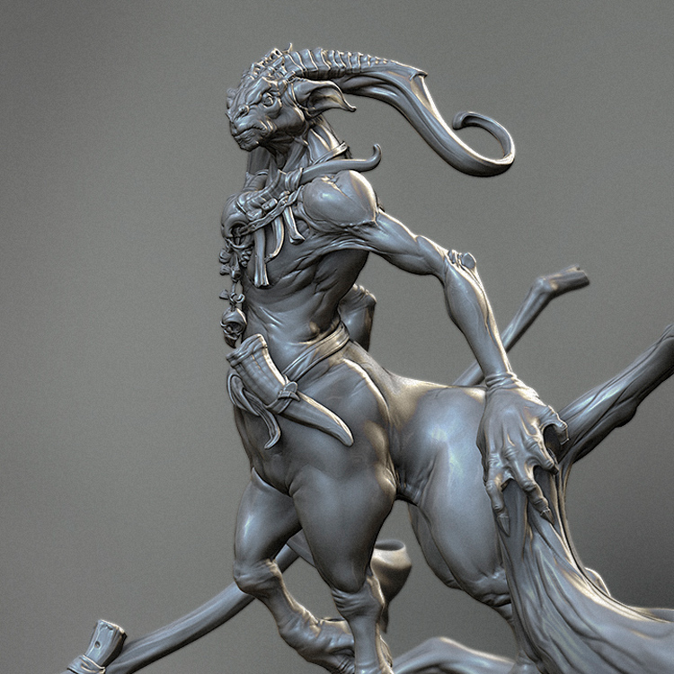

Heres some pictures of my stuff.
3D render of the model
Attachment 9447

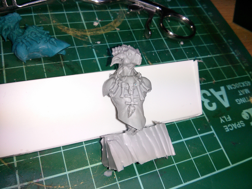

Resin cast of the torso (you can see the blue 3d print just behind it)
Attachment 9446

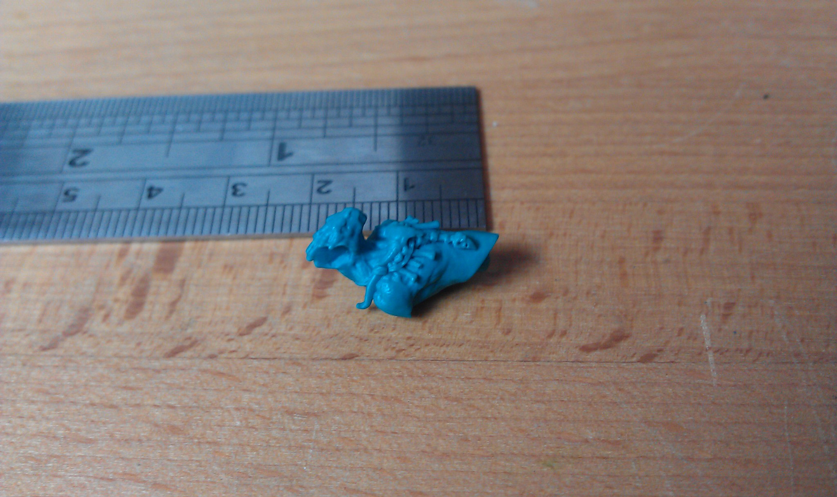

Baby version of the torso as i was play about.
Attachment 9453

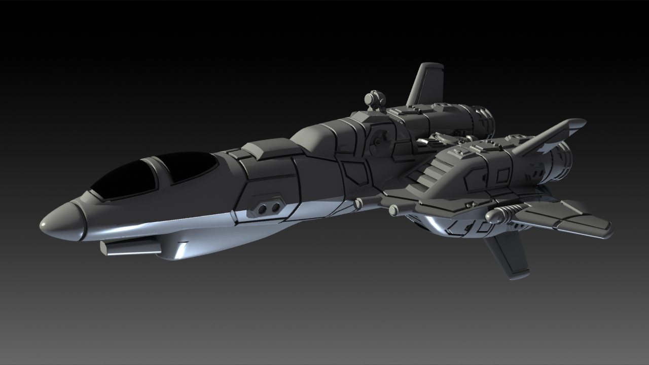

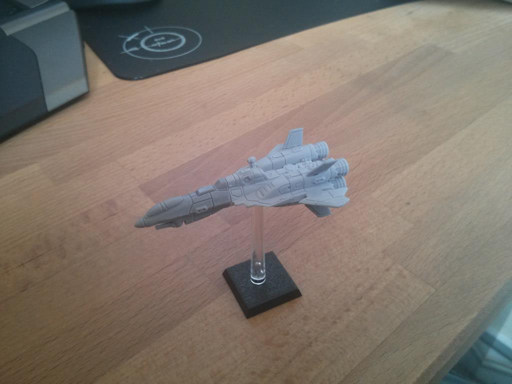

Front render of a spaceship
Attachment 9449
Rear render of a spaceship
Attachment 9448

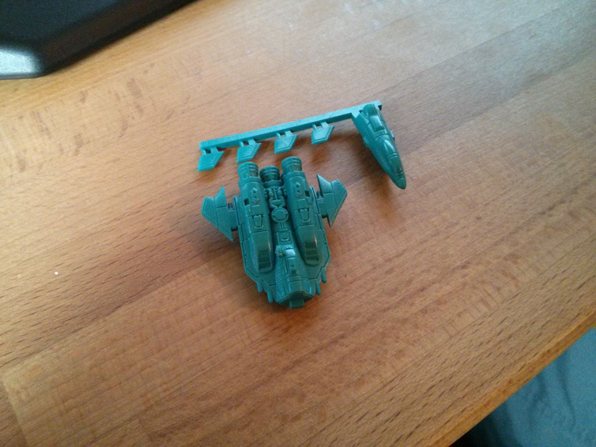

3D print ready to be moulded
Attachment 9452
Finished model cast in resin and built
Attachment 9450
