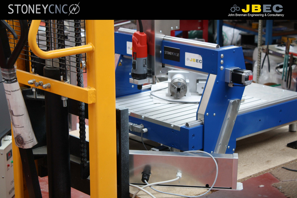

		JBEC router system UNDER THE BONNET
		Further to the post on the new JBEC CNC router system availabe in the UK
http://www.mycncuk.com/forums/manufa...ilable-uk.html
The following is some information for those interested in under the bonnet inspections. Apologies this has taken longer than expected. Not enough hours in the day and I wanted to do it right and be as comprehesive as possible in the hope that on day in the next decade we get the JAZZCNC seal of approval :)
Right - here goes...
So the pictures are all from our JBEC 604012 model shown below in Figure 1.
Attachment 9473
Figure 1. - JBEC 604012

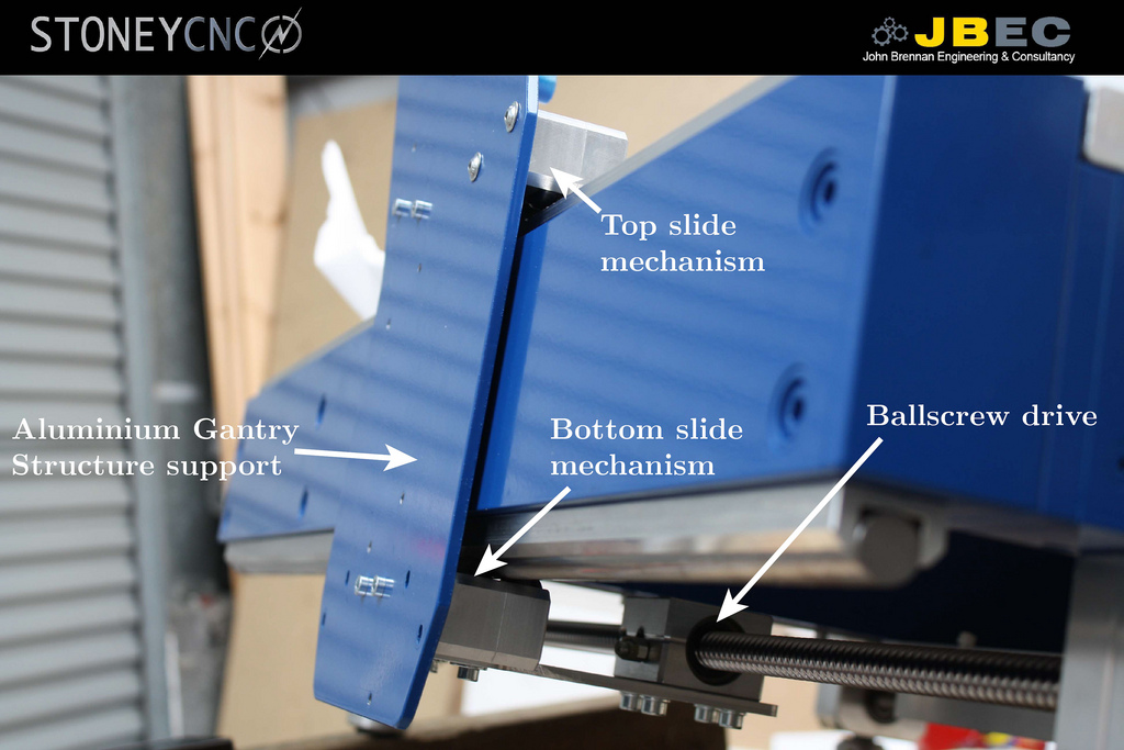

Figure 2. shows the main components of the main drive system used to traverse the main gantry. The design is based on two rails mounted on the opposing faces of the main machine bed frame. Two slide rails, each consisting of two rolling element bearings (discussed further below) sit on the two rails and provide the required stiffness in all directions except the direction of motion where the slide moves freely with minimal friction.
Attachment 9474
Figure 2. Gantry structure design overview
Figure 3 shows the top slide rail mounted and bolted to the main side aluminium panel. A second inside panel covers the assembly shown and increased the torsional stiffness of the frame as it is shown. Shown also is the ballscrew encapsulation at the opposite side to the motor.
Attachment 9475
Figure 3. View of the slide rail mounted on the bed.

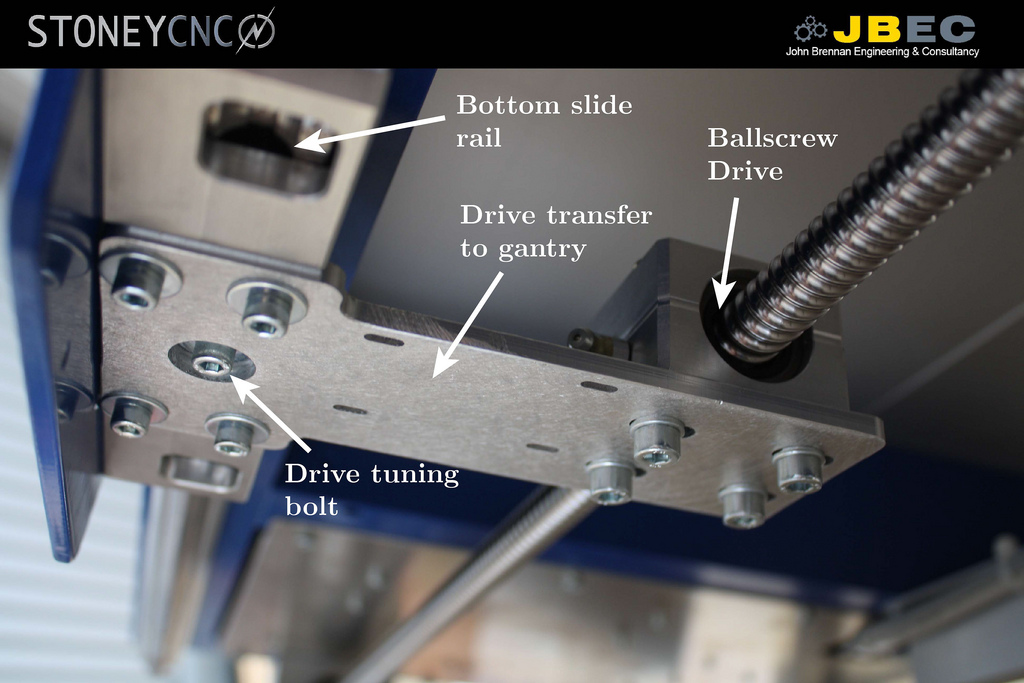

Figure 4, shows the mechanism used to transfer the drive from the ballscrew carriage to the bottom slide rail. Note the 5 bolts in the mouing system connected to the slide rail. The 4 outside bolts fasten the aluminium panel to the slide for the drive transfer. The middle bolt is used to tune the gantry position - and is discussed further below.
Attachment 9476
Figure 4. Bottom rail and drive system assembly

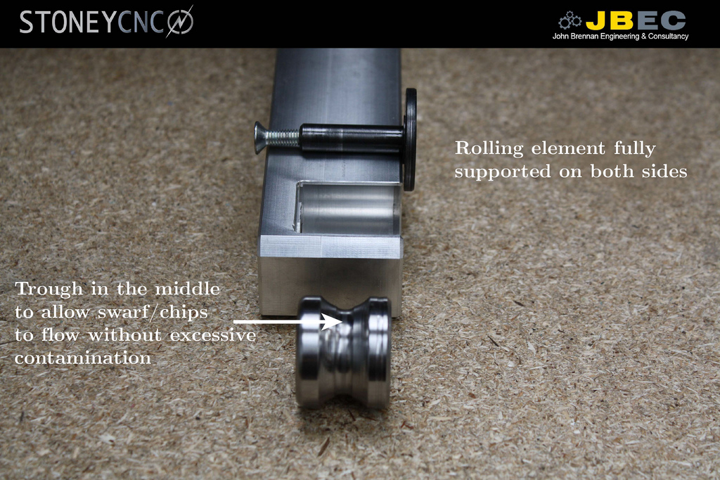

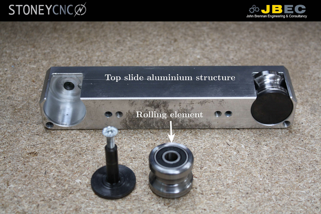

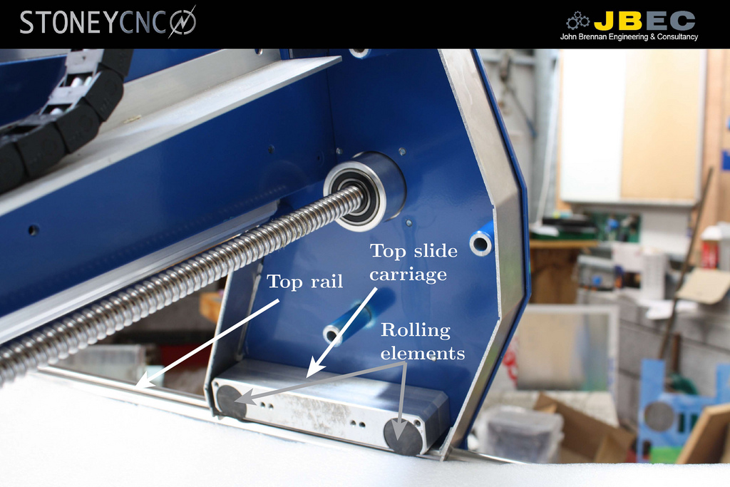

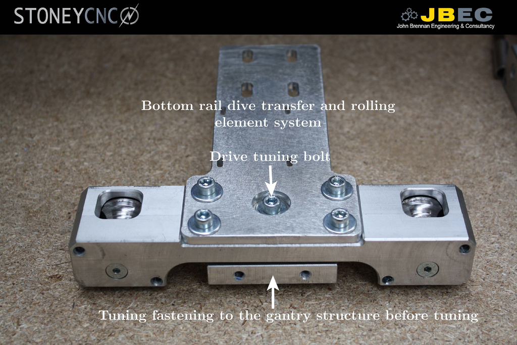

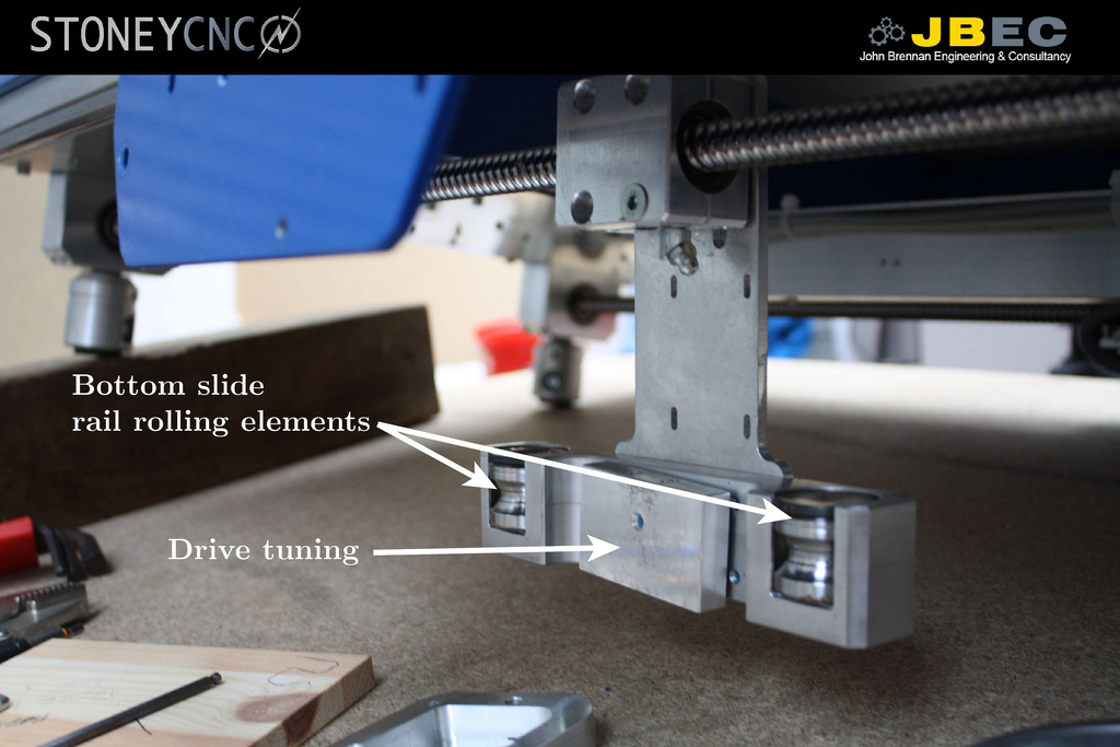

Further to Figures 3 and 4, Figure 5 shows the linear slide disconnected from the slide rail. Shown are the rolling elements used to interface with the slide rail. Note also the tuning block connected with the tuning bolt shown in Figure 4.
Attachment 9477
Figure 5. Image shows the exposed rolling elements
Figures 6(a) and (b) show the linear slides composition with the rolling element shown. The rolling elements are supported on both sides and have two internal bearings. Not also the trough in the rolling element that allows some leeway for swarf and other possible contamination getting into the drive system.
Attachment 9478
Figure 6 (a). Top linear slide rolling elements
Attachment 9479
Figure 6 (b).  Showing how the slide system assembles together.

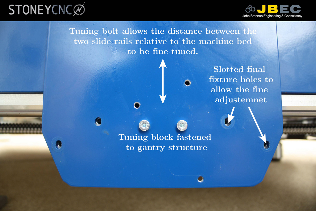

Figure 7(b) shows the gantry side aluminium panel and shows the two bolts fastened to the tuning block as shown in Figure 5 and Figure 7(a). The 4 other holes shown are slotted to allow the tuning bolt to be used to adjust the slide setup. Once tuned and adjusted the holes are fastened and the gantry is ready for final assembly. The system is modular and therefore easy to change, service and tune long term. The result is a very stiff structure that provides excellent support in all directions apart from the direction of motion where linear almost frictionless travel can occur
Attachment 9480
Figure 7 (a). Bottom slide assembly setup
Attachment 9481
Figure 7 (b). Side panel for drive tuning

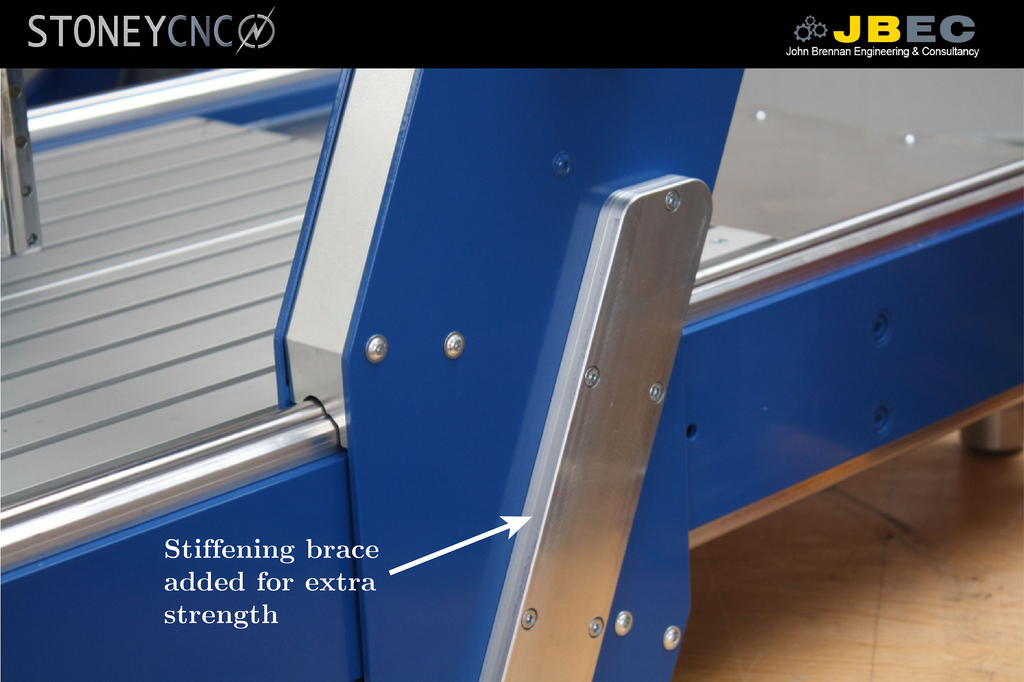

Figure 8 shows the extra aluminium side brace installed to provide extra stiffness through from the ball-screws into the gantry tower.
Attachment 9482
Figure 8. Stiffening plate

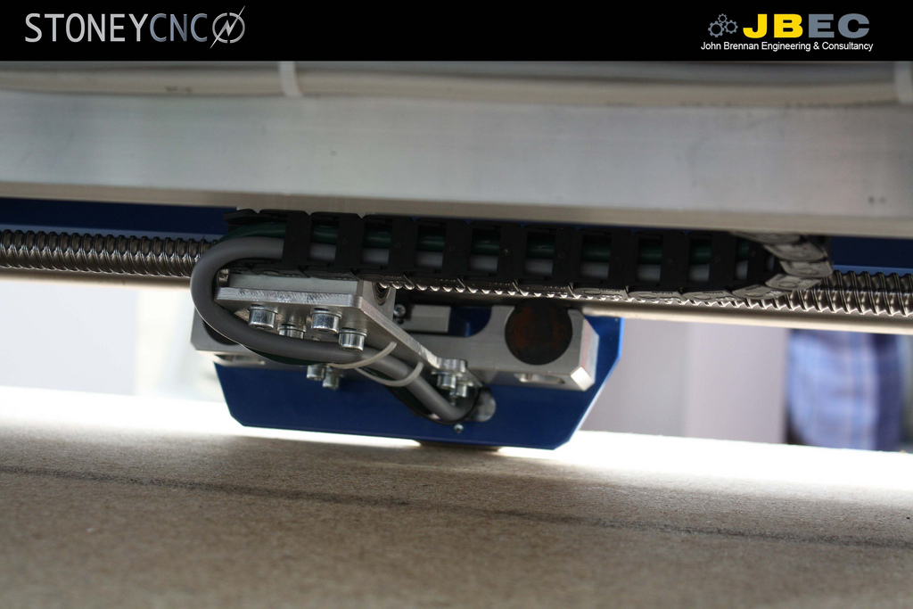

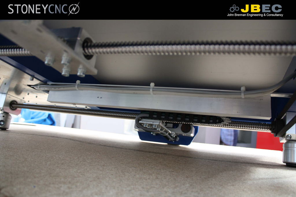

Attachment 9484
Figure 10. Cable management under machine bed
Attachment 9485
Figure 11. Belt drive to the two ballscrew pulleys.

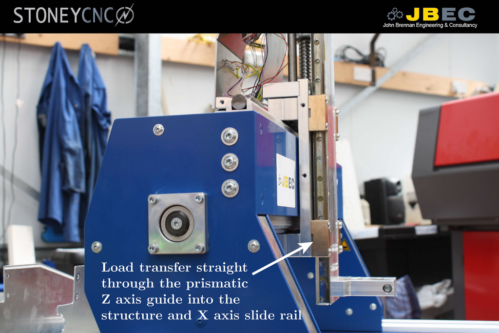

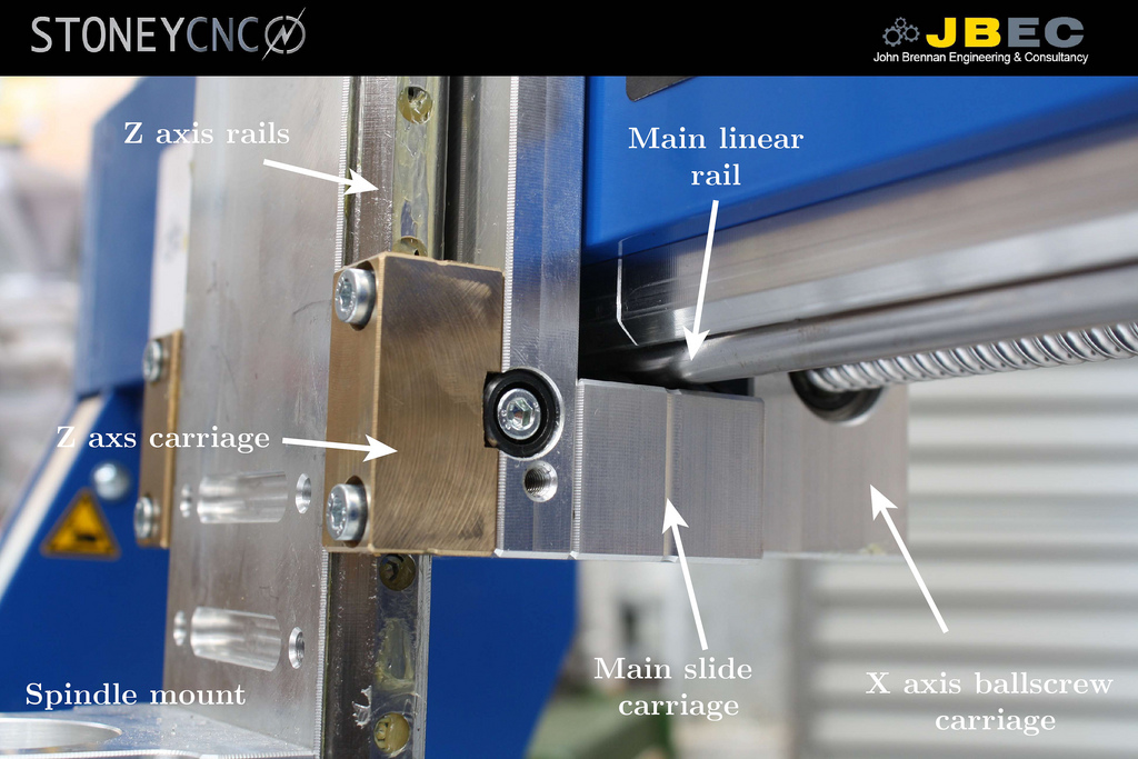

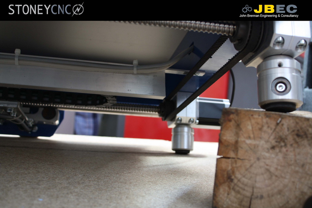

Figure 12 shows an overall view of the Z axis slide and drive mechanism. As shown the upper and lower z axis guides are spaced apart such that they are located in the same locations on the gantry as where the X axis slide mechanism mounts on the main X axis slide rails. This is further illustrated in Figures 13 and 14. Figure 14 shows how the ballscrew drive will transfer force directly at the same location as the main X axis carriage system, and from there directly into the X axis guide system.
Attachment 9486
Figure 12. View of the X axis mechanism fully assembled

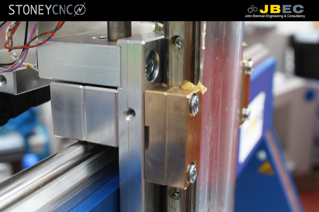

Attachment 9487
Figure 13. Close up of the left hand side upper prismatic guide
Attachment 9491
Figure 14. shows how the process forces are translated into the gantry tower structure.
If ever you are put in front of a CNC router system you are about to part cash with. I would ask every customer to look at this aspect of a machine as it plays a core role in the machine performance. If you grab the spindle structure (not too hard in case you break it before you've bought it :) ) and put some pressure on the structure in all directions and see how it performs. What your doing essentially is simulating a cutting process where you are putting forces on the machine. The level of "play and delfection" will dictate the performance.
You will pull the machine off the table before you bend and flex the gantry structure with any significance on this platform.

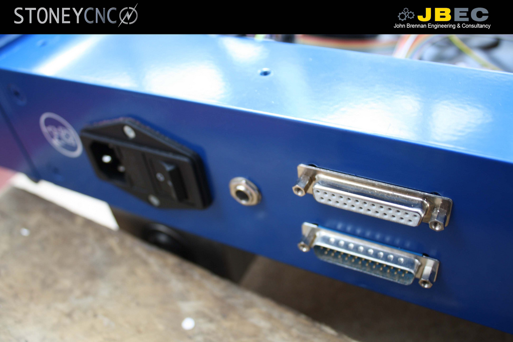

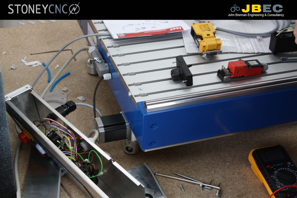

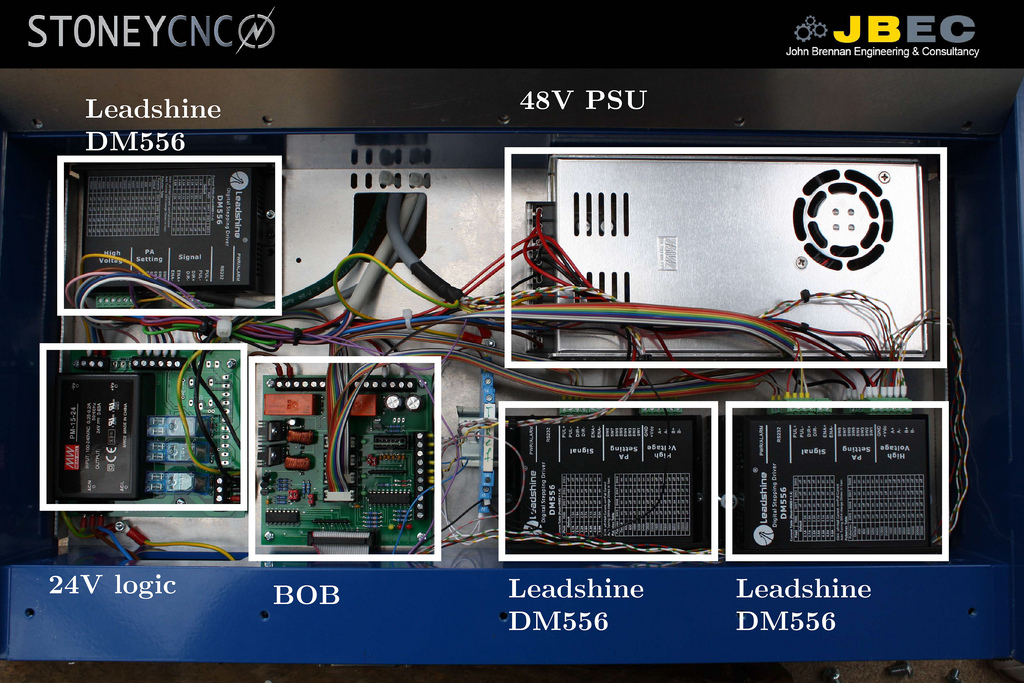

Figures 15 and 16 shows the control electronics. She runs on a 48V PSU matched to the oriental motors specs running each of the three axes. There is a BOB for the LPT logic distribution from the PC side and there is a 12V relay board for the user interface buttons on the machine control panel.  Figure 17 shows the innerds of the machine control panel. The latched start, stop, Estop and spindle on/off override switch are all operating safely on 24V running back to the relay card. 230V AC comes in and up through the machine for the spindle only and does not come through the control panel.
Attachment 9493
Figure 15. System electronics
Attachment 9489
Figure 16. AC in and LPT connection and 4th axis connection.
Attachment 9490
Figure 17. Control panel work

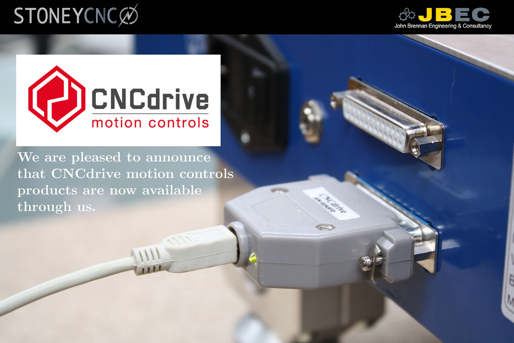

Figure 18 shows our USB controller that we have adopted as standard thanks to CNC drive electronics. We now offer a range of CNC drive electronics with more information coming soon.
Attachment 9492
Figure 18. USB machine control

Oh dear . .  Oh dear  . . .Oh dear what do I Say.?????? . . . . . . No Sorry can't give approval.!!
First let me say not going to pull it apart or condemn because the machine is very well thought out and professionally put together. far far removed from like of strike CNC and some other 'Merchant's' that are dicey.!  . . . I congratulate on the professional way it's done and presented.
What bothers me is the the fact you have what is basicly just a supped up version of skate board bearings coupled with very flimsy gantry sides connected to flimsy ballnut brackets. Now for £5100 for machine and Electrics only, I would expect much more for my money with real profiled linear rails and substantial frame.
With this rail system and weak frame work I foresee that this machine will be very baggy within side 3yrs if worked 8hrs day and will require plenty of maintenance and setting up to keep accurate much after the newness has worn off.!!
Personally for best part of 6k investment with PC, spindle etc I'd want better than this machine provides. That said for Hobby use then it's rail system and IMO weak gantry are fine, It's just far too expensive.!!

		I agree that the ballnut mounts in particular look much too thin, and that for the amount this costs you should be getting proper linear guides not glorified skate bearings.
StoneyCNC
 No. If you clamp an indicator to the bed and touch it against the spindle or Z-axis and try what you suggest you'll see plenty of movement on the dial. I agree you probably wont see the deflection before pulling the machine off the table, but that's besides the point since the tolerances required for a good CNC router are well below the distances anyone can see. Can you see 0.1mm deflection?

			There is a video of me perched on the machined bed. And subsequently on the Gantry. I''m tipping the scales at over 90kg... 90kG is about 880N. no rude comments please... :chargrined:... So that is 90kg going through the surface area of my scruffy shoes in the middle of the machine - and then around the machine a bit. I then stood on the gantry in the middle - somewhat precariously.
 Nice Video not sure of the point has it's mostly meaning less.? . . . It's a CNC machine not a sit on lawn mower.!!
If your going to bother with this stuff then Better IMO to apply some lateral tests simulating real world cutting forces. . . . . Push & pull on the bugger in all directions and lets see how it jiggles.!!

It demonstrates the tower stiffness and that there is no slop/deflection when my 90kg..slim fame puts pressure on the gantry and the slides. It also shows that when you move the load point around the bed does not twist up and deflect. Will look to get other data too.

		In relation to the comments and opinions that have been put up on this thread we have had a meeting with JBEC and the German machine builder and had a discussion. Firstly we would like to be clear on a few key points in this response so that the message is not taken out of context. We would also like to advise the general audience of this forum to be mindful of relativity and comments and opinions that can be taken out of context.
- Profiled rails (THK and HIWIN for example) are the best linear translation system for a CNC application.
 - There is a mine of exceptional information on this forum and the active members go to significant effort to help others and in our opinion are enhancing the CNC community in the UK no end – we commend this – it’s a fantastic resource.
 - We are of the opinion that there is a disconnect on the forum between a commercial CNC system and a full on informed home build. The two approaches in terms of the manufacturer and the end user fall into very different categories. The general jist of what we have read on our, and indeed other posts, is that “nothing is ever perfect”. We would ask the general audience to consider the difference between a home build DIY CNC machine vs a machine that is produced in volume, commissioned with training and supported actively by the supplier. The two scenarios are very different and the perceived “value” needs to be put in context.
 - We approached this forum with the aim to help the CNC community be more productive and to offer our share of experience to those interested or looking for help – as well as to inform of the products we offer. We felt our experience and ability to supply CNC equipment and control products could benefit the community.
 - We are not here to make a quick buck, we believe in our system and our reputation in IRL. We would not be offering and supporting the system in the UK if we did not stand by it.
 - Anyone who feels they have the ability to do a DIY CNC home build should do so and spend the money and get the extra functionality. This extra performance comes at the expense of your own time to make it happen and the inevitable head scratching. If you ever give yourself the opportunity – do it! You’ll not regret it.
 - Those who opt for an off the shelf solution should be given access to a fair and honest information source about the relative performance aspects the CNC systems on offer.

There is no question that the linear profiled rail and carriage system is the highest performing linear mechanism there is for CNC applications – hands down. Linear rails are the only system that can provide load ratings for even the most-high spec CNC applications only allowing motion STICTLY in their desired direction of movement.  However, the tolerance levels demanded of a CNC system using profiled rails is in the order of microns in bed tram and global machine alignment.  This is why when you look under the bonnet of any big commercial machine they will be there.
Typically therefore, linear rails suit machine builds where solid steel or equivalent machine beds are machined with precision to take such a rail system and to realise the accuracy they can provide. Either that or great lengths and effort have to be gone through to make them work on other frame designs. Applying a linear rail does not add the performance of the rail system if it is not backed up by the bed design, precision and stability. Only then can twist and tram be true and give the level of performance that the rails can realise. In order that the performance of such profiled rails can be fully realised depends on the bed design.

The JBEC CNC router series linear slide system went through a full digital mock up (DMU) and was also been mechanically tested and refined in a physical kinematic system analysis.  For intellectual property reasons further details will not be disclosed. On the bigger machines with a different application space profile rails are used. We are working on a bigger machine currently that will indeed adopt profiled rail due to its size and performance parameters and consequently will have a bigger price tag.
Attachment 10040
Attachment 10041
We feel that such severe comments should not be made on the basis of a digital viewing without access to materials, BOM with fits and tolerances. We, JBEC and our German colleagues welcome criticism based on the machine in action and subjected to tests.

We are now an official supplier of Mach3, CNC Drive motion control electronics and of the Fogbuster coolant delivery system.

1. First of all,  lets be clear. Any machine which is not using square supported rails and carriages is pure woodworking machine + plastics and composite materials. Flimsy or superbly  made like your machine, where there are V bearings, U bearings, skate bearings or so, this is a begging for trouble to route aluminum. Like Dean said, its a scratcher. For me even a machine with SBR rails/ round supported/  is a scratcher. So it should not be marketed as aluminium milling machine. Cause i know from my own experience it can do aluminum. A day, a week, even a month. But then starts the joy. What moves, which bearing, how the hell that happened, wow i bought a lemon...
2. Again the bearings. Self cleaning, the dirt will go in through the middle? Let me tell you. Route pine or plastic for a day, even with aspiration and the trouble starts. Hell, that stuff sticks to the steel and the bearings smash it further on themselves and the rail. Cleaning it scratches the rails and bearings, so it stick more and more.
Now the positive: You can incorporate simple cleaning seals so it could not be such a problem.
3. And the bearings again. Mistake. Lets assume your bearings cost you cheap. Say 150 euro per machine. German you say. I will tell you sth- if you dont incorporate something from China you can not make money. Lets look at another angle. Yesterday i ordered from China for a 1400x450x200mm travel machine
Hiwin bearings 20 size, long carriages,780$ . there were other options. Same quality TBI 130$ less, Chinese LG20, even 100$ more less.
In other words, you can do it, cut from some where else, push in other direction and incorporate square rails. Even 15 size, which are cheaper and quite more better than the ones you use. Leave the 20 size as an option for serious buyers or bigger machine.
Bottom line: that could make the machine more expensive with 300-500 euro. I will pay 300-500eur more in a blink just to have square rails even if Chinese and even if 15 size and even if not the long carriages. So it could be done. Even cheaper as you will buy regularly.
4. Yes you guessed. the bearings again, this time also the gantry.
I could not understand why sb who has so much experience and who is actively informing himself in this forum will make a PRO machine, at a PRO price with Flat gantry sides, even if reinforced. Let me tell you. The first bearings that will fail on your machine will be the upper gantry moving bearings that are nearer to you , looking at the front of the machine. Just changed 2 today on my machine, again, so take my word on this.
So the conclusion from these points is that the words Pro, Precision, Aluminum Milling don't go well together with U bearings and so and go well together with square rails. Same with gantry using side plates instead of forming a Profile.
Now to the electronics.
Ok, electronics. But i missed to see here or on the other thread you to mention what are the electronics exactly.
1. What drivers, driven at what voltage with what motors, using what transformer and what BOB?
Not knowledgeable buyers maybe will not care, but if you need our opinion its good to know if you did not hide another lemon there.
2.AC in and LPT connection and 4th axis connection.
:toot: On my machine is exactly the same. And you know what? Beautiful to look at but a big mistake. The connections stay permanently hot glued due to dust, mist and rust problems, which translate in connectivity problems, which translates in frustration.
Solution? A simple L shape cover would be enough . 5cm at least protruding .Or they should go inside a bit, so that could be protected.
Otherwise / but hey, the rails and the gantry are the back bone of any machine/ i like it. Basically what others said. The components for a beastie DIY machine are 2500eur worth. Top components i mean. So with the right decisions, investment, tooling and politics a lower price can be achieved. So a bigger profit but at the same time offering real quality.
