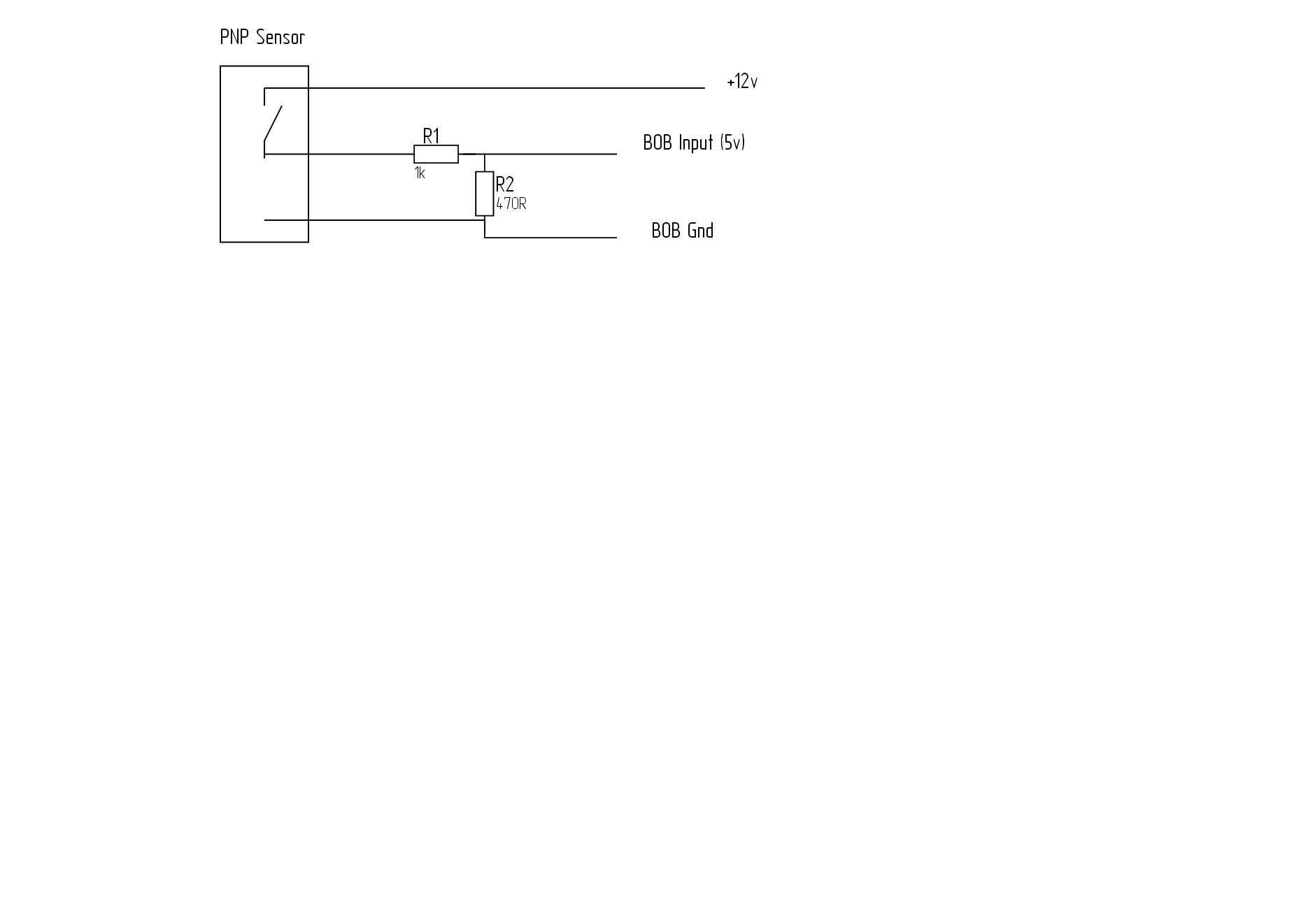

Can someone help me, I am using a PLCM BOB is states 12 V for the switches. I am trying to use PNP type NO 6 to 36 volt proximity sensors.
I have determined that I need to add a resistor to the signal on the BOB.
Can someone help me to determine the size resistor I should used and confirm that PNP types should be connected to the input signal.

That's correct. The issue here is that the sensor output will be open collector, so it can't source current. You therefore have to add a pull-up resistor in. The value isn't critical, I expect something like 4.7k would be fine.
Re: Proximity sensor help required
Careful here... the switch type is PNP, BOBs are generally -ve ground, so its not a pull-up resistor but a load resistor.
The only manual I can find online for the PLCM says inputs are 5v CMOS buffered, no indication of whether opto-isolated or not. What PLCM BOB have you got and where does it say 12v??
Assuming the input is not opto-isolated then need two load resistors in series of 1k and 470R

Thanks everyone for replying, just to recap yes it is a 6 volt to 36 volt switch.
So much conflicting advise, re use of pull up resistor.
yes is PNP type, manual link is here http://www.zappautomation.co.uk/en/a...attachment=165
shows 12 volt on diagram fig 4 limit switches connection.

Ok, the diagram I show is correct but omit R2 and connect the proximity switch output to INx+ and connect INx- to ground. Make the value of R1 anything between 0 (ie a direct connection) and 470R assuming a 12v supply, its not that critical. More than 12v will need higher value. You can use the 12v output from the BOB but then you get no opto-isolation. Do you have any other power supply on the machine side?
Note the proximity switch connection shown in fig4 in the manual is for an NPN switch.

I am using a separate 12 volt power supply.
Thank you for your help I will have to order 470R I have some 1/2 watt 10K and 1.5K resistors.
plasticsales
I'd not bother and connect the sensor direct to INx+ since it already has 1k internally on the BOB.

Done that and works without resistor.
What it does do
Both the leds on sensor and BOB light up when the switch senses.
Mach3 says limit reached and stops motor.
All good
What it does not do is show led on mach3 screen, only a quick flash and the led on the screen does not stay on, is this due to the resistor?
I am getting 0 volt and then 12 volt when switch is activated, will a resistor reduce this voltage to 5 volt and then show in Mach3 screen?
