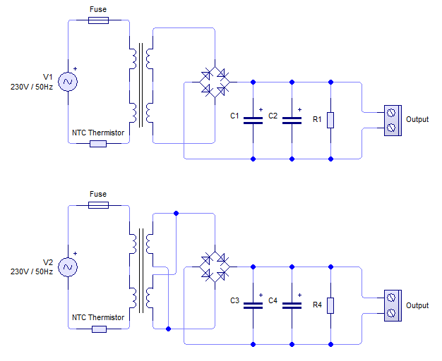

Get the bits sent to me and I'll solder it up for you - it wont take more than 15 minutes. In fact I think I have a spare new 500VA toroidal transformer... 4 motors at 3.5 amps, so you need about 70% of 4*3.5 which is 9.8 amps. 9.8*50V=490VA ... so the transformer I think I have is perfect.
Jonathon, wouldn't it be easier for you to buy the parts, make the PSU and send him a paypal invoice? There seems to be a serious lack of decent quality PSU's on eBay... :thumsup:

That cap you have linked to looks like 63V rating to me used with the transformer that you linked to would that not be a bit low? ... Clive
Sorry, I accidentally linked to the wrong transformer. This is the correct one:
Toroidal Transformer 500va 0 35v 0 35v
It's 35V, so 35*2^0.5-1.1=48.4V approximately, which is fine.

You both have valid points and all the info is out there including the thread I linked to. BUT none of this in the right form for a newbie to electronics at this level. What we need is a properly structured tutorial to help answer the question 'how do I build a linear PSU for x volts' with a 'best practice' design, a schematic and assembly guidelines along with photos of good - and, maybe, bad - examples.
I'm willing to have a stab at the words and there's a good working schematic that I drew in the thread I linked to.
What say you?
I think the point we're making here is that you don't need to be an electrical genius to do this, you just need clear instructions. Therefore we need someone who can explain things clearly, but you have made it apparent that that's not me, so I'll just contribute with this circuit diagram:
Attachment 9780
Two versions depending on whether the transformer secondaries need to be placed in series or parallel to obtain the correct voltage. Two capacitors pictured, but more/less may be needed in some cases. I put in the NTC thermistor for soft start, which is optional for most size transformers in this application. I see no reason to put a fuse on the output since all the drivers I've dismantled (PM752, PM542, DQ860MA, AM882, 2M880N) include their own individual fuses, however it may be sensible to include one in case somebody decides to use the power supply in a different application.
