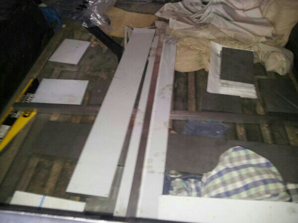

		Just picked up my alloy and damn it's heavy! :)
		2 Attachment(s)
		Re: Jcb's CNC machine Mark 2.
		I've made some slight progress, why do I have to go to work today :(
		Are you just fixing the sawn surfaces together or machining them first? I'd be concerned about fixing sawn edges together...
		no I'm not milling them and I'll probably face the repercussions of it in the way of needing more adjust-ability. I could do it on my current cnc machine, but it'll probably just be more of a pain as I don't know how square the machine is. I just popped it together as the stuff I do on it isn't that accurate.
