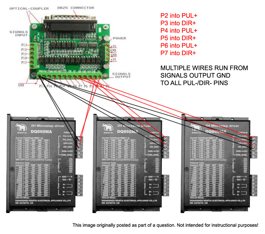

Maybe not the most elegant of solutions, but ive given up with the usb serial controller and plugin. For now it would be just nice to turn the spindle on and off from the pc
Im using one of those cheapy BOB's from china. Which so far does everything I need, and does it well
(thanks to Wal for photo) - photo for illustration purposes of board, not for wiring

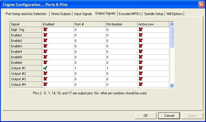

So what im trying to do is simple.
Attachment 9910
but im stumbling at the first hurdle!!! ie just getting the relay to flick
so, in output pins (this is not an actual screenshot of my mach3, but illustrates the screen)
Attachment 9911
I have Output #1, set as Port 1, Pin 17, with Active Low not set

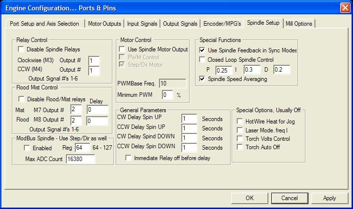

In spindle setup (same window different tab) (again picture not my screenshot for illustration purposes only)
Attachment 9912
in 'Relay Control'
I have set Clockwise (m3) to be pin 1
Im now running commands like M3 s1000 etc expecting to flick the relay and getting NOTHING

It's a simple thing so If you have output 1 to 6 setup with pin 17 then it should work and from what you have posted everything looks correct and it should work.!! . . . So this tells me you either have selected wrong pin on board or pin is knackerd.!! . . . Try different output pin.
Re: just flicking spindle on and off with a relay
I don't know what error checks Mach3 does but I can't imagine it would let you select the same output for Clockwise and CCW, have you tried setting CCW to another spare output ? then M3 should operate output 1

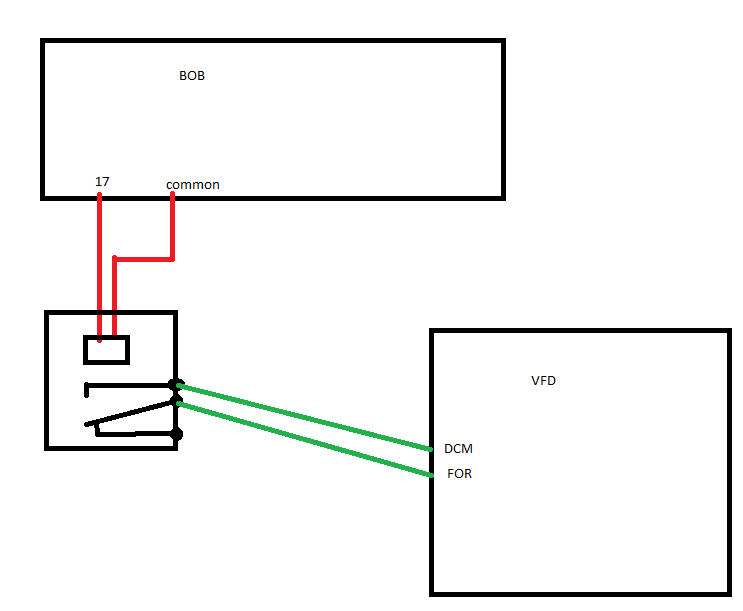

right... Im now able to turn on 5v and turn off 5v to a pin, by running the m3 command etc.. however it seems there is not sufficient power to pull a relay.... therefore... how do I get from the 5v signal... to flicking the spindle vfd on and off?
i assume an opto coupler?
Jonathan
The relay isn't actually necessary - you could just connect the output from the breakout board to the relevant input on the VFD. Just remember to connect the common grounds. Let me know if that's not enough information...
its this bit I need a bit of hand holding on...
As Jonathan said, you need to find the 'Run' input on your VFD. What model is it?
You shouldn't really switch supply volts to a VFD.
kingcreaky
As mentioned above, most VFD's only require a N.O. contact between 2 pins to trigger the start/run signal, so you'll have to use a switching circuit such as a miniature relay or a semiconductor (transistor, etc).
