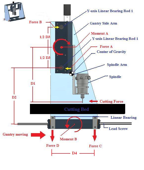

reading this will answer your questions about the forces in play. what you suggest will not work , as you have to decrease moment B and the best way to do it is to increase distance D4.
Attachment 11037
Re: new build opinions required
Hi
Wont be a problem as it will have equaL up forces from the guide underneath
in that drawing, my x would be were moment A is, and were the two yellow arrows are ( d3 ) would be the top and bottom connection to the X Rails.
The Y gantry, will be between the 2 x rails ( above and below ) , putting its COG were moment/force A is. I think i will only need the tool going below the gantry, not the spindle, the aim was always to get the bottom point of the spindle finnishing at the y gantry and bringing any material up to it
At the bottom of that drawing is Force D and Force C, these are are right angles to the rails.
With your proposal these forces would be along the rails, parallel to them and pointing in opposite directions
Eddy - yes exactly, and if i increase the distance of the gap on the bottom rail bearings, that should change the force angle a bit. ( cutting force ).
Also, the rails can run on the top of x, and the side of x, if its to hard to get the bottom level to the top. The intention being, the second rail would absorb some of the stress, and the ammount of extra stress relief should be proportional to the allowable gantry weight reduction.
If it will work this way, i can loose loads of weight from the gantry but maintain its rigidity. I still think there must be something am not seeing,

Yes, yes, they will change direction/the forces. But... on a typical router the bearings that move the gantry are spaced 260-300mm/including, if rectangular supported/. On a heavy duty, like my current build for example, they will be spaced 400mm and above. So you have to space them obviously. What you are not taking into account is the overall height of that and the gantry and what i am speaking of is RESONANCE. It will resonate like crazy cause the forces of the tool and the assembly will be in paralel lines. Something like this resonator , where one fork will be the tool and its plate and the other the gantry assembly
Attachment 11038
there are some other forces which you don't take into effect- inertia and gravitation. Which are not problem in normal L shape gantry.
Just imagine a tank speeding on its noze vertically, when it has to stop. Tanks are low and long. Thats what best sturdy gantry design is.
While gravity and long L take care of the balance spreading it over the bearing blocks, the non achievable balance will f^^^ck what you propose. Vertical tank on its nose, it doesn't matter that it will be supported in the middle. if not that, then the resonance.

Unfortunately George I was meaning it was a bad thing that the forces were parallel along the rails unless you have 2 bearings on the top and 2 on the bottom but that would be overkill.
Unless your drawing, when you post it, makes it clearer.
hi eddy, yes i am going for 2 bearings per rail, 4 bearings per X side, and when i ment spacing them out, earlier, its the gap between the bearings per rail, not the rails themselves ( top bottom ) .
I think that overdoing it on the bearings and rails, will allow me to make the gantry lighter, and a stable box, If i can get the gantry lighter, i dont have to worry about inertia , am also thinking that, in might want to be able temporarily add weight to the Gantry for some jobs, like surfacing stone,
I did go down the heavy road at first, and gantry weight, can cause as many problems as it solves, every time i work on the calculations with heavy gantry, am hitting performance limits on bearings, then bar, way before the machine design going to hit any problems. Then when you look at the costs of baeringfs an rails that will perform ok with the weight, ooooaaaarrr , then, when your bearings and rail can take it, your machine may need supporting. chicken and egg game.
whereas, the more rigid the Y, the less weight it needs to be stable
George,
To avoid chicken egg problem, why not start from the Z. Usually the weakest spot on any machine. THEN this will command the gantry design. Or you have it clear there?
George, I forgot you were cutting stone so maybe 4 bearings per side is not overkill, my mind is currently filled with routers for wood :hopelessness: Will wait for drawing.
Hi
silyavski
i started with the plan that the z should be able to handle different spindles+additions, without differing what forces it can handle in both +-xy. most of the moving gantry designs, like the one you linked to, favour one direction down X, and rely on weight of the garntry to offset the stability looses you get by having to mount the spindle forword of the Y, on the drawing you link to, every mm forword the z mech is away from Y, the force you can apply at the bit tip drops substantialy, and would be different X+ than X-.
so, the problem/limit for z, when considering deflections , is all in the Y, when you factor in a 4th axis, again the differing forces between X+ and X-, start loosing accuracy , the longer the jobs running, the worse it gets, the bigger the job is down the x axis, the faster this will happen. .
but, if you have 2 of them Y axis you linked to, facing each other, and the Z in the center, Zs force is equal on X+- and Y+-. the forces Y can take, could be ajusted by spacing th 2 bearings per rail further apart
then, Z drop, is the next place you start looking at, will try and get it in sckechup tomorrow, failing that, i will take a photo of my drawings and post that:moon:
