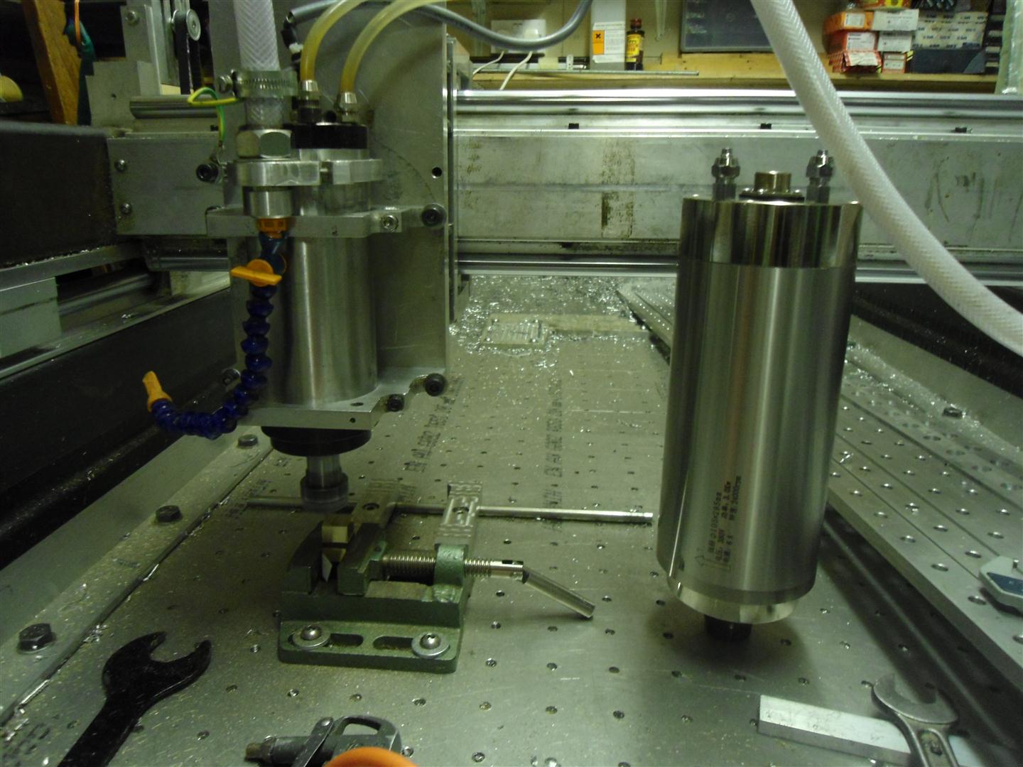

As you probably guessed, the reason I spoke in the youtube video you linked to was so that you could set the volume so that I'm speaking at a normal volume, and judge the noise from the spindle accordingly.
I doubt the spindle from amazon will be quiet as it has a fan on the end, so there will be noise created by the airflow. This is unnecessary when you can quietly water cool it. Don't be afraid of the water cooling - it can be simple and easy.
If you go for one of the better quality (and much more expensive) water cooled spindles, I'm pretty confident you'll find it's a lot quieter than the standard 2.2kW ones. The one I used here is that type, and I recently obtained a 3kW one on eBay for the right price which is even quieter:
Attachment 10022
Admittely it's a bit on the large size for your machine, but I expect the 0.8kW one isn't going to be worse. Also you'll get much lower runout (a few micrometers) with these spindles, which could be an advantage if you're cutting a particularly detailed PCB. I can post a video with them both switched on one at a time if you want to compare?

In my first post when I talked about getting the higher quality version of the 800W spindle to reduce noise (among other things), I didn't realise that you already had a spindle. I've made the video comparing the two spindles I have to hand:
http://www.youtube.com/watch?v=NH_w2...ature=youtu.be
Again, the video makes it sound worse - in reality the 3kW spindle is so quiet that you could almost forget that it's switched on.
Re: 800w spindle - noise & controlling remotely
Thanks Jonathan...quite a difference - even with the 3kw spindle lying on a large flat table (which will possibly 'amplify' the spindle's sound/vibrations ....just like a soundbox on an acoustic guitar).
The smaller spindle sounds quite loud to my ears...but again, that might be a trick of the camera mic.
(btw your audio in that youtube video drops out completely at approx 4m16s)

So I've just hooked up my new VFD to my 800W spindle - the VFD is tripping outwith an overload condition.
I'm figuring it's likely to be the spindle becuase it's of unknown status. I bought the CNC machine in a "needs putting back together" condition ...with a VFD missing. I'm now assuming that a spindle fault perhaps took out the original VFD?
I'm controlling the spindle speed manually with a 10k pot that I've connected up to the VFD, I can get the spindle to turn very, very slowly (without tripping) with the pot at its lowest speed setting but if I turn the pot just a degree or two the VFD goes into an error condition 'overload'....I've checked the VFD settings for tripping out (they're all at default...and nothing seems untoward there)
I don't suppose it's easy to test these water cooled spindles? (I'm seeing just a couple of ohms between pins ...also when the spindle is turning even ridiculously slow, the spindle outer chassis gets warm (not ouch warm, but warm...which is surprising bearing in mind it's turning very slowly ....like 60RPM or so)
Any ideas?
