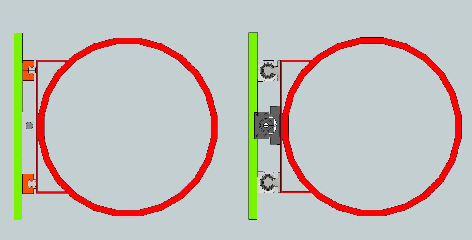

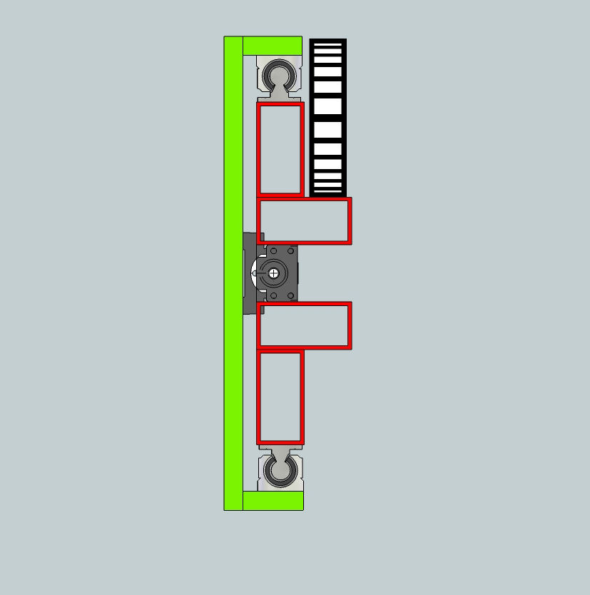

		Please review this router gantry idea
		This is not a build log, I'm just wanting to know if this design is any good. I've read that the L shaped gantry is good but it tends to put the ballscrew too far back so this is a double L shape made from aluminium box section with the ballscrew mounted centrally. The black & white object is the energy chain, sizes of the box sections are probably not correct yet.
Attachment 10021
Re: Please review this router gantry idea
		I no expert but all the strength seems to be in the centre of the gantry, yet your rails are top and bottom the weakest points.
I may be wrong though.
Jim
		Yes I see what you mean, there will be end plates so I'm expecting these to resist any twisting, there will also be blocks mounted on the end plates behind the ballscrew to support the horizontal box sections.
		Don't let the ball-screw being slightly further back put you off the L design.!!. . . In reality it makes very little difference it works fine and makes for a very good stiff gantry. It also very neat and keeps screw out of arms way and makes cable management easy.
Your design would be too tall making for a weaker design.

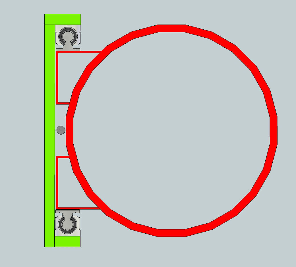

		Jazz, thanks for that, I'd read you mentioned this before and obviously Matt's machine works well.
So before I set off down the L design how about this one ? pipe + 2 bits of channel
I'm also thinking that any hollow material could be filled with builders expanding foam to act as damping as it's very lightweight.
Attachment 10023
		Your tube design would be hard to fabricate, particularly when it comes to getting the rail mounting surfaces parallel. However it would be exceptionally strong as a tube is the strongest shape in torsion.
To make it easier to make you could put the rails on the front flat surfaces, as they could be machined or leveled with epoxy. If you did this you'd want to use profile rails to reduce the overhang.

		mekanik, it makes sense but I think I am over exaggerating the pipe diameter, perhaps Jonathan could advise on what would be required for a gantry say 1m wide ( I am only intending to go 600m cutting width.)
Maybe this, I'm thinking the brackets would need to be welded onto the pipe to prevent crushing and slipping.

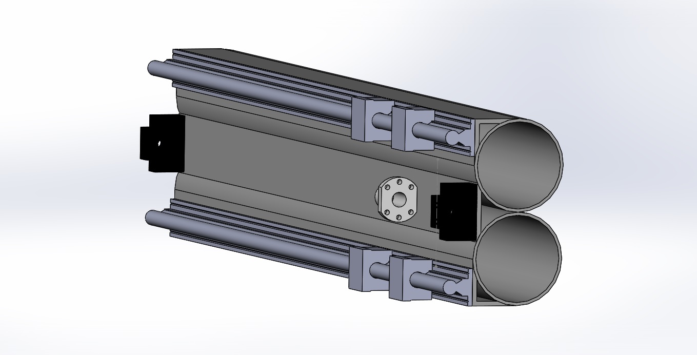

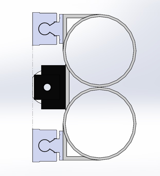

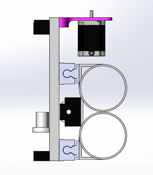

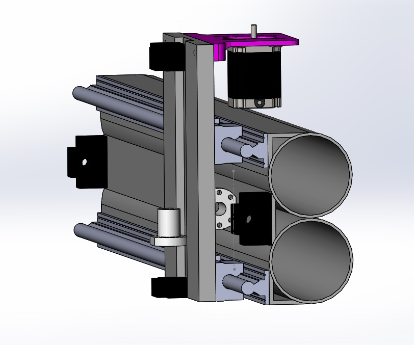

 Yes it would work and tube is very stiff. But large tube is expensive and will resonate quite a bit.!!  How about something like this.? It will probably be cheaper and stiffer with 2 x 100mm tubes
Attachment 10026Attachment 10027Attachment 10028Attachment 10029
		Would the two tubes try to rotate about each other ? they would need to be connected somehow, it seems the basic strength of one tube has been lost maybe, but you are right that large tube might be expensive unless of course a scrap yard had something.
That gantry you've drawn would be pretty lightweight I imagine.
		They are connected with the plate in centre that bearings fasten too and they would obviously be fastened at the ends into gantry sides. This was a quick mock up for you to visualise and obviously you'd strengthen has seemed appropriate.
To me there's no point wasting time drawing anything if your not working to dimensions you know are available. Those 2 tubes are standard dimensions for off the shelf steel 100 x 3.2mm. Rest like angle and flat plate is again off the shelf.
I've not done any bending or testing calcs but I'm sure combined strength of 2 tubes will be better than one large tube unless it's wall thickness is much greater.?

		Jazz, sorry didn't see central plate but I have now. Is this a design you have considered before ? how does it rate compared to other designs ?
		No, one tube will be much stronger. Second moment of area (J) is proportional to radius to the power 4. The deflection is inversely proportional to J, so this means that for instance one 200mm tube would deflect around 16 times less than a single 100mm tube. The big advantage with a single tube is it's the strongest shape in torsion, so if using two I'd make them rectangular/square section as the forces are now mainly bending not torsional.
So you can't really go wrong if you use a big tube. The same principles apply to box section...
http://www.mycncuk.com/forums/linear...alculator.html

		I knocked this together just to show you but yes I've used tube before on a plasma machine.
So Yes I wouldn't hesitate using it router and it would be easy enough to make and very strong.
Like Jonathan suggested I'd either machine the rail surfaces or epoxy them. I'm big fan of epoxy levelling and use it all the time has it's easy for large surfaces and plenty accurate enough for DIY machine.
Weld the plates on, stitch the tubes together then epoxy and you'll have a very stiff gantry with nice flat rail surfaces.
Again like Jonathan I wouldn't use round rail, mainly because I think they are rubbish and secondly they are rubbish.!! Profiled rails make into much better and stronger machine, accurate.
Jonathan
 I was thinking more in terms of a complete gantry assembly not just the tube and more regards bending not twisting.!
Not got time or inclination to fully draw both and test but I reckon it would be very close and really either would be plenty good enough for routing hard wood.
I also naturally think in terms of what's easily available at sensible prices and 100mm tube will be easy got and cheap 200mm + will be hard and expensive to find.!!

		I agree both designs could be made strong enough, but the basic formulas imply that you can make it stronger with less material if just one tube is used. It's just a matter now of looking at what material is available, and seeing which design ends up with the best strength per pound (or lb!) ratio.

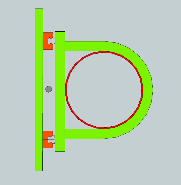

		I've got to grips with the spreadsheet now and I'm tending to return to the L gantry but I'm trying various combinations of sizes to find the optimum strength/weigh/cost ratio although cost is secondary but still important.
		After that trip into outer space I'm back on earth and it looks like the L gantry is going to be the way forward. You would think I was building an electron microscope, it's only going to have a bed 900x600 but I realise it has to be stiff. Currently drawing up the whole machine for comments but getting the Z axis right might take a day or 2 as I want to keep overhang to a minimum.
EddyCurrent
 Wise Choice, really couldn't under stand the need to re-invent the wheel.? . . . KIS approach is all that's needed for wood router. Better investing your efforts into quality components than wasting time and money trying new approach when proven designs work fine.
