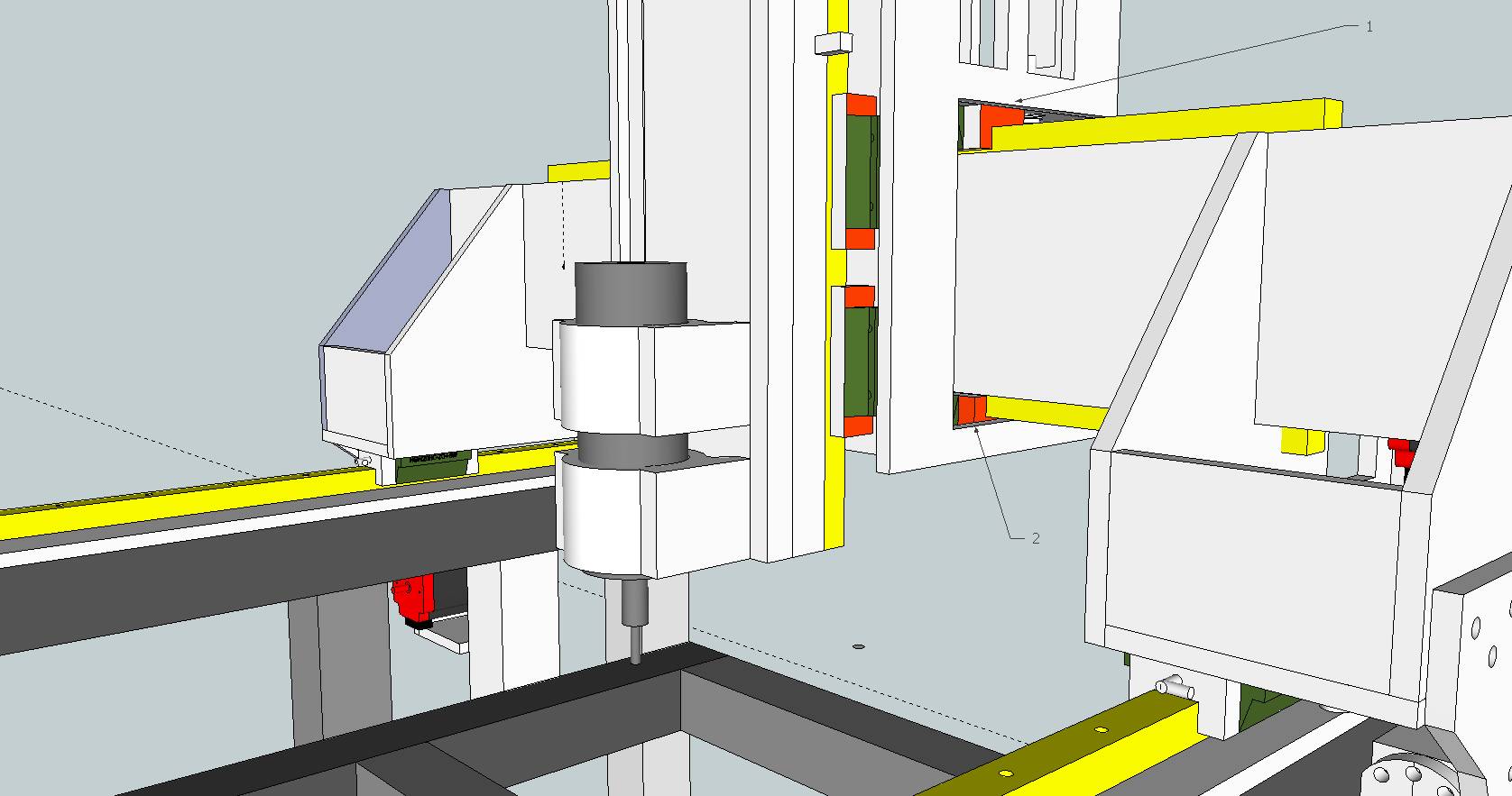

I was interested in the straight edge, for checking the gantry profile after welding. And as i have nowhere to machine it and havent found around where to do it, i was contemplating checking and filing until is flat. i believe its called " elbow grease " in English.
My idea also was to do the same with Bosch profile i have, as its quite straight. The small triangles i bought as i needed sth really straight as a starting point for all projects.
maybe i am wrong, but how to make a precision machine if i don't have a straight ruler to draw straight line?
Apart from parallel i would like the Y rails / the long ones/ to be straight, not just following each other curvature. Any other way to do this with simple tools like a Bosch profile?

Look at the gantry picture bellow. Using the straight edge or epoxy , like for the long rails, i could flatten the upper side/1/
But then how to flatten the opposite side? I don't have a fixed gravity epoxy formed horizontal surface at home. If it was my proper house, i would have done it long ago. So just flipping sides and pouring epoxy would be simple. So i thought of connecting the 2 angle finders un U like shape so i can measure distance and parallelism bots sides. So using the epoxy leveled top or bottom as a reference i could file , sand and so on, the other side. if they were on one plane , it would be easier, but damned overhang...i don't like it.

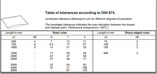

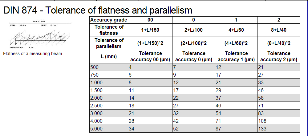

10. It seems the magic word that i needed to find is din 874
But what DIN 874 /00 874/1 874/2 mean?
Attachment 10049
Attachment 10050
So now knowing the magic word./ for EU i mean/ it seems DIN 874/00 on ebay made in Germany can be found at short lengths quite cheap. Longer than 500 become prohibitively expensive.
But hey, i am happy with Din 874/2 . 33 micrometers = 0.033 millimeters / on the entire length.
So now i am contemplating which length exactly, 1200mm or 1500mm, which would be easier to handle. Or maybe even 1 meter. Made in Germany-I like that. Cheap, i like that also.
Example/ from very nice page with all kinds of stuff :
Straight Edges Steel DIN 874/2 Z032021000
lenght 1000 mm, height 40 mm, width 8 mm, Accuracy in accordance with DIN 874/2 lenght 1000 mm, hei...
Price without Tax: 63,65 EUR Price incl. Tax: 75,74 EUR

Just discovered on the page of the DIN 874 straight edges, that there is another page. Its called: Straight Edges made from Steel, no DIN, Testing Accuracy in Item Description, Faces grounded, Length from 500 mm to 6000 mm. Here are the even cheaper " scrap like" :-) edges. Scrap for them, treasure to me.
Example:
enght 2000 mm, height 40 mm, width 8 mm
finely ground,
Tolerance flatness: 112 µm,
Net- weigth: 4,8 kg
Made in Germany
Price without Tax: 114,50 EUR
Price incl. Tax: 136,26 EUR
So 112 micrometers =0.112 millimeters, and thats for 2 meters. Not bad for 136 euro. If i make a big build i will definitely buy one similar

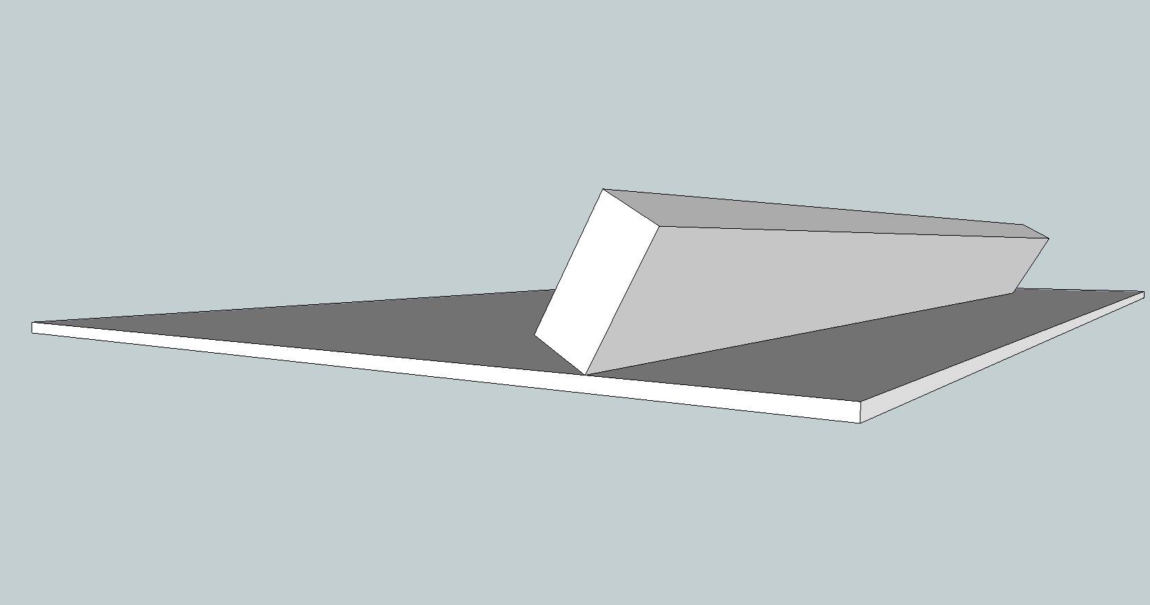

If I'm reading you correctly you mean this;
Attachment 10053
But if you angle the straight edge on the left it will bend and not be straight any more.

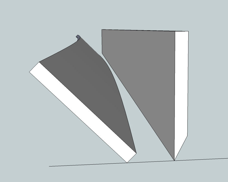

maybe you misunderstood me because of my English. I meant there are 2 types, beveled/like a knife/ and ones that look like bar. So as far i understood, you said that the beveled is better, cause you can see easier the light, when touching some surface to be measured.
So what i believe, the square could be more useful for me, constructing a cnc, because it has 4 edges versus one of the beveled.

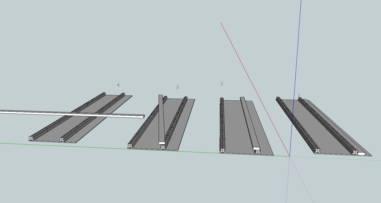

Attachment 10055
First it can serve as a master guide to straighten the first square shaft supported rail when mounting on the red axis, fig 1 , so its true straight
Then check the straightness on blue axis, fig2 /hence proper tightening on hopefully straight surface or if not-if properly shimmed.
Then check twist/ green axis/ fig 3 and 4.
With a beveled edge i don't see how you can perform and alight twist, as many of the beveled edges i saw are straight only at the knife beveled blade. fig 2 is where the beveled edge shines, but if i simply flip and use one corner, its the same.
Attachment 10057
PS: edited, axis not showing

I've got both and the bevelled edge is far more versatile and the one used most.
You cannot angle the straight edge like you show because your straight reference edge is lost because it's bending and will just follow the curvature of the surface. The reference edge is only meant to be used in one direction and must be 90deg to surface your checking any tilt/bend and error is introduced.

-Wood box i will do. But how you keep it in the wood box? Horizontal? And if horizontal, laying on its thin side or its flat side? Cause i will make the wood box if it comes without any

All our straight edges in the stores where i used to work (VSEL)were laid horizontal on dexion shelving, so not flat by any means. so yes lay it on its flat side. The only problem i can see is in the shipping of your precision gauge if it is not already in a substantial box.

So after spending so much time contemplating, FYI here are the best 3 choices I found in Europe,
considering price, type of metal, thickness and height and first of all certified precision and usefulness. Forget the list from before!
Ignored are all shady no brand, rebranded Chinese and similar of unknown origin and non answering for specifications, in other words- trappy ones. Ignored are the mild steel ones which are beveled and the expensive ones
1. Veritas square aluminum straight edge 36" and 48"
Probably the best combination of price, precision and weight. Read a review on the net with precision test, it stands better accuracy than stated
2. Helios-Preisser / made in Germany/ square straight edge DIN 874/2 1000mm / 66 euro with shipping
The one i bought for now. Best price for what it is. Catalog with prices in English
Can be bought from here
I guess i have to live for now with 33microns inaccuracy :beer:
3. Messwelt / Made in Germany beveled knife straight edge. Din 874/0 1000mm 197 euro
This one rocks!
In the catalog the price is 340 euro but on their web the price is 197euro which is great, in fact unbeatable by any other, for a darkened, hardened, ground and lapped made from tool steel knife beveled edge.
Note on their web in the english version is a mistake stating 700mm, when change to German is 1000mm, its at the bottom of the page .
That would be my next edge. I did not went for the other beveled edges as they were mild steel and the cheapest cost 150 euro with shipping. And that one comes with a box.
I hope that will help some body who needs one.

Just received the 2. Helios-Preisser / made in Germany/ square straight edge DIN 874/2 1000mm / 66 euro with shipping. I am impressed. Perfectly ground and polished with no marks, katana -like. Great deal. Came just with cardboard case but well protected in big cardboard box. I could not be more happy, especially for the money i spend and the quality i received. Made in Germany + Din 874= good choice. I am quite happy i spend so much time making a choice and did not rush to the shady ones. thats all for now. Hope that all this experience will convince DIY guys that its worth spending some money on precise instruments that don't cost arm and leg.
