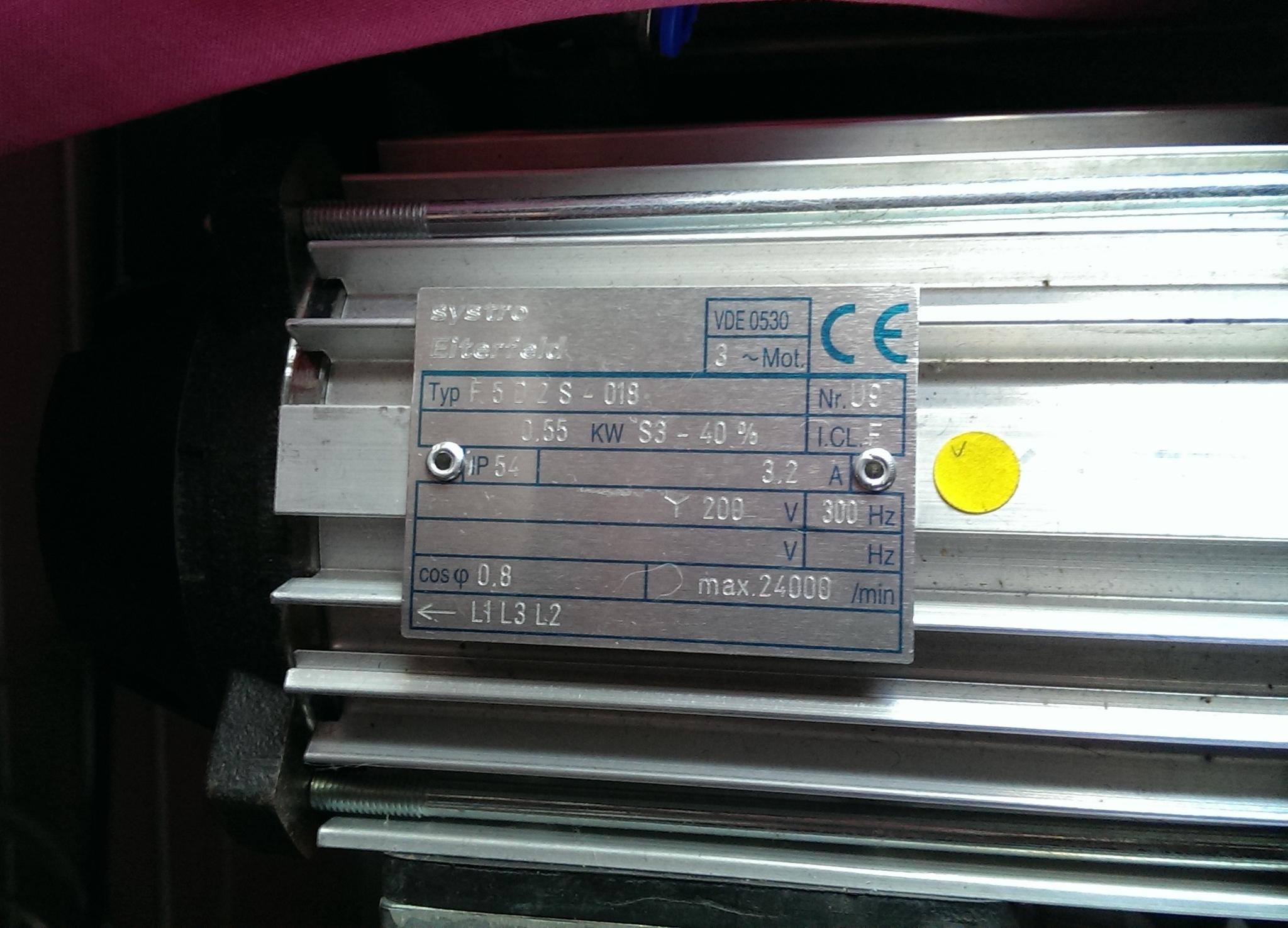

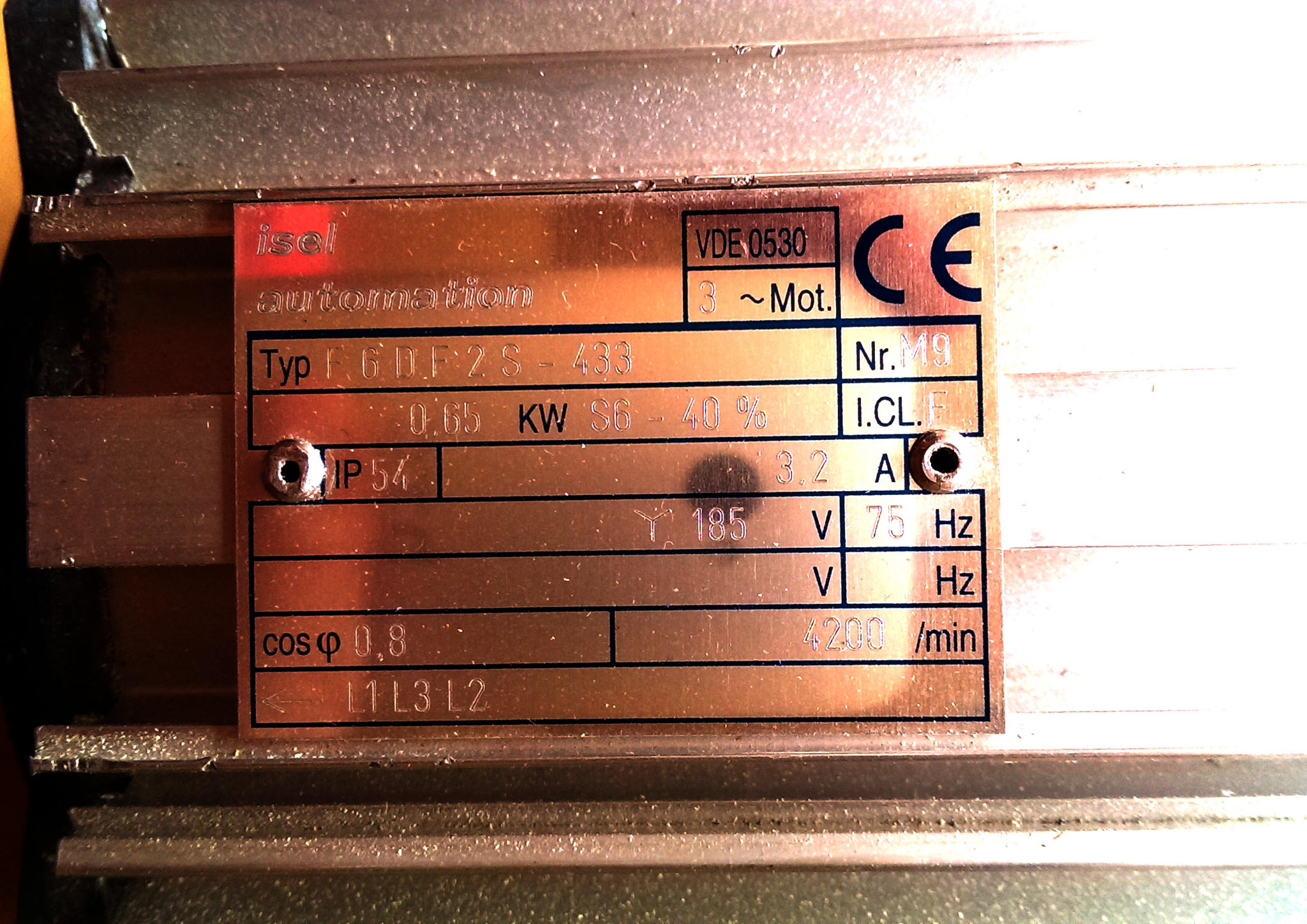

I could do with some advice on the next phase in my quest to reinstate the ISEL CNC machines - the spindles. Without going into all the details - I bought a job lot of equipment, some of it works, some have needed work and all of it has needed a lot of research. So, the problem. . . . . .

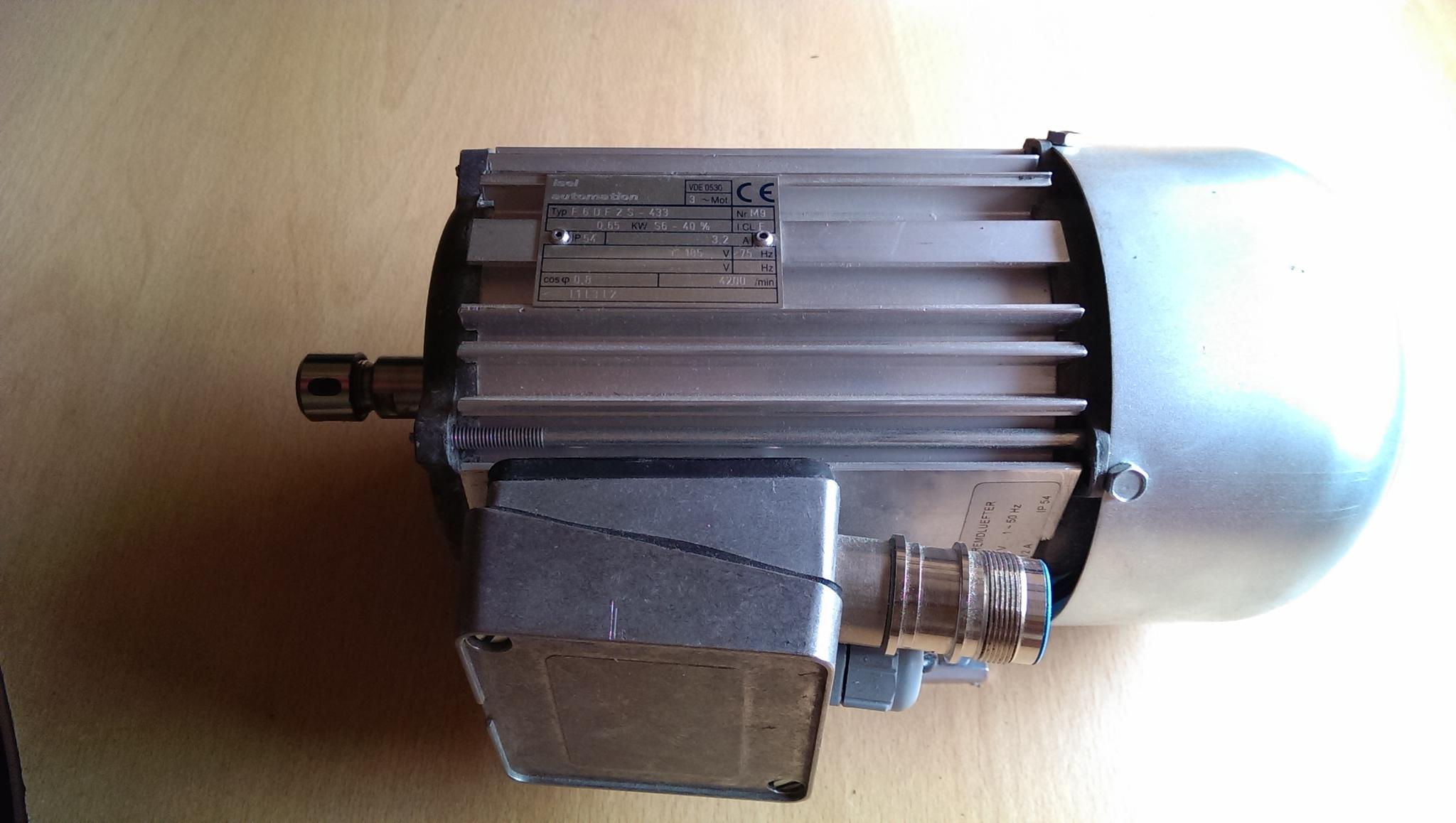

Attached are two plaques which can be found on the two spindles in question. Here is a picture of one so that you don't have to imagine.
Attachment 10121
Attachment 10119
This one:
4200 rpm
75hz
0.65kw
Attachment 10122
This one :
24000 rpm
300hz
0.55 kw
Attachment 10120

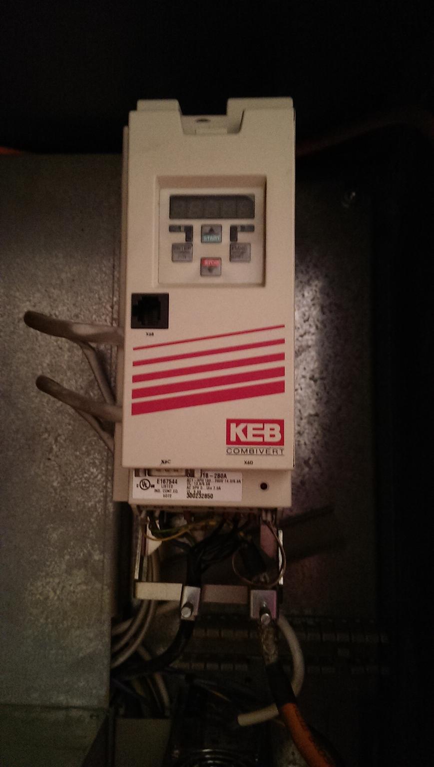

The latter spindle works great with this KEB F5 1.5kw inverter - so I can only assume that it was the intended inverter for the spindle and was separated at some point.
So, the first one needs an inverter.  Based on the information above and in each image, can you advise on an appropriate inverter for the job?  Is it as simple as getting a 1.5kw inverter  from ebay (based on the motor's KW rating being slightly more than the other motor) or have a grossly underestimated the situation!!
Any input would be greatly appreciated.
Chris

		Rather annoyingly, the unit has been customised by ISEL and therefore the menu structure is not is non-standard and differs from the manual.  KEB have no record of how it has been customised and ISEL germany are pretty useless in responding to any email that does not end up with them making some money.
I am considering buying another (£441) from KEB - but I am tight and would like a cheaper alternative!\
EDIT:  I don't think it has profiles either so switching between machines could be a mission.

  It's not that the inverter is modified and can't be used, it is the menus that have been modified. I can't decipher what values do what and therefore can't modify to suit other spindles.
For example, I have found the frequency max (I think) but can't be sure which is frequency min. There are also brake settings (deceleration) but no idea which it might be.
I have spoken to KEB who told me that it was custom, and ISEL haven't responded to my enquiry. Annoying - but at least it is running one of my motors.

 Careful here you can easily wipe the settings back to default or if doing a firmware update screw things up. Before messing Make sure you Wright down all the relevant settings.!!
		Re: Advice on spindle inverter spec
JAZZCNC
 Already done, I created a document to explain the differences and communicate the values in my inverter to the KEN rep.

		Just get an inverter based on motor current and voltage and the input voltage you require e.g. 240v single phase. I have found these people very good
AC Inverter Drives (230V) (Page 1 of 43)
The motors shown are slightly odd in that they are 200v and 185v when connected in 'star' as shown on the rating plate, normally a motor would be 230v when connected in 'delta' and 415v in 'star'.
Obviously these are bespoke motors.
