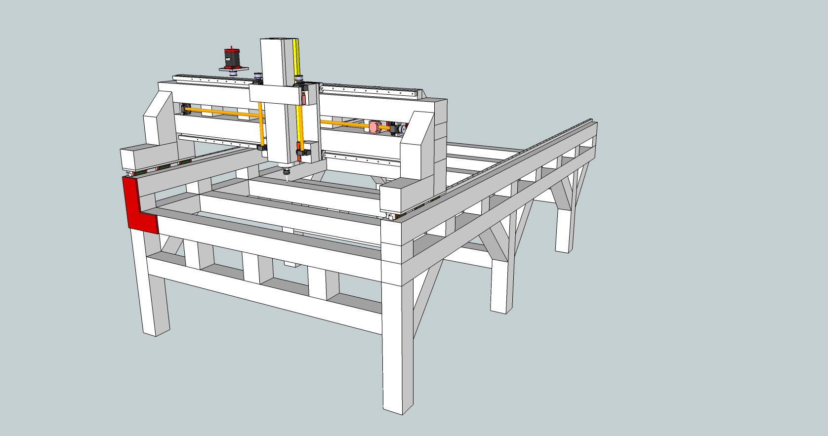

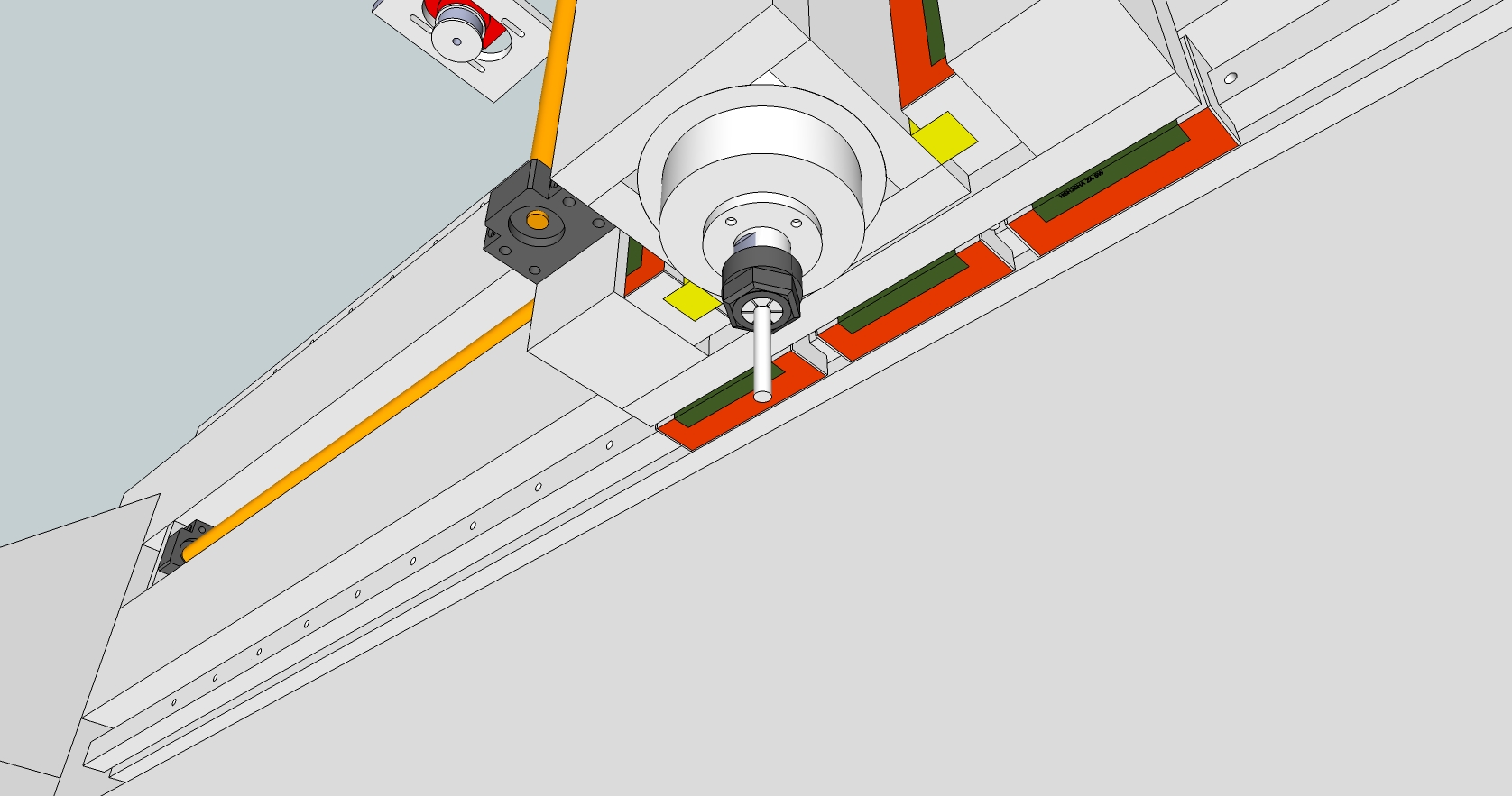

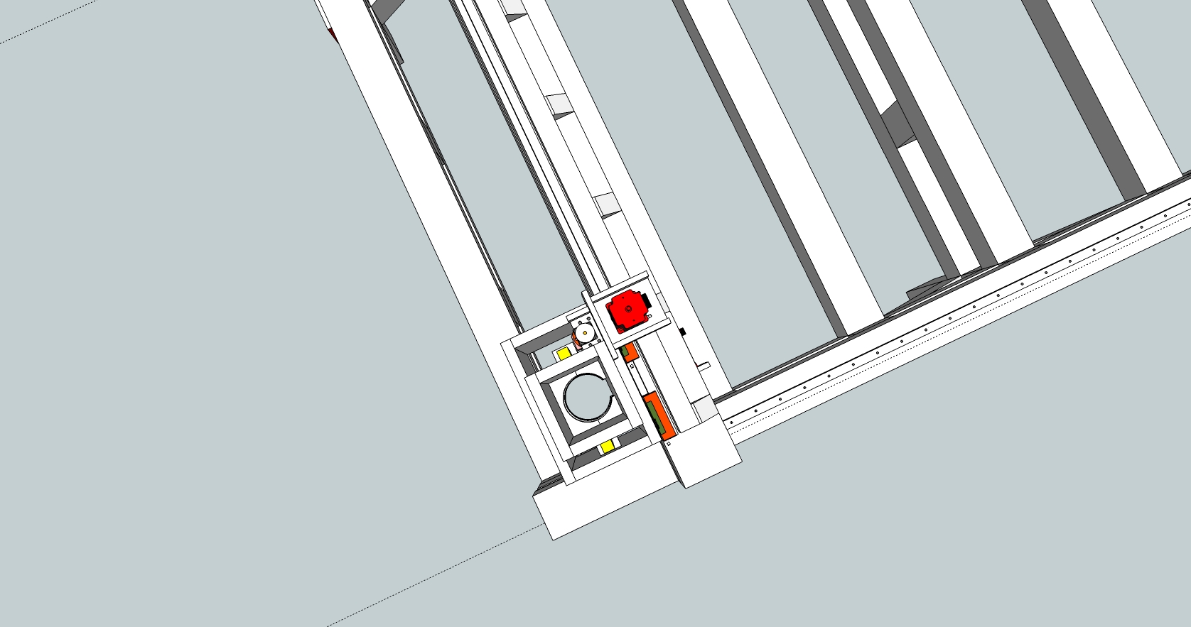

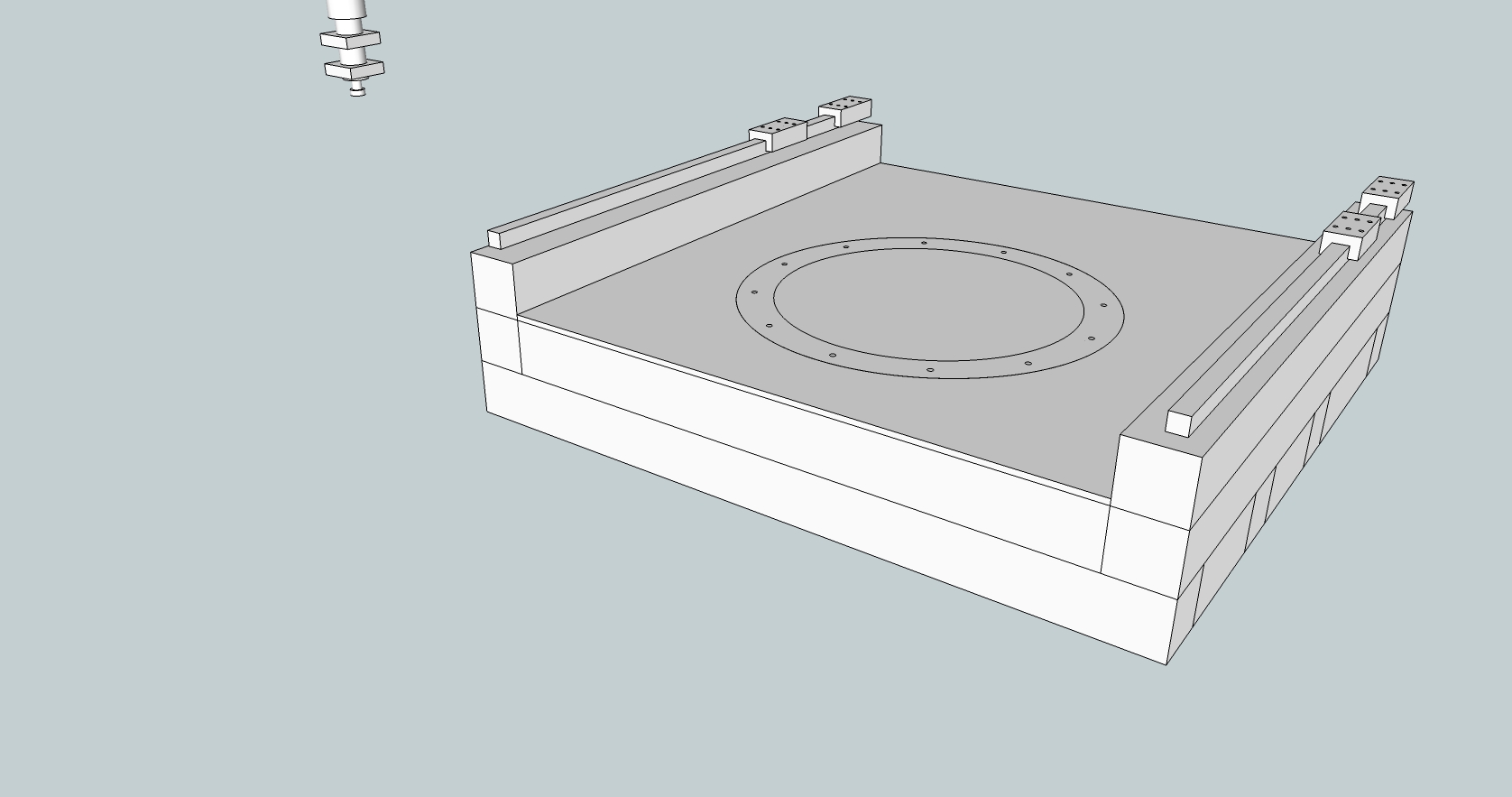

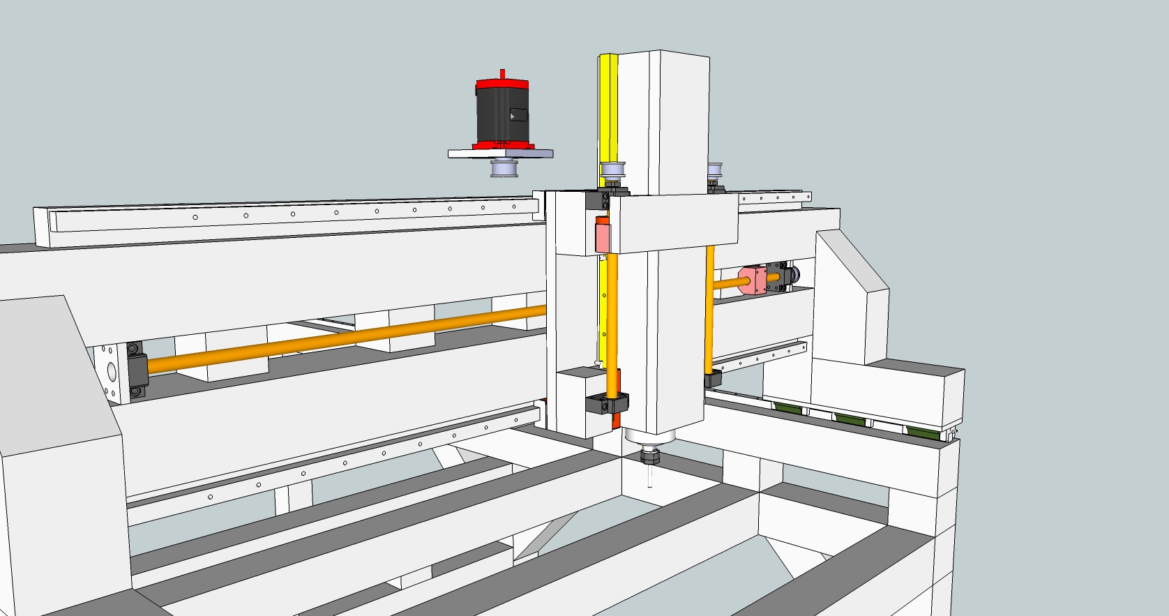

Now back to reality. I need some help here please! With motor calculations. I read numerous threads here and at the zone, have done numerous calculations as far as i could but will shamelessly ask here again as i am stuck.Almost finished the drawings. The Z looks quite nice and now i am sure its possible, though some blocks will look like cheese due to the ridiculous hole placement:redface:
I though i had everything clear until yesterday i calculated the weights.
The Z weights 32kg and the gantry in total 120kg :black_eyed:
Part of the problem lies that i don't know what exactly i want:hysterical: as till now i have experience only with small weak machines.
1. I would like the gantry and the Z to be rigid as they are in the drawings
2. I would like the machine to be in the middle between resolution and speed. What i am not sure is what speeds i want/not rapids-cutting speed/. I will cut wood and aluminum on that machine. I chose 1610 to move the z left right and 2510 screw to move the gantry. I thought of 1:1, now i am thinking of 2:1, otherwise not only i am jumping in the so called "servo territory" but will have to jump in the "expensive big servo territory"
I have decided on the 3kw spindle. I am not sure but i believe i will be happy with sturdy heavy machine that could do 250IPM /6350mm per min/- cutting in wood at good if not full cutter depth. The weight should help with the depth and i assume with the aluminum finish. Aluminum i will be happy if i do it at flute diameter depth. It seems the machine will be sturdy enough for this, having in mind the very extremely low overhang with my design, enclosed frame spoindle and strong gantry +the quantity of bearings.
3. I thought of driving the Z with hybrid closed loop Leadshine Nema 23 3Nm, same the Z left right and 2x the same that move the gantry.
That was when i did not know about the actual weight.
Now the question is:
-do i make my machine smaller / which i would not like much, cause the money will be almost the same and missing eventual job on the long run could be very undesirable/
or
Keep it like this and figure how to drive it.
So definitely i need some help in this mess in order to evaluate options and make no mistake here.
The servos i am looking at are these: my friend Fred's BST store
He seems to have the lowest priced servos and drivers around and as i will buy the rails and screws from him, seems quite logical choice
Questions:
having in mind that i don't want to compromise one axis due to small savings of $ and ruin the integrity of the machine. Obviously on the long axis i will go with servos. And here BST store llloking at the prices of servos i am almost ready to fit servos on all axis, as they are almost the price of the Leadshine closed loops
1. The Z weight will stay the same. 10kg spindle + some aluminum, there is nothing more to do except lower the weight about 5-6kg which i believe is not worth it . That is clear. RM1605 screw . Should i stay with 3Nm leadshine Nema 23 closed loop motor 1:1, change the relation 2:1, or upgrade the motor to servo?
If servo, what reduction and how big the servo motor?
2. Z weight again same. RM1610 screw. Should i stay with 3Nm leadshine Nema 23 closed loop motor 1:1, change the relation 2:1, or upgrade the motor to servo? If servo, what reduction and how big the servo motor?

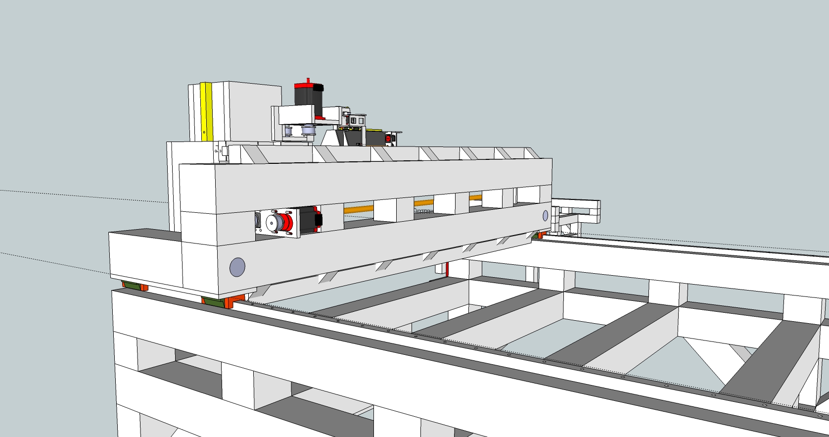

3. Gantry 120kg :black_eyed:, 2510, rotating ball nut both sides.
options i see:
- drive it with 2 servo motors, one each side. I am lost what power i need here. According to what i calculated if i am not mistaken could go with 2x 6N.M 1.8KW 3000RPM 110ST AC Servo Motor 110ST-M06030 + Matched Servo Driver / 310euro each . i am not sure though if the reduction here should be 2:1? Or if with 2:1 reduction i could go with smaller servos like the 4N.M 1.2KW 3000RPM 110ST AC Servo Motor 110ST-M04030 + Matched Servo Driver, where the price is 304euro, so as you see there is almost no price difference .
-drive it with 1 big motor and 25mm belt which i am almost sure i can fit to pass through the gantry beam
for a motor i believe the 130ST-M10025 servo motor and servo driver system 2.6KW 10Nm 2500rpm 10A / 375 euro/ would be ok. Again not sure if the ratio should be 2:1 as i assume.
4. Or i stay with closed loop steppers, but they arent cheap, i almost decided on servos.
5. I can not find what size in Nema are these servo motors so i could continue with the drawings, in fact no info on these cheap servos
PS. Found the documents at last for the servos PDF specs
it seems they are Xinje Servo drives and motors here PDF for the drives
Attachment 11053Attachment 11054Attachment 11055
What are your thoughts guys?? Please, don't be shy :redface: , tell me where i am wrong

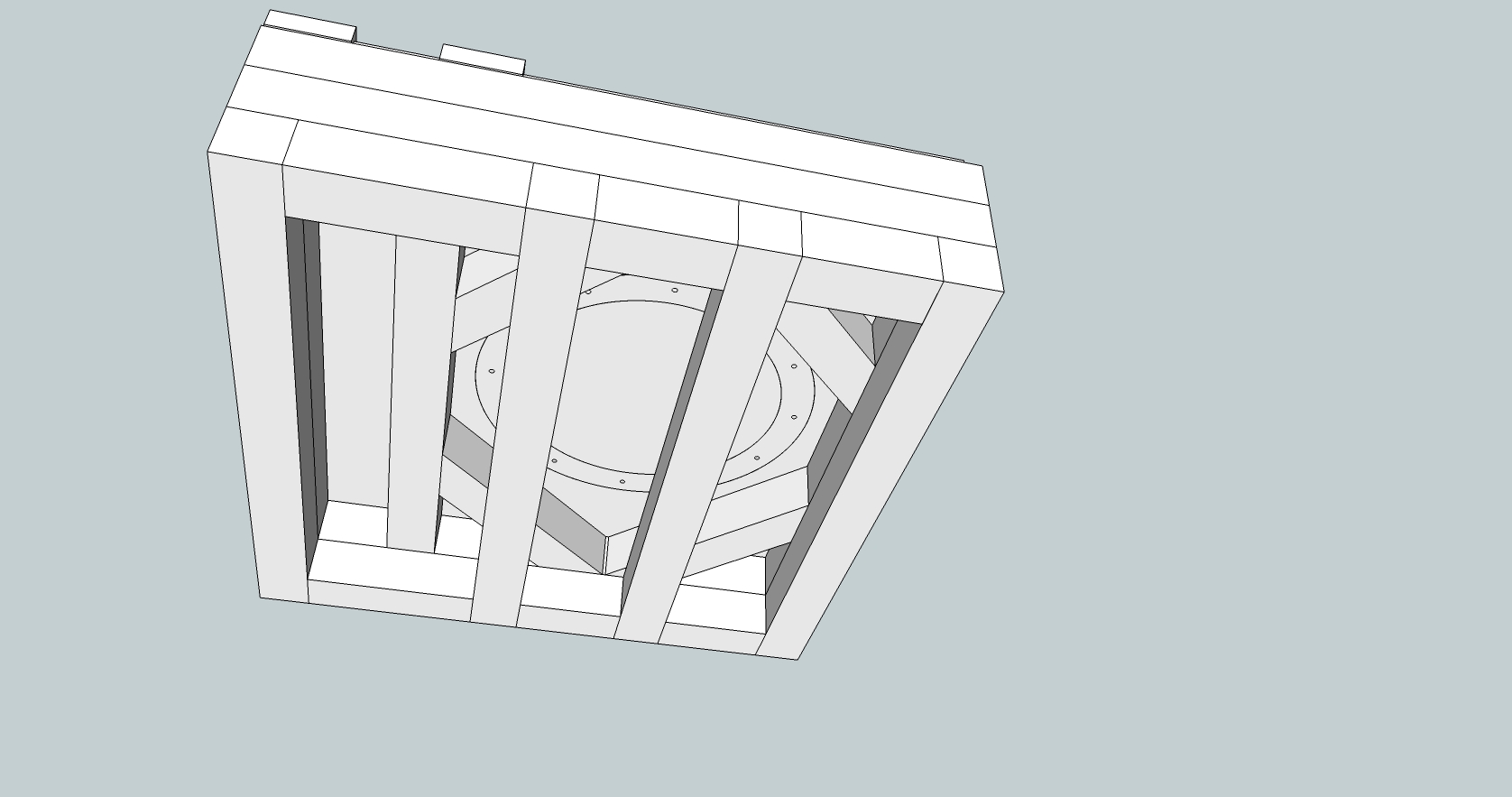

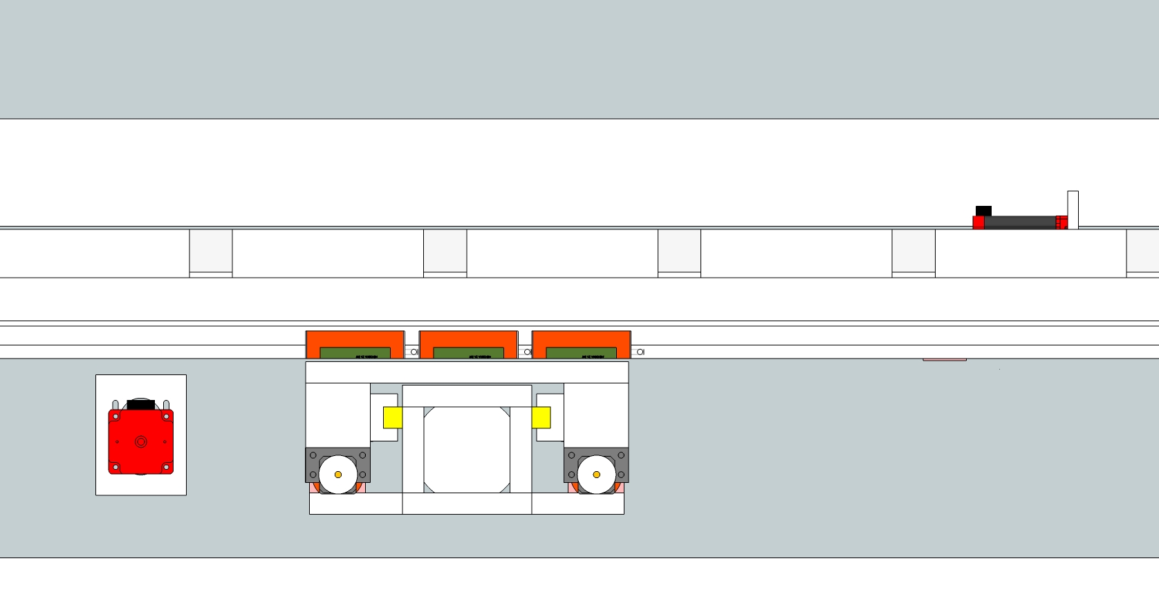

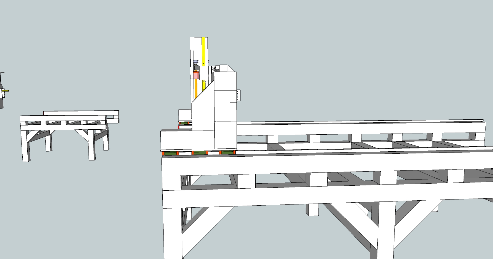

here are some updated cheese drawings:
Attachment 11047Attachment 11048Attachment 11049Attachment 11050Attachment 11051Attachment 11052

Answers to questions:
1) Ballscrews give a very large mechanical advantage. You do not need to worry about the weight of the Z-axis so much. See here. You'll be fine with a generic 3Nm motor and 70V stepper driver. The closed loop ones are a good concept, but cost a huge amount more for little gain.
2) Don't use RM1610 - it doesn't gain anything.
3) I wouldn't go with the long belt idea, especially when using servos as servos work best when they are rigidly coupled to the load - i.e. without a long stretchy belt.
You may well be fine with two stepper motors - have you tried putting the values in this spreadsheet?
If using one servo, the formula you need is this:
Je=M*(L/(2*pi))^2
Je is the equivalent inertia, L is the pitch of the screw (so 0.005m with 1:2 ratio) and M is the mass of the gantry.
Next find the inertia of the servo motor rotor (Jr), e.g. it says in the datasheet for 110ST-M04030 is 7.61kg-cm^2. You then need to find what 'inertia ratio' the motors will tolerate - typically it might be Je/Jr<5. So just use the above formula to calculate Je, divide it by Jr (7.61kg-cm^2) and if the result is less than 5 the motor is probably suitable.
e.g, M=120kg, L=0.5cm (1:2 ratio):
Je=120*(0.5/(2*pi))^2=0.76kg-cm^2
Je/Jr=0.76/7.61=0.1.
0.1 is much less than 5... so that servo is plenty big enough. Another way to look at it is rearrange the formula to find the mass a particular servo will drive, e.g:
M=Je/(L/(2*pi))^2
Je=Jr*5=7.61*5=38.05
M=38.05/(0.5/(2*pi))^2=6000kg(!)
Or if the ratio is 1:1, that's
M=38.05/(1/(2*pi))^2=1500kg
(So note the quadratic relationship - if you double the ratio the drive-able mass goes down by a factor of 4)
The rated speed of that motor is 3000rpm, so the gantry would go at 3000*0.01=30m/min with 1:1. You need to check the Je/Jr ratio - Je=Jr gets the most efficient energy transfer, but the drives do tolerate a mismatch so you need to find how much, as going with them equal generally results in an oversize motor. You should also include the inertia of the pulleys in the system - just work out their inertia (assuming cylinders is near enough) and add them to the Je value, remembering to take into account the drive ratio.
Either way, you can see that that servo is far bigger than you need... so I suggest you put the formulas in a spreadsheet and find which motor is best. Also try the stepper motor spreadsheet I linked to earlier, as I expect you'll find that there are suitable stepper motors available.
4) If you use stepper motors, and select the correct size motors, then they wont stall unless you crash the machine. The only time the closed loop servos help therefore, is if the machine crashes. For the same amount of money as the closed loop stepper you could get a much higher torque standard stepper motor and be certain that it wont stall.
Re: Some help please with motors and decisions!
I forgot to mention...I'm not keen on the placement of your Z-axis ballscrew. If a large force is applied parallel to Z, the axis will begin to skew (i.e. rotate in the Y-Z plane), due to the ballscrew placement being off center. The effect can be reduced by increasing the spacing of the Z-axis linear bearings, or go back to two ballscrews, or get the ballscrew closer to the center. That's why on the new machine I placed the ballscrew intersecting the Z-axis ram - it got it closer to central, but admittedly still not ideal.
