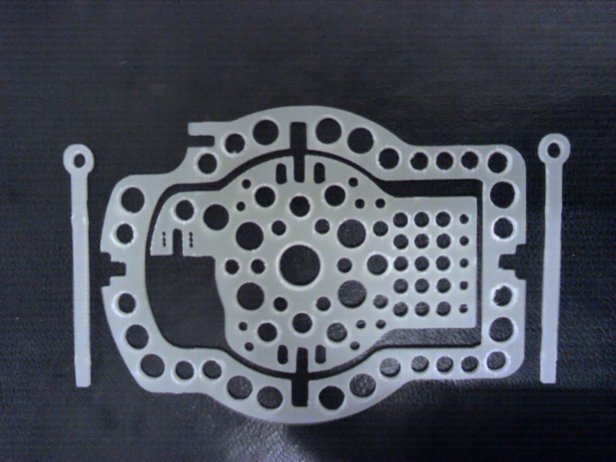

5 Attachment(s)
Re: Hello from a lurker...

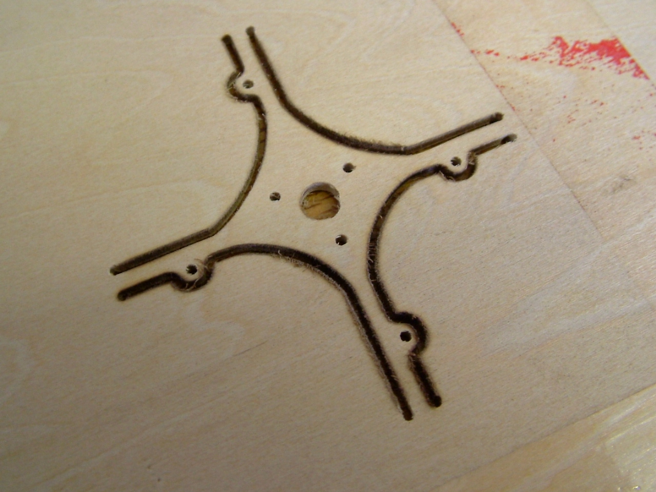

Lol, thanks for all the replies lads. TBH I knew I was going to get slated for talking about building from wood, I've got broad shoulders though so I can take it.
I've been using a machine built from 6mm MDF, drainpipe, gas pipe and cheap all-thread studding for 4 years. I don't think you can get much more 'budget' than that. But to be fair it's done what i've asked of it. Some pics attached of the type of things i've been cutting.
My reason for the plywood build was to spend money on decent hardware, supported linear rails, ballscrews, bearing blocks etc and also good electronics; this is the driver board, relay board and psu i'm using at the moment : www.easy-cnc.com * Your best option in driver boards for CNC machines :cower:
I was hoping that I could then use the ply machine and work on a better design in the future using the hardware and electronics i'd invested in.
I agree that £400 is pricey for some bits of plywood, but thought it was reasonable considering the R&D work that had been put into the design.

From the images you've posted it's clear that your machine has quite a lot of backlash, so you definitely want to eliminate this by using ballscrews on your next machine.

By the looks of it, you are getting quite a lot of phenolic plywood for your money, which isn't exactly cheap, and is more stable than most other wood boards.
Yes, £400 could buy you all the metal you need to potentially create a better machine, but then you've got to learn how to work with metal and probably spend more on tools to be able to work with it or pay for somebody else to do it, whereas that £400 gets you a basic machine that needs a lot less input to get a working machine.
You already have experience of CNC, you have obviously done your research, and you have a reasonable expectations of what the machine should be capable of, so I personally don't think buying that kit would be a bad choice for you. However, I would be looking to try and find somebody who has already bought one, to make sure the kit they received lived up to expectations, and that they never got supplied with a bunch of poor fitting parts.

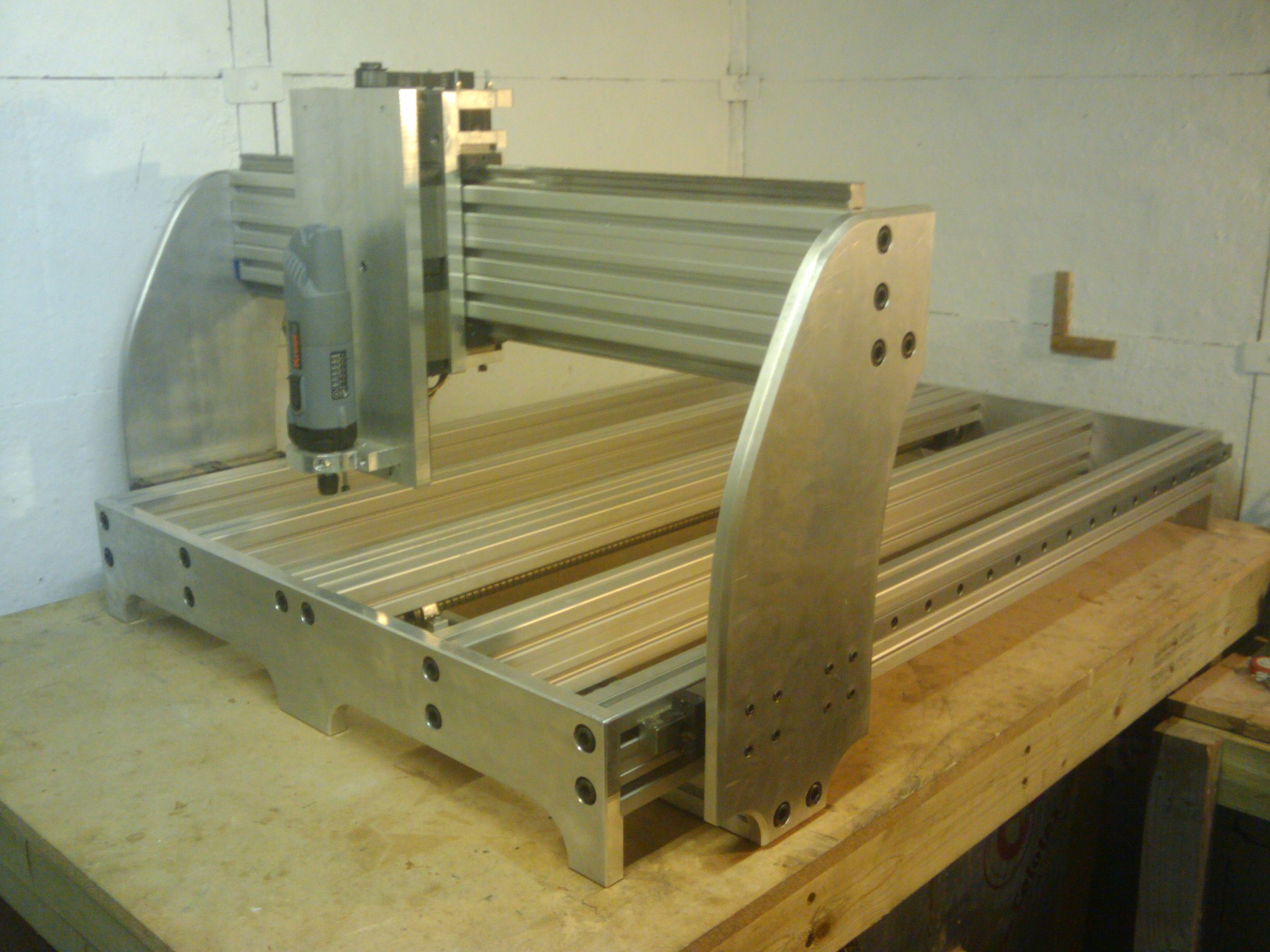

If you want bling and shiny then £500 would buy all the Aluminium plate and profile for this machine Attachment 10250 which purely by coincidence is very similar in design to Excel's machine here EXEL CNC SL6090 Pro that cost's £6000 and it's not has stiff or neat has my design(Which was designed and built well before they started).
With £2K you can build a cracking steel machine complete with profiled linear rails and all the trimmings.
To give an idea I'm just Finishing off a machine for someone like the one in the Picture which has profiled rails, ballscrews, 3Nm motor's along Proximity switch limits and energy chain all the trimmings etc.

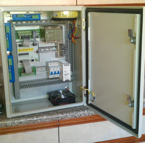

Proper Control box (which I'm doing Now between typing here.!!) Attachment 10251 that has high quality 80V AM882 Digital drives, excellent CSMIO-P-M motion control card full with 24v signals and Estop system driven thru Pilz safety relay etc
All this for £2800 minus spindle.!! (and I'm covering most my time). . . . . Built from steel it would be Less.!!
