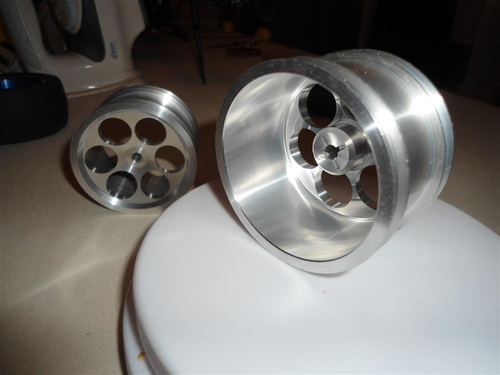

Having said that, even with a small lathe you can, up to a point, make reasonably large accurate parts so long as you're patient. e.g. I several years ago I made the front two of these wheel rims on a Sieg C3 lathe which only had an 80mm chuck. The fun bit was milling the hexagons without CNC. The other two I did more recently with the Colchester lathe in a fraction of the time.
