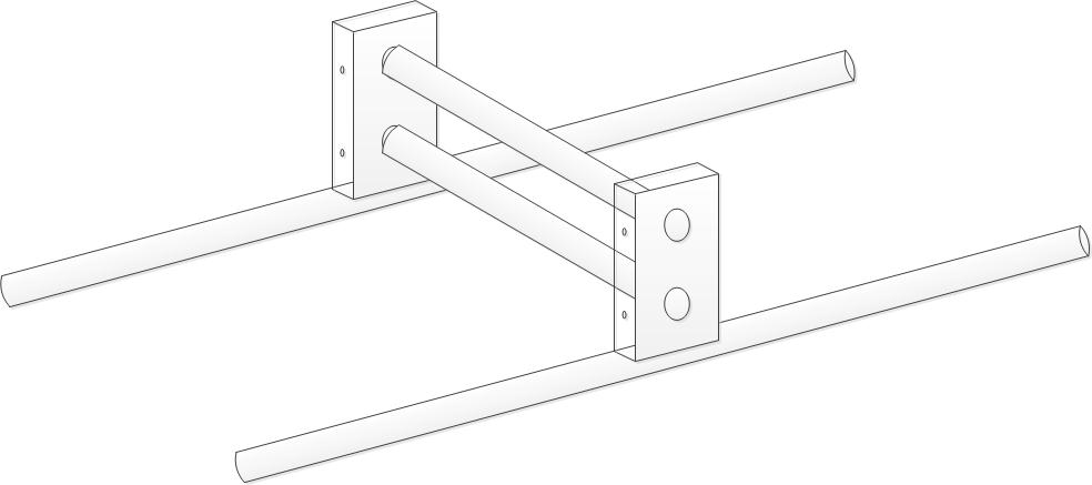

Ok so my cnc is generally great (for my very very simple needs!) but it does have 1 major failing that i would like to improve. The gantry is made up from 2 20mm round bars spanning approx. 7-800mm and it supporting a 1.5kW chinese spindle and associated mounts. You can imagine what happens - tons of flex/ruined parts - most noticeable when trying to cut sharp 90 deg turns from y to x, ends up with a lovely big curve if I go to fast! :thumbdown:
Here is a rough diagram.
Attachment 10489
I also had a situation cutting a long thin pocket running down the x axis - all was going fine until suddenly the spindle seemed to flex down as if was trying to dig into the wood! I guess this was the flexing issue allowing this to happen...
So my question is how could I possibly improve my situation with minimum cost/rework?
Two ideas I thought of are:-
* upgrade the round rail to a larger diameter.
* change the round rail to supported round rail - I was thinking I could grid off part of the support at each end of the rail so it would fit in the existing holes?
Any ideas?

I suppose you have to first establish exactly where the flexing is taking place, it's maybe not where you first think of.
What about attaching a wide piece of aluminium extrusion or box section from one side piece to the other then fasten supported rail to that.

Valid point - I admit the only reason for picking on the gantry as being the issue is based on my complex scientific testing - I grabbed the spindle, yanked it around until it flexed! I all feels very rigid except for flexing the spindle up and down.
EddyCurrent
That could work really well! Thanks for the idea :)

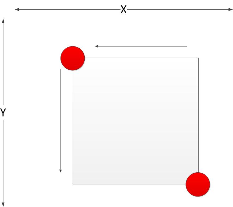

Also, back to my original issue, does it look like it comes from the flexing on the y axis?
Here is a pic...
Attachment 10494
If I feed too fast the red points end up being curved rather than a sharp right angle?

Can you post a picture of a part which has rounded off corners, which you propose are caused by deflection? The reason I ask is if you have the acceleration set too low for the X and/or Y axis, that will consistently cause the machine to cut noticeable curves in corners if it's in constant velocity mode. Search 'constant velocity' or 'G64' on the forum and you'll find plenty about it. If your acceleration for the Y axis is set too low, then the corners you indicated will be rounded, so I'd start by checking that.

Agree with Jonathan and Pretty sure this will be tuning and CV problem. Post the feed rate in G-code or better still the G-code file it's self so we can check.

I had similar problems with corners cutting as curves. I changed from CV mode to 'Exact Stop' mode in Mach3 and it solved the problem. I know there are probably better ways by tuning CV mode etc, but it might be a quick way of proving whether it's mainly a software or hardware issue.

Glad to hear you are enjoying the machine despite the problems. The rounded corners sound like the software setting already mentioned, but on the subject of unsupported rails - my first CNC machine used 900mm unsupported 20mm rails for the Y axis (it was a 'landscape' machine rather than the more usual 'portrait' machine) and 600mm unsupported 20mm rails on the X axis. The Z axis was around 300mm unsupported round rail.

Your acelleration on X and Y is quite low - you should be fine with about 1000mm/s^2. Try increasing them, or at least set them both to the same thing.

Ok well Agree most of this is motor tuning and like Jonathan suggest you balance the tuning up.!! . . . But looking at the frame it has some serious issues.?

The Gantry and the way it fastens to the bearings is a major weakness. It's only mounted to the X axis bearings with 2 bolts per bearings plus the mounting plate area is woe fully inadequate. Also the fastening of the Y axis rails into the puny narrow gantry ends is very weak and the whole thing must flex quite badly and could be some of the problem on direction changes with deep Cuts.
Like said before given the parts you have already and spending a few hundred quid building a new frame will be far far better solution that will give a very good machine that will do every thing you want and to good standard for years, and still be worth more money than you invested when time to sell.!!
