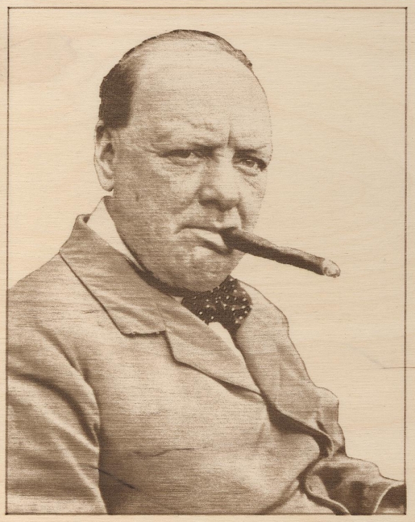

Laaser Diode Engraving with PicEngrave Pro 4
Laser diode (445) engraved on Baltic Birch Plywood using gcode generated by PicEngrave Pro 4.
Engraved at a 45°angle with .006 inch raster line spacing. Original engraving size 6 x 8 inches.

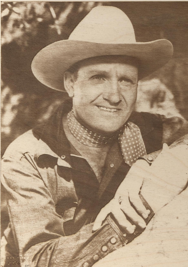

I engraved this one today. Same settings as above.
