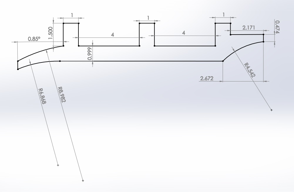

Hiya every one,
I'm hoping someone can help me.
I'm new to cnc and learning.
Managed to draw a part finally and am looking to get it into gcode for mach3 but lazycam is suitable.
Here is my 3d part.
Simple File Sharing and Storage.
Could someone tell me if it works and what program it will convert to gcode in.
Many thanks.
Becky

Can any one test this part so I know if it the design or the cam software.
I tried BamCam but the part doesn't even appear.
Re: Help needed for a 3d part gcode for mach3

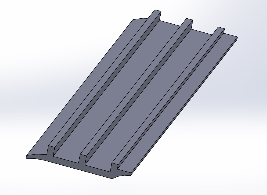

I can open it up in Autocad and see the rail has been extruded but It appears there are no 3D faces, when DFX is imported into Artcam pro, (reads no 3D triangle data)
Phill
It opens fine in Solid works just the curved surfaces are not so smooth and made from straight lines. (Maybe meant to be that way.?)
To create this then I'd would do it mostly with 2D toolpaths and just use 3D for the curved surfaces. Depending on material then could even be done with all 2D toolpaths if profiled tooling was created or found, this would greatly speed up the cutting time.
Save it as .igs or .iges for import into a wider range of CAM software packages.
I've just used Autodesk Inventor to open & Save As a .igs and opened it in BobCad Cam.
I guess you'll machine in two operations, the grooved side first and arrange a fixture or vice jaws that will hold the part for machining the second side.

Problem is that parts of your model don't suit 3D strategy's and tooling, for instance the slots have sharp corners and for an acceptable finish you'll want to use ball-nose cutter, this will put a radius in the corners. To remove this radius will then require additional operations and cutting strategy and often the cheaper Cam software's don't provide these strategy's, in this case called Rest milling.
Rest milling goes around with different size tool and removes areas that get missed by the previous tool, in your case you'd use flat bottom end mill to cut the radius away.
If you haven't got these more advanced strategy's available then your stuck with the radius or getting creative with what strategy's you have available.
Then there's the wasted time to consider, to get best finish quality with 3D paths and ball-nose tooling requires very small step-over's and has the tools get smaller in diameter the step down has to be kept lower else the tool snaps meaning multiple passes.
Getting round this tool stressing and multi passes problem then involves first using roughing strategy to remove excess material which again involves more time. So now you have 2 operations, 1 x roughing and 1 x 3D both these have to cover the whole surface area.
Then you'll still be left with the radius to deal with.!! So Even with Rest milling or other advanced strategy's like pencil milling your into 3 operations that have to cover the whole surface area. If you don't have these advanced strategy's then chances are your workaround will involve more time.!
Now if you combine 2D and 3D strategy's the operations get much simpler. The slots are simple 2D pocketing strategy's and because you can use straight tooling the corners are sharp requiring no clean up and can be cut in full depth and in one quick pass.
Same with flat areas which are simply done with area clearance or pocketing operations with same flat bottom tool and taking 50%+ Stepovers at full depth so again very quick.
This then just leaves the curves which are done with 3D strategy and roughing passes but now the area to cover is much less and confined just to the curves.
Because we have been using wider flat bottom cutter for 2D operations we use same tool for rouging. This then just leaves one tool change to ball-nose cutter which only has to machine the curves and blend into the flats.
Combining strategy's is not complicated and it's simple case of looking at the part and identifying the areas which suit 2D or 3D strategy's best then selecting the area by either defining a boundry to stay within or selecting geometry or surfaces. The Cam software you use will mostly dictate how this is done and how simple or hard to do. Better software makes this easy as clicking the surface or edges and it works the rest out for you. Others require you define a boundary calculate and apply offsets for tool being used.!!
The fact is Most parts like this require multiple operations to achieve a finished part. Combining 2D & 3d strategy's is no more complex or difficult than having multiple 2D operations like Drilling, pockets, profiling etc in one G-code file and something you'll need and want to learn quickly if doing these types of parts has the time savings are huge when doing multiple repetitive parts.
Hope this makes it clearer and don't be scared off with combining operations has it's bread and butter stuff that you'll need to learn and can save many hours or days work.

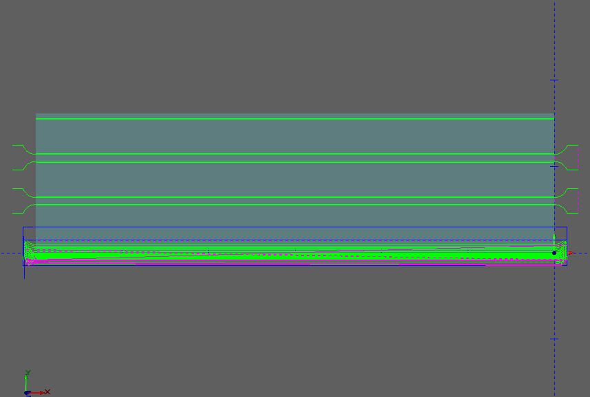

Getting back to the OP's original request and stepping away from the Tangents this topic has spawned I've had a fiddle in BobCad Cam V25 Build 996
Before posting code I'll wait for preferred tooling size, advance per flute and spindle speed from the OP, but here's how you could get there -
1. import and reposition (translate) the model
2. Create a new layer and select it as active, then used Extract Edges From Solid to create a wireframe in the new layer, which can then be viewed satndalone by turning off the original layer (with the model in it).
3. Use Profile for the flat edge, select the line where the flat meets the vertical for geometry.
4. Use Profile to take the curved edge down to the upper vertex of the curved suface where it meets the vertical, select the line where the curved surface meets the vertical for geometry.
5 Use Pocket with outside edge lines set as dotted lines (allows the tool to pass the edge of the work) to make the operation Open Pocket for the two middle slots.
Now you're into the curved surface, you'll probably use a function requiring a Boundary and selection of the surface in the solid model layer to be selected as the geometry.
To make your boundary create another new layer, set it as active and use CAD Line drawing based on Extracted Edges to construct a Boundary for the operation, usually 1/2 the tool diameter smaller than the surface to machine.
When you Compute paths you'll get something like this -
Attachment 10570
CAM is a lot more in depth than I ever imagined before diving into CNC, I've missed out all the detail of selecting tooling options, top & bottom of work where required and multiple other options within the functions, hopefully the above shows why it's rarely the case that a request for G-Code from a solid model is met. There can be quite a lot of work for what looks like a simple job and it's rarely simply a case of feeding a model to the software and getting G-Code out,

Without interrogating a drawing accurately I'd guess at 10mm rad but only cutting over about 6mm of material.
So guessing it could be formed onto a worn or old 8mm or 10mm cutter, possibly less.
Basing this on a dimensioned drawing I saw where the gaps between the slats were specified as 4mm.
Seen various 3d drawings but can't recall seeing a 2D end section drawing
My first thought was the same John about grinding a profile but to stay strictly to the drawing then 3 x Rad would be needed has can be seen from this end profile. . . If can't be changed then thats 3 tools to grind.!!
Attachment 10576
Base Could be done with 9 & 14mm ballnose with part on it's edge but thats then messing around with another clamping op and setup and not everyone has 4th axis.
Personally If I was doing them, Then For lower base I'd just shoot 9 & 14mm ballnose up each edge and flat mill up centre, obviously done horizontal.
For the other side it's obvious for slots but the round over then I would grind a tool I think. I'd also make them in longer lengths and cut to size.!!
This would be very quick and don't think it could be done quicker really.?
On that lower base there is only 10mm between the two radii, so if you stand the track on its side you could mill the whole of the lower side with one form cutter. Cutter would only be 16 or so mm long.
Becky want's 190 ??? odd so well worth doing.
Top done as you say.
