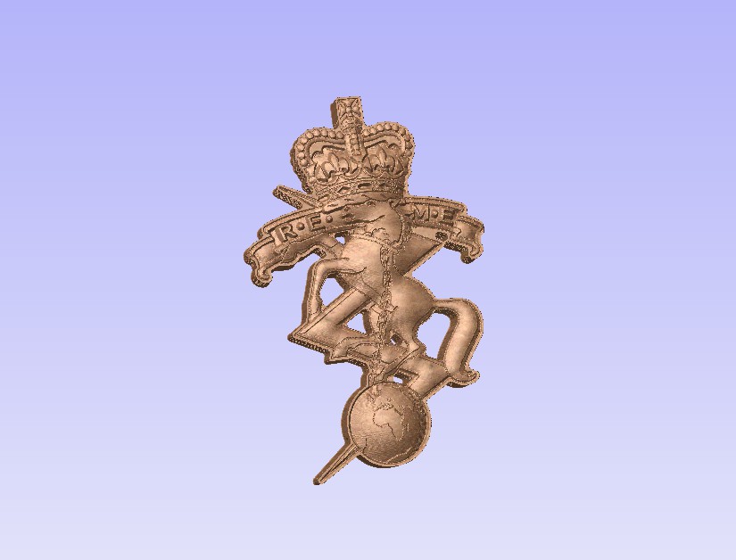

Is it something like this your were after
Attachment 13001
I spent five mins just messing with it but there is a lot of noise on the picture.

How on earth did you get that?!
Thats looking good! What program is that?
If you are feeling generous i might have to pinch a 3d model of that :)
By noise, is that because it is a low resolution picture?
Re: Grey scale / height map / relief carving
Yeah the noise is the low res picture and by all means i can send a 3d model ill have a look see if i can get it any better

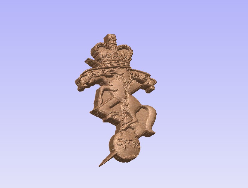

Ok hows this
Attachment 13003
I found a hi res picture of it

I use aspire ill have to figure out how to send a 3d model of it
