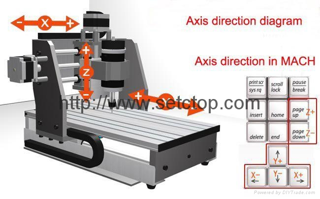

Will start with work orientation the axis x and y seem the wrong way round when looking at the machine bed in a landscape orientation. I know this is the way the machine is set up. But is this normal? Is it worth trying to swap the the x and y axis?
Attachment 10778

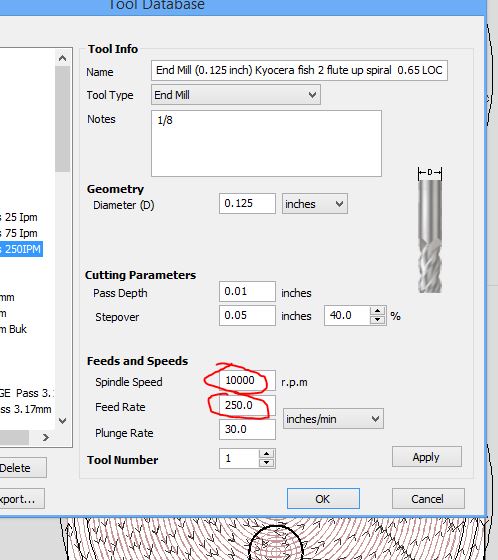

I have similar machine, its not strong but does the job. As a starters do same depth of cut as your bit diameter and you will be OK, you could do maybe even aluminum, but you have to scratch it.

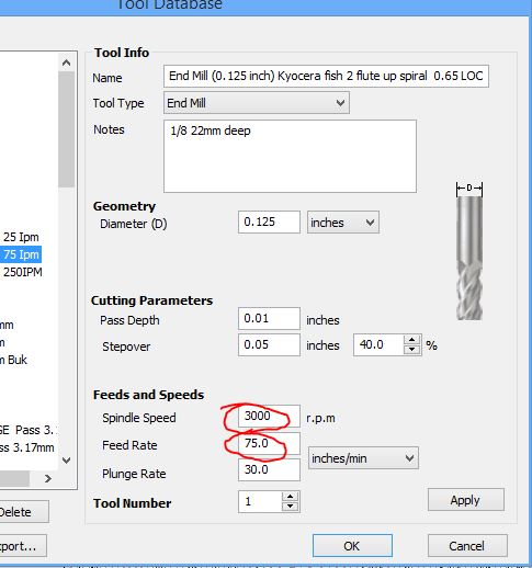

Here are some speeds and feeds which can serve you as starting points.I lost with these a couple of weeks and a lot of broken bits. For this type of machine they are OK, even if many may disagree:
everything in imperial,1/8 or 1/4 it doesn't matter as usually the machine is the limiting factor here , not the bit , though more careful with longer or thinner bits :
soft plastic , its scratching but if you go deeper with flimsy machine, it melts, better use single flute if speed is needed.
Attachment 10779
plexiglass
Attachment 10780
MDF,wood, works for phenolic plastic also, composite panel
Attachment 10783
Harder wood
Attachment 10785

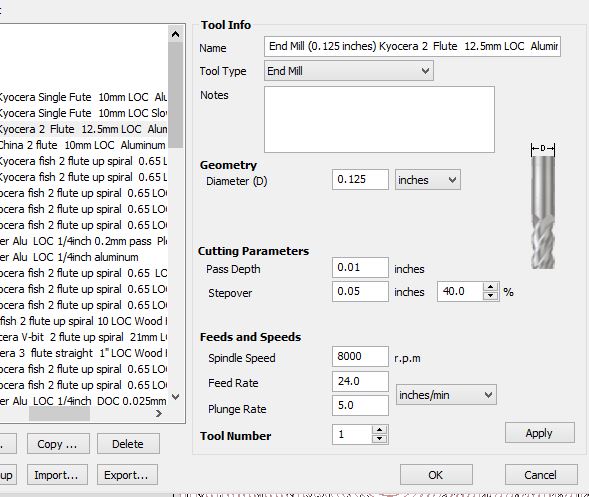

Aluminum, i told you its scratching. You could change the depth of cut. 8000rpm is pretty the perfect speed for this material
with 2 flute
Attachment 10790

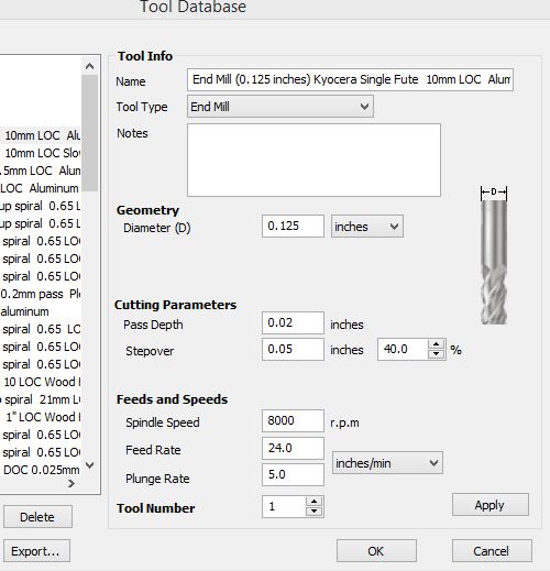

with 1 flute, which is better in my opinion
Attachment 10792

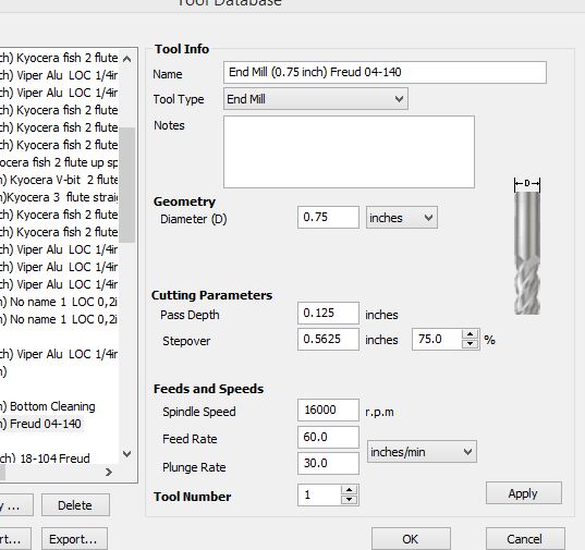

Surfacing with a big 2 flute cutter
Attachment 10796
This should keep you busy for a couple of weeks ! :friendly_wink:

Here are some more tips:
1. Using the formula
Formula to determine feed rate[edit]
This formula[10] can be used to figure out the feed rate that the cutter travels into or around the work. This would apply to cutters on a milling machine, drill press and a number of other machine tools. This is not to be used on the lathe for turning operations, as the feed rate on a lathe is given as feed per revolution.
FR = {RPM x T x CL}
Where:
FR = the calculated feed rate in inches per minute or mm per minute.
RPM = is the calculated speed for the cutter.
T = Number of teeth on the cutter.
CL = The chip load or feed per tooth. This is the size of chip that each tooth of the cutter takes

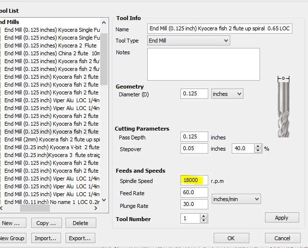

you could variate things if need job done faster up to where drivers, machine, rigidity holds, see 2 examples below:
Attachment 10804
Attachment 10805
Means as soon as the CL chip load stays the same its Ok.
However its worth noting that is not a good idea pushing the spindle more than 18000RPM if you want to last. The bearings i mean.
I prefer going deeper than faster, when i want to push.
Its worth noting that some materials have "perfect spindle speed". Like aluminum for example -around 8000rpm. Anyways, the above examples from the previous post are all with the relevant "perfect" speed for the material.
2. These numbers also work for engraving /v bits/. However for bits with included angle 45 and 30 degree is better the feedrate to be 25% slower, cause will easily brake tips. Same is for thinner than 1/8 bits or long bits.
