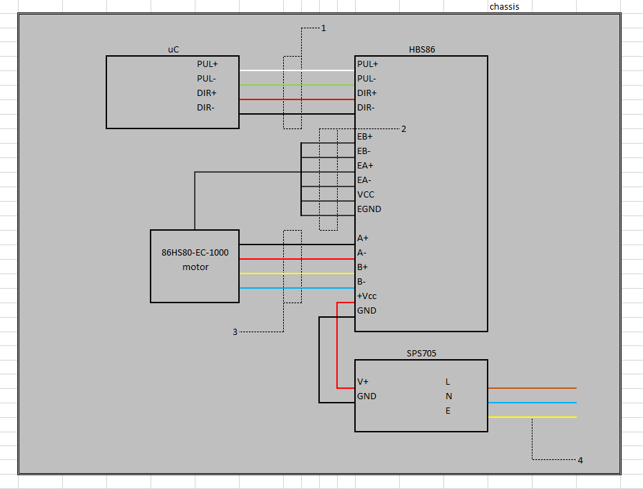

I've numbered the screens, should all 1-3 be connected to 4 - E(arth) / chassis? I'm guessing I need to put a link between the E(arth) terminal and the chassis as well to get the whole chassis earthed?
Yes I would connect them all together but each cable screen should be earthed at one end only, the other ends should be insulated with some heat shrink sleeving for example.

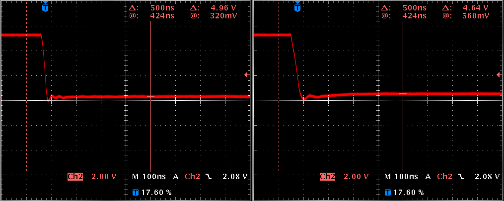

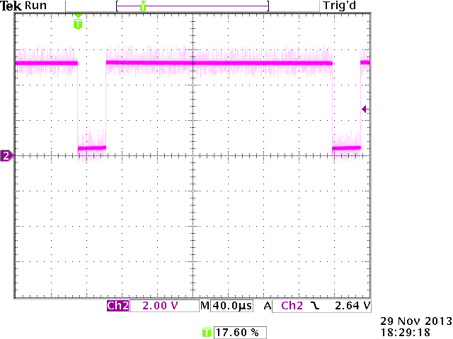

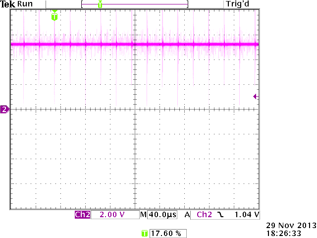

I've connected the screen (one end, the other is tied back) for the PUL / DIR inputs into the E(arth) on the PSU, not much difference though, here's a shot before the screen got connected:
Attachment 10861
and here's after:
Attachment 10862
Minimal difference, although there's a lot of noise on that line (that's the PUL- / GND scopped). Not sure what it is, or how to get rid of it. On the other hand, the proto board is a mess full of breadboard wires, so isn't exactly super noise resistant.

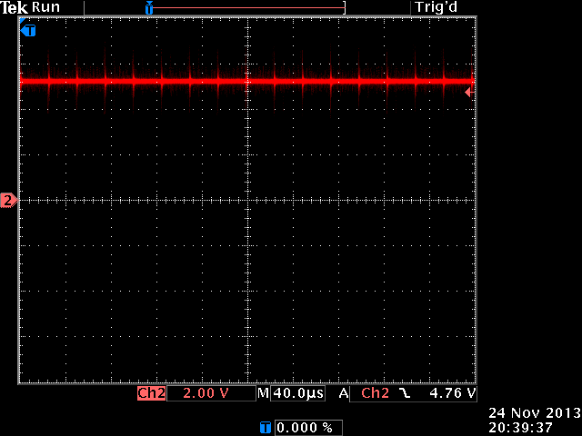

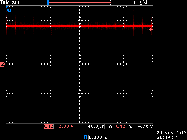

I've done some further testing on this, here's my findings:
1) as soon as I plug the DC supply in, there's noise on the PIC lines. It doesn't matter if the PIC lines connected to the driver or not, the noise is still there:
Attachment 10865
It's periodical, with a period of 11.5us, which gives a frequency of around 87kHz.

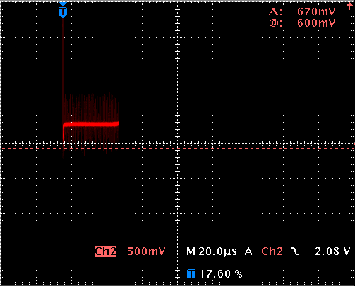

2) plugging the PIC control lines to the driver, causes the low levels to jump up by around 100mV, I wasn't expecting that to be honest:
Attachment 10866

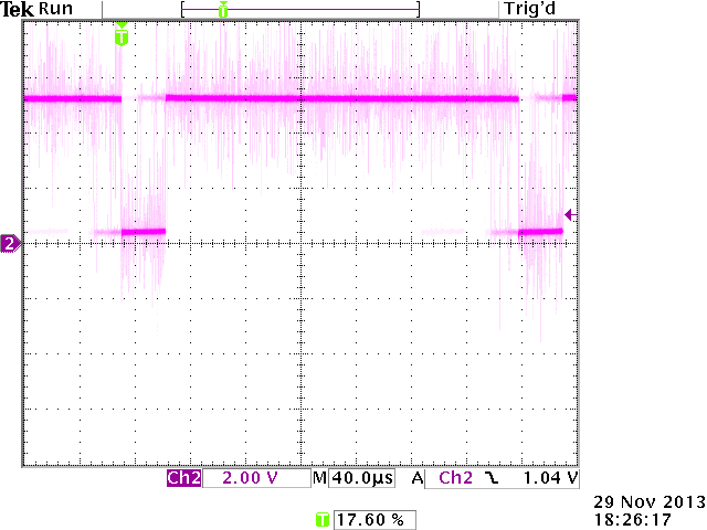

3) there's loads of spikes on top of the PWM signal, see here:
Attachment 10867
Not sure this makes a lot of difference, the high level trigger for the HBS86 is > 3.5VDC and low is < 0.5VDC, so it should behave itself.
Any ideas on how to tame this? screening to earth doesn't seem to affect the noise at all. I've also tried ferrites, with not a lot of luck.

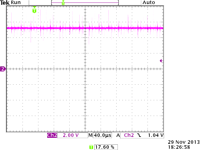

Re: screening / glitchy operation - sanity check

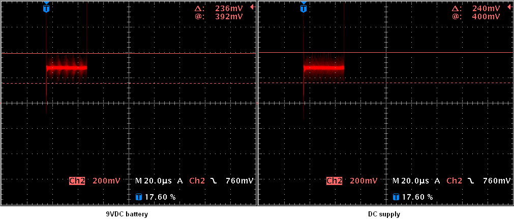

I've switched to a 9VDC battery, not much difference, after which I've earthed the driver chassis, which dropped the noise levels significantly. Comparison between a battery supply and plug-in DC supply with the driver chassis earthed:
Attachment 10868
I'll stick with the plug-in supply and keep everything earthed.
That's good, the main thing with trying a battery is to remove that doubt so at least now you know the PSU is okay.
So with noise levels dropped has it improved the operation ?

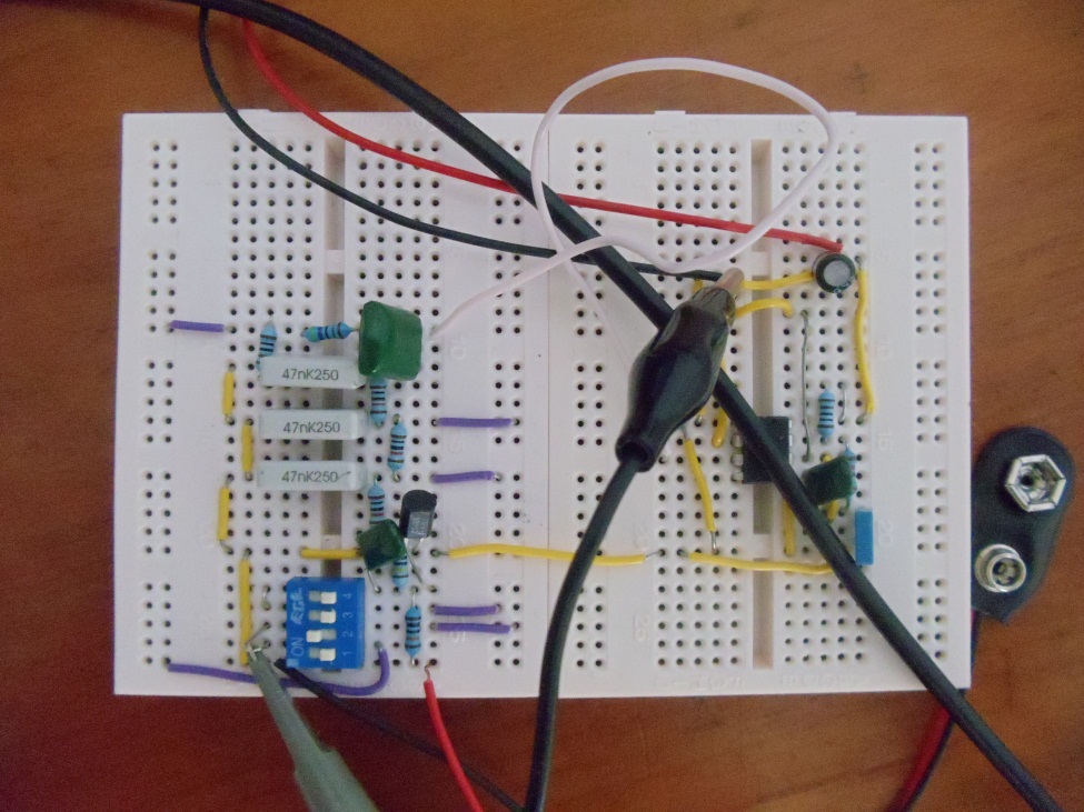

So did it solve the problem? Since using a battery didn't make a difference, that implies the noise is not emanating from the supply. The most likely source is the 'mess of breadboard wires'. You should aim to keep the wires short to minimize stray inductance, keep power wires close together for the same reason and use decoupling capacitors.
For example, you can see in this photo how the breadboard on the right uses much longer wires than necessary and the capacitor is a long way from the IC. My one on the left is neater...
Attachment 10869
The circuit above still worked as it operated at quite low frequencies (where stray inductance is less of an issue). If it hadn't then it would be worth rearranging it.

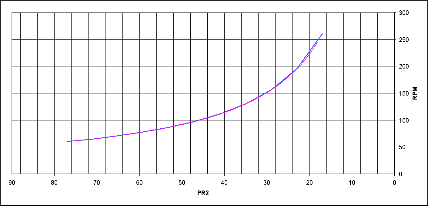

To do that, either use the (approximate) equation for that function or a lookup table to calculate the required PR2 value each time the timer interrupt occurs. I don't know what the purpose of this project is so not sure if this is necessary, but it's more interesting ;)
I can do, it's just currently it's connected as a general I/O, debounced with some action behind it. The change of approach is using a timer based INT, the period is set to 100ms, as the INT also acts as a 0.1s timer for timer / LCD /sampling purposes, I've looked at changing it to 15ms or so to change the PR2 by 1 rather than 6, but overall there's very little difference in how this relates to speed. Here's a comparison between a 1 per INT change vs. 6 per INT change:
Attachment 10872
Also the above shows the speed changing in relation to the value in PR2, as you can see it's not linear. I wanted to stop the motor without slowing it down, the load inertia isn't high and max speed will be around 500RPM.
All I'm wanting from the slow ramp is to have more torque at the start, the torque requirement drops once the thing is moving.

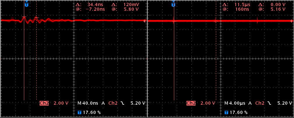

Ok I've tried the new approach with changes to the PR2 every 100ms, all works well on a scope and on the motor, although the motor still glitches now and then on start up. Have a look at the noise levels:
Attachment 10899
Huge is an understatement, this is measured directly on the plug to the driver, everything is grounded at this point, this includes:
- chassis of the machine
- motor
- driver
- screen on the PUL cable
- screen on the encoder cable
here's another print showing the noise levels with the motor stopped:
Attachment 10900
I'm surprised the thing doesn't trigger itself. If I unplug the motor and disconnect from the drive, the noise levels drop significantly:
Attachment 10901
The biggest question mark is the noise levels when I disconnect the screen on the PUL cable:
Attachment 10902
Grounding the screen seems to make things worse for some reason. Yes the screen is only connected on one side, the other side is tied back.
