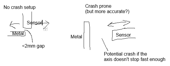

Cheers guys, separates it is. Separates feel like a better solution which is why I started out with that in mind.
I must admit I was wondering about the best way to mount the induction switches. The obvious method is to have them directly approach a metal plate as that feels like it would give the clearest detection but it would also be crash prone if the axis didn't stop fast enough. This badly drawn picture shows what I mean (I failed art).
Attachment 10874
My concern with the non-crashing arrangement is that the sensor won't have a repeatable home location.
Update... I see Jazz has just posted while I was writing this, that looks like a vote for the non-crashing arrangement with a very small gap.
Re: Limit and Home Switch Choice
Wobblycogs
Yes 100% vote for Non crash setup and having it other way doesn't make it any more accurate just puts it in the killing zone.!! . . . And you would crash into it that's 100% guaranteed. . .Lol

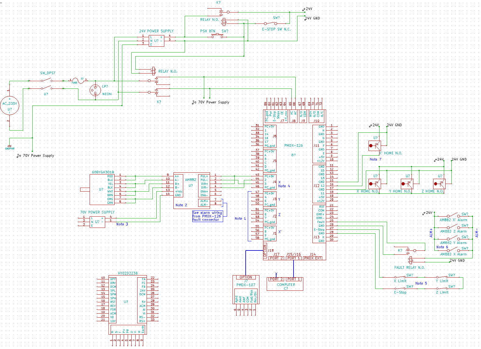

Thanks for the advice on home and limit switches. Hopefully I've now got a reasonable first stab at a circuit diagram for the machine.

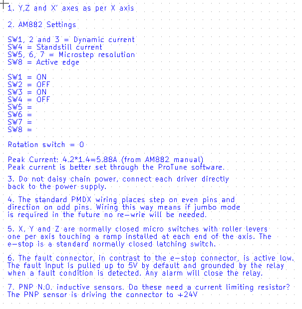

The stuff on the left hand side such as the wiring of the steppers and the power supply control I'm fairly happy with (the power control is basically a copy of circuit Irving drew). I'm a less confident that the stuff on the right is correct.
I'm happy enough with the e-stop circuit as it's just a bunch of N.C. micro switches and a big red button.
The manual for the AM882 drivers seems a bit vague with exactly what happens when the alarm activates. As far as I can tell the alarm can be set to either active high or active low and I'll set it to active high. Since the fault pin on the PMDX is active low and pulled up I've put in a N.O. relay which gets closed in the case of an alarm (because one of the alarms goes high). If I understand correctly the relay is necessarily because the ground for the alarms is not necessarily the ground on the PMDX. I can see this isn't fail safe but I'm not sure it needs to be as a fault shouldn't be an immediately dangerous situation.
The PNP inductive home switches are wired as per the PMDX manual so I think they are correct but I don't understand what is stopping them dumping a ton of power into the PMDX when the sensor is triggered. Do I need a current limiting resistor in the circuit and if so what size? Actually the same question goes for the AM882 fault circuit.
The circuit diagram image is really big, you might be best off right clicking and opening it in a new window / tab.
Erm I wouldn't be.? It's using 5V signal from BOB it would be better if you run 24v thru the switches and have it thru relay like you have the Fault. Then just return the 5V signal thru relay contacts. 24V will keep the switches clean and less noise immune.
Wobblycogs
Why not use NPN and the 12V on the PMDX to get around this.? Think the PMDX inputs can handle upto 33V but not sure about the amps.!!
With the fault your not sending anything in just breaking or returning the signal.

As always Dean a couple of very good points. I knew as soon as I said I was happy with the e-stop circuit that there would be something wrong with it :smile:, it's my super power.

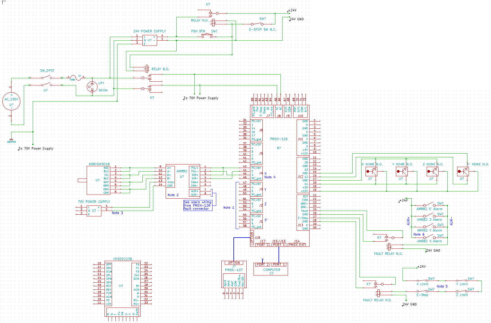

As you suggested I've put in a relay and run 24V through the switches. Can I just check that my understanding of how this works is correct. I think this is a suitable relay. Since the voltage is 24V and the coil resistance is 2.8k will this portion of the circuit draw 23/2800 = 8.6mA? It can handle 2A across the contacts which must be about 500* what the PMDX will put through it.
I was using PNP sensors because I had a 24V supply already in the system. That's a really stupid reason to make life difficult for myself though so I've switched them over to using NPN. I assume 12V is sufficiently noise immune for this to not be a problem?
Is the two e-stop button arrangement a good / bad idea? The one at the top left will completely kill everything by removing power. I only envisage using that in "hand-being-eaten-by-the-machine" emergency and it will be on the control box (probably). The e-stop button connected to the PMDX is for "uh-oh-that's-not-good" type emergencies and will be mounted on the machine.

E-Stop are EMERGENCY stops, so should be wired for YOUR protection. When you've got your hand wrapped around a cutter, you won't have time to ponder on which E-Stop to press...
The "usual" way to setup E-Stops is using a 24VDC circuit with all E-Stops in series which then drop out a contactor (or proper safety relay if you have plenty of cash!). You latch the contactor via a reset button and N.O. auxiliary contact on the relay. This way, the circuit will be safe if any E-Stop is activated or a cable gets broken. I've put my axis limits in series with the E-Stops because a near-crash IS an emergency. As for your feedback, you simply use another spare aux contact on the relay to make or break the BOB com/5v link.

I completely agree about the e-stop being for my protection which is why there is a button to cut the power. My thinking with the arrangement I had is essentially what Jazz has described. Hitting the limits is bad but I don't think it should be considered a life and limb emergency that calls for cutting the power as long as, and this is the important point, the machine can handle the situation safely.
Here's the plan then...
- Keep the e-stop that cuts the power and in fact add another button in series with it. One button will be on the control box and the other will be on the machine.
- Remove the e-stop button from the limits circuit.
- Add a machine hold button.

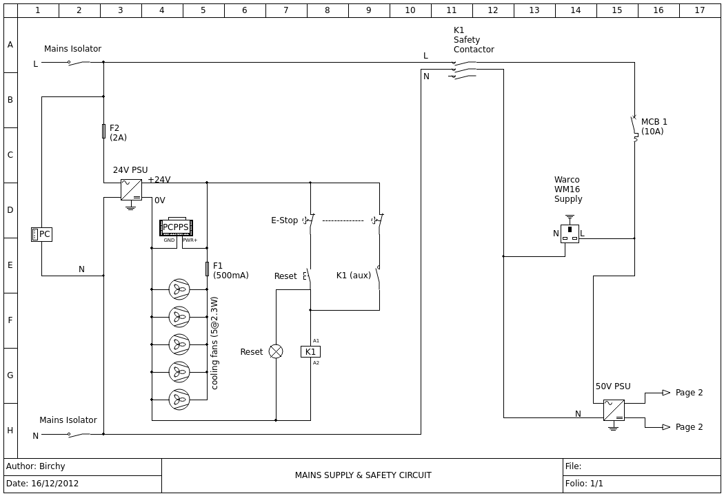

Along with this thread and my own I can see there is never going to be a consensus of opinion with regard to limits and emergency stop circuits. All anyone can do is see what others have done and choose the bits that suit them best.
Here's how mine is going to be, I just changed a few things this weekend and will upload my 'as build' drawings later.
My emergency stop circuit consists of a big red button on the control panel and another in series on the machine, the limits are also in series with these buttons and a relay in the VFD indicating a fault condition is also in the circuit. Everywhere I have worked the limits, which I'm going to call 'ultimate limits' because that is what they are, always form part of the emergency stop circuit. These limits should never be activated, Mach3 has 'soft limits' for example that should operate first (don't know about Linux system).
I'm also using a PILZ emergency stop relay (@birchy it only cost £25 on ebay) so when the emergency stop circuit is activated the relay de-energizes removing power to the stepper drivers, sending Mach3 an E/stop signal, stopping the VFD by using a special emergency stop function and a Safe Torque Off (STO) feature.
The system can only be reset when all the relays and buttons are in the correct position and the VFD has been reset.
I also have a ‘stop’ button on the control panel that sends a STOP signal to the VFD and also stops Mach3 running. There is a ‘pause’ pushbutton that sends a ‘FeedHold’ signal to Mach3, it also stops the VFD.
To recover from a stop or pause condition a ‘reset’ button is pressed which also sends Mach3 an OEM signal to activate its RESET button and the VFD powers up again. Any time Mach3 is stopped it activates an Enable signal to stop the stepper drivers. Also in series with my pause button is a spindle over temperature switch and in series with my stop button is a relay that indicates if any of the AM882's have gone into alarm.
