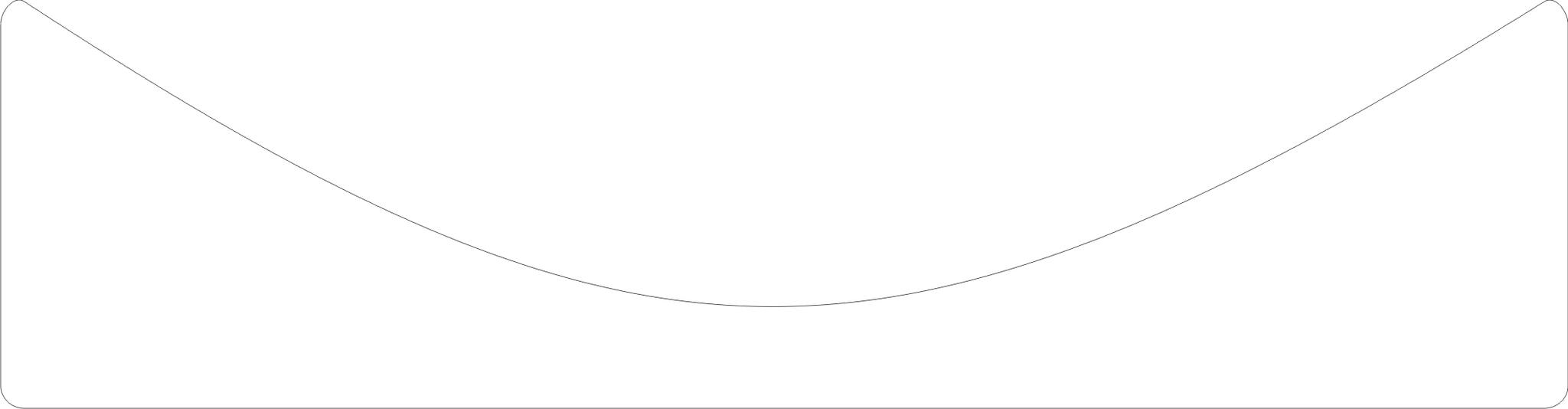

Is it possible, oval recess with sides that gently rise
Hi All
Sorry not been on for a while but have been flat out working.
Now I have a Question for anyone that might know if it is Possible to do.
For instance
A flat piece of wood 300x300x50mm
and i want to carve an oval recess in the middle , BUT the sides need to gently rise from the bottom to the top of the wood.
The software I am using is Cut3d/VcarvePro6/Coral Draw / Coral Paint and Vector art 3D and Mach3
or do I need to buy another software package to do this type of Pocketing .

Re: Is it possible, oval recess with sides that gently rise
Hi Mike
Yes you could do it with that type of tool but wouldnt that leave steps in the sides rather than a smooth gentle rising curve up
You need 3d CAM like Aspire and Ball nose router bit for this type of job. This is 3D not 2.5D job.
Does any of your software let you use depth maps ? that should be quite easy to do.
I take it you are wanting to make a platter/bowl/plate of some decscription ?
My mistake. You said you have Cut3d and i did not see it. You can use that if the object is made by some 3d CAD software and exported in STL, 3D DXF, 3DS, OBJ, WRL, LWO, V3M

Hi Mike
Yes I could do it that way but I dont think you would get the long sweeping sides rising to the top ,,but will have a go
Want2build1
I am not sure if any of the softwear I have has the depth map function as I have looked and not found it ,,,,any ideas where to find it Yes I am trying to do a weird shaped bowl and am wanting nice sweeping sides to it ...
Is there a software package that I could buy that would allow me to create my own designs and then mill it out ???

Hi Bud
Yes I can use that but cut3d will not let you design your own shape and I have over a thousand 3d models but not one unique one
that I could personalise.
I don't know about mach3, but linuxCNC lets you open a bitmap and cut it ?
My Cut3d lets me open a bitmap and ten run it through Mach3 But I was wondering what softwear is available to convert a picture and create a 3D relief out of it .....Any suggestions anyone ???
Pete
this is 3d depth map ...
petesos
Pete
I have done it and for sure it can be done using Photoshop. I am not sure if you can make it with Corel /Paint/ .
Basically you do this:
Workflow Technique #051 @Digital Outback Photo
Said in other words you make the image BW. Use a mask. Blur it. Then clean the blur where necessary using the mask. And invert it/ the BW/ if necessary to achieve what you want high or low.
There is 30day free trial, so you can play with it.
