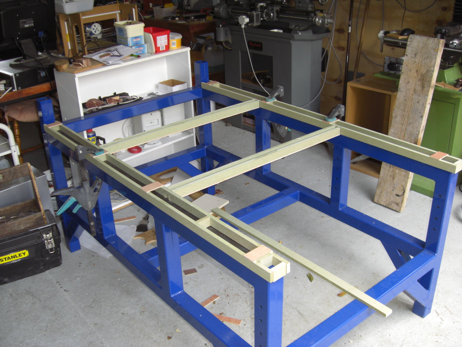

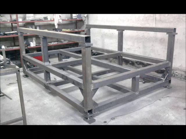

The base will be constructed from steel and be welded. The plan is to make the base no bigger than the width of a door opening. So the height of the base would be no greater than about 780mm. I don't need a lot of Z movement - max about 4 inches. 80mm x 80mm box section appears to be ample frame size.
At the planning stage I have decided upon 1 of 2 designs for the base.
Design 1 - I believe this is some chap on this forum
Attachment 10962
Design 2 - Has detachable top rails. Mine would not have such a Z axis movement and be a lot lower. I may extend the rails at one end thanks to JAZZCNC for this idea.
Attachment 10963
Design 2 is my favourite at the moment. Taking into account the length of my machine I would probably need 4 vertical supports instead of 3.
I would be interested to hear thoughts from others on this.
Bob
Very similar to what you have in mind I think ? but this one is just 1000 x 600 bed so about 1/4 size.
http://www.mycncuk.com/forums/router...html#post52425

Looking good there he says with envy.
That's a lot of steel and it must weigh a ton.
I will be following your thread closely.
Re: Planning and getting things together
bobhome
Probably about 100kg so not too bad.
On a larger machine I would have made the bed as a separate piece and maybe have the sides separate so they bolt onto end pieces.
Your frame is looking great Eddy. Well done, you now seem to be well on your way to having a very nice and well thought out machine. G.
