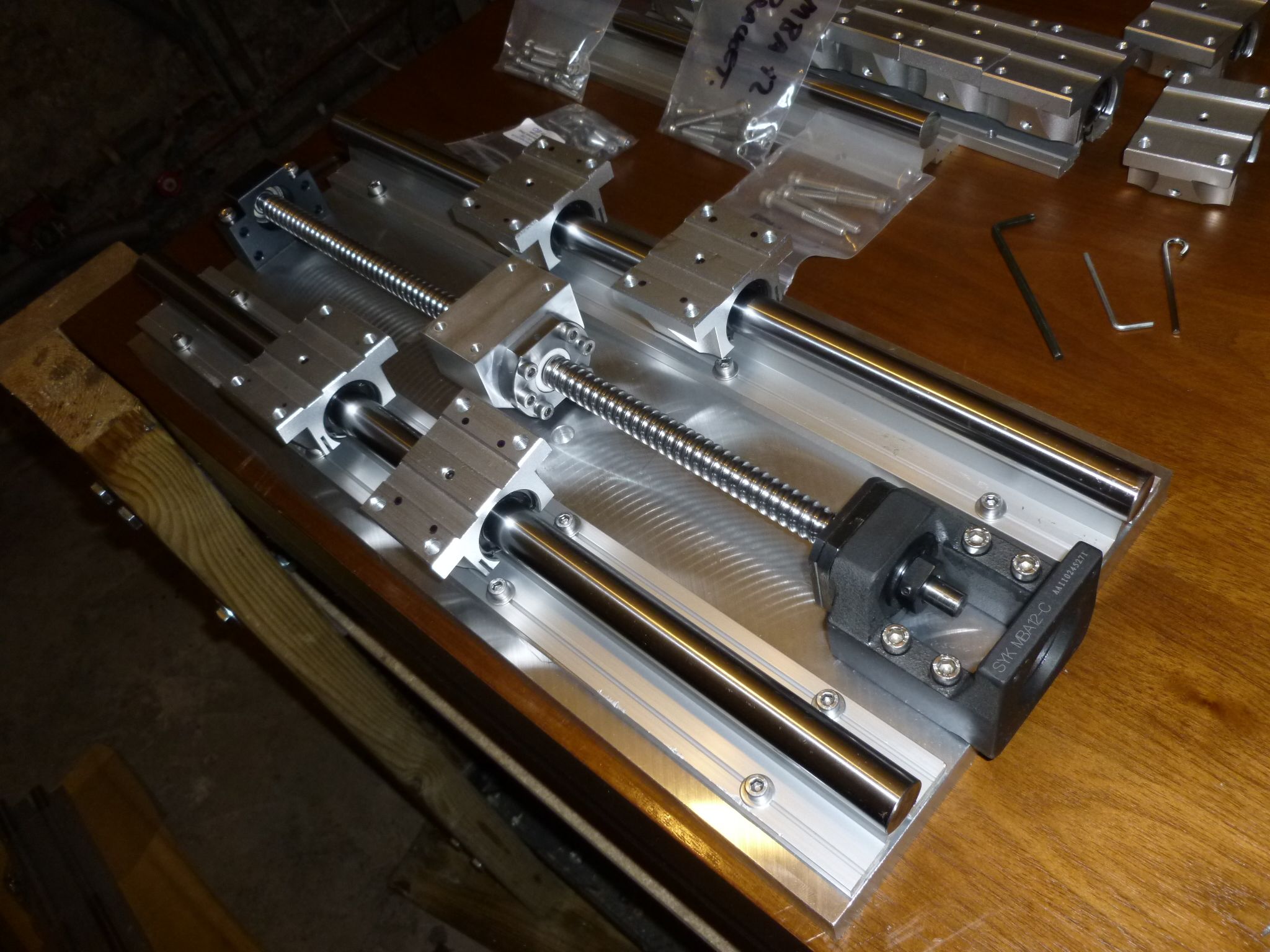

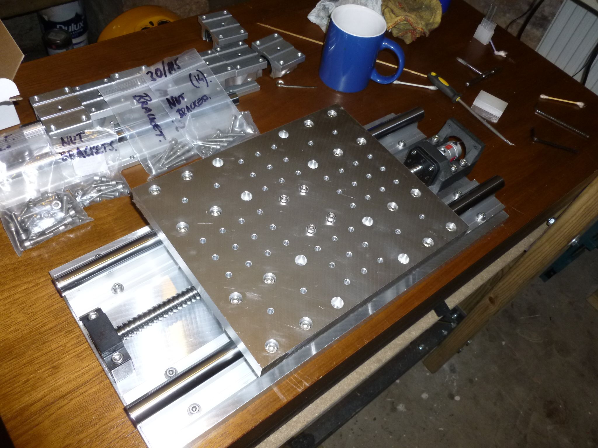

Hi all,
I've started my fixed gantry mini-mill build and so far so good. Here's a pic of my bare x-axis and one with the machine table loosely fitted.
Attachment 11015 Attachment 11016
It's a simple build made up of three linear stages, with the x riding on the y. Here's a 3D visualization:
http://youtu.be/2XRB4kylHHs
Looking ahead, I can see that I'm going to have a bit of a challenge when it comes time for me to square the rails on my x/y gantries.
I'm pretty confident that I can get each pair of rails running parallel, but I'm wondering if anyone has any suggestions on how I can ensure that the two sets of rails run perpendicular to each other.
I'm aware of the millkins script (which is an X-Y skew correction script) available from here:
LinuxCNC Documentation Wiki: ContributedComponents
but if I can get it close to start with, then that can only be a good thing.
Thanks for any advice!
Wal.

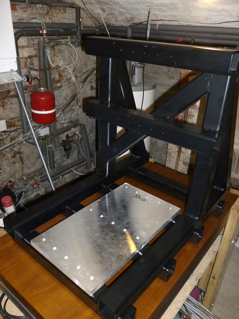

Picked up the (70Kg!) frame from the steel fabricator earlier today. A friend helped me get it into the basement - door and banister had to come off temporarily (and will now probably stay off for the foreseeable future as I devote all my time to putting it together - heh!). In theory I now have everything I need, just a case of tapping, assembling and squaring the beast..!
Attachment 11201
I feel a week off work is in order...
Wal.
Re: Seeking some practical squaring advice.
Looking good Wal, I don't think that will flex much :star: ..Clive
It's Dean's fault. I'm paranoid about deflection...!
Wal
Hey what.??? . . . . Don't be blaming me I had nothing to do with it you read into my posts what you will.!!!. . . To quote Manuel from faulty towers " I Know Nothing". . Lol
Just want to ask why you had that diagonal brace put so low down.? . . . . Looks to me like could be in the way if you have larger material on the bed or use a vice etc.?
JAZZCNC
That is a good point but I doubt it'll affect me too much. My work area is 30x20cm max and most of what I do will be smaller than that. If I need length I can go across but I can't conceive having to work on large bits of stock. Famous last words and all that - heh, this is just a mini-mill that's ended up a bit over-engineered!
