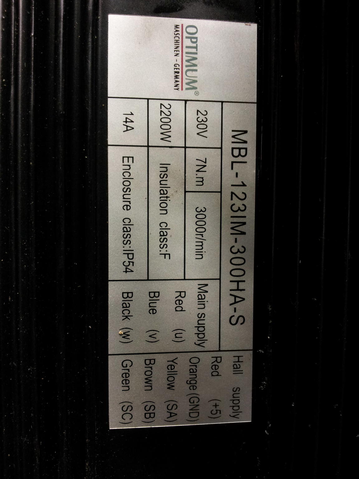

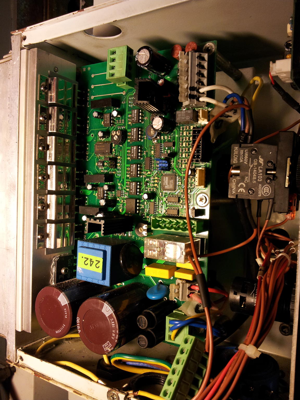

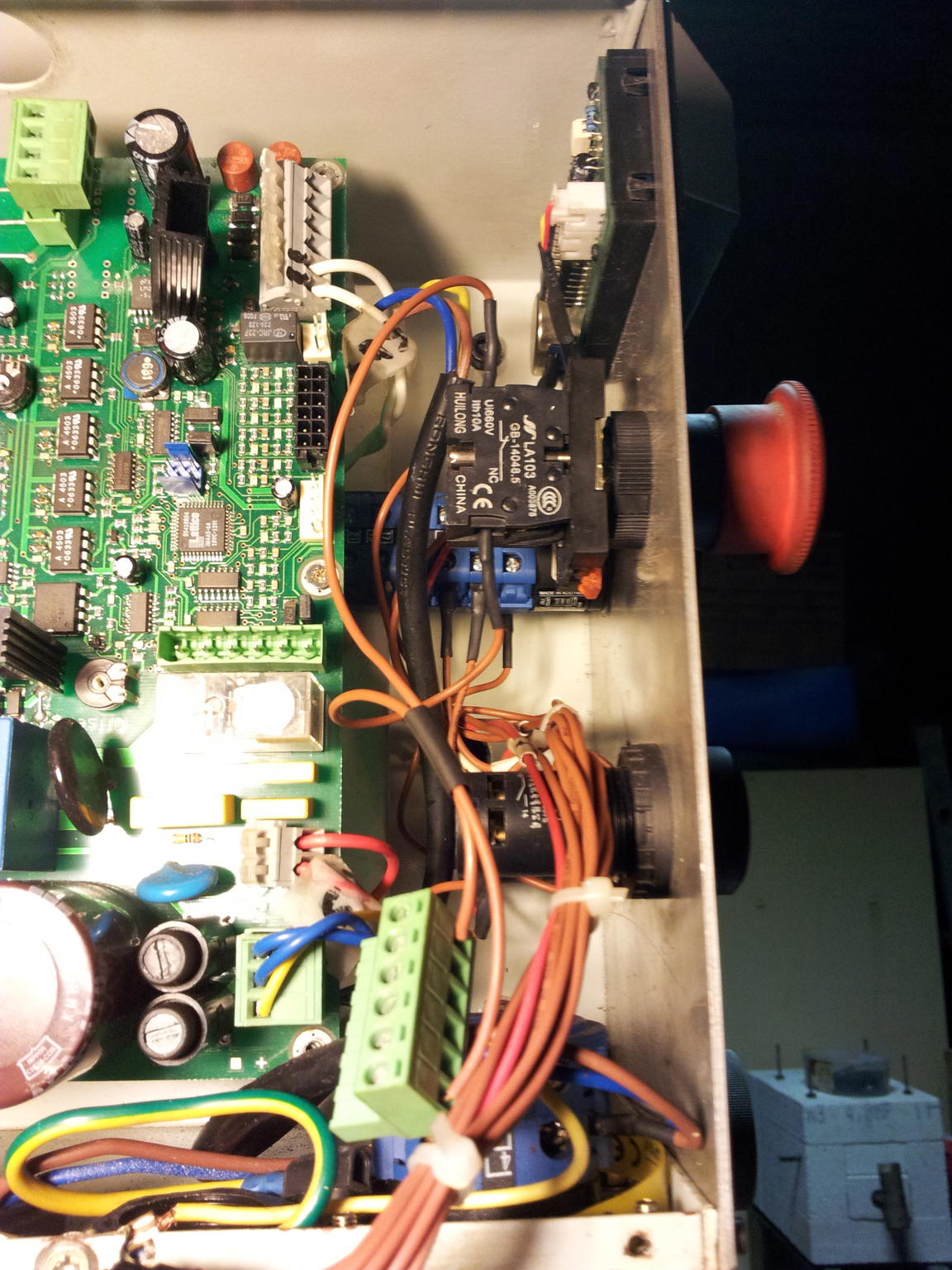

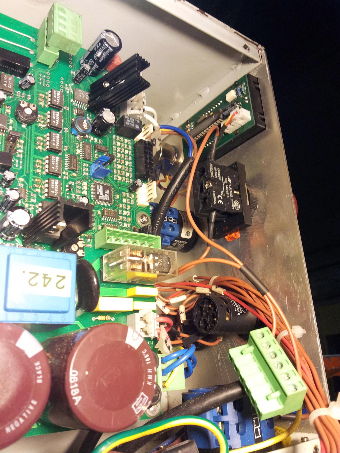

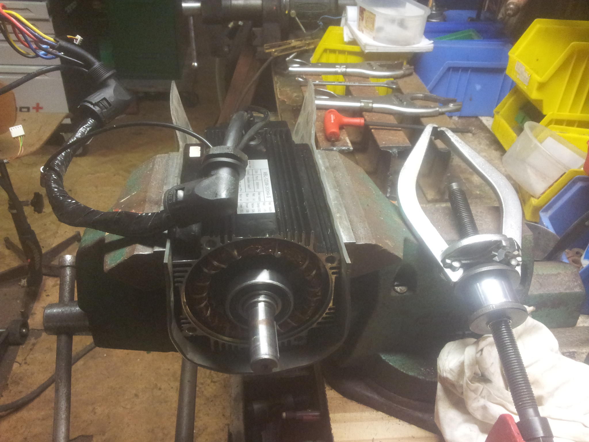

17 Attachment(s)
Re: Help for MOTOR 2.2 Kw and control board.

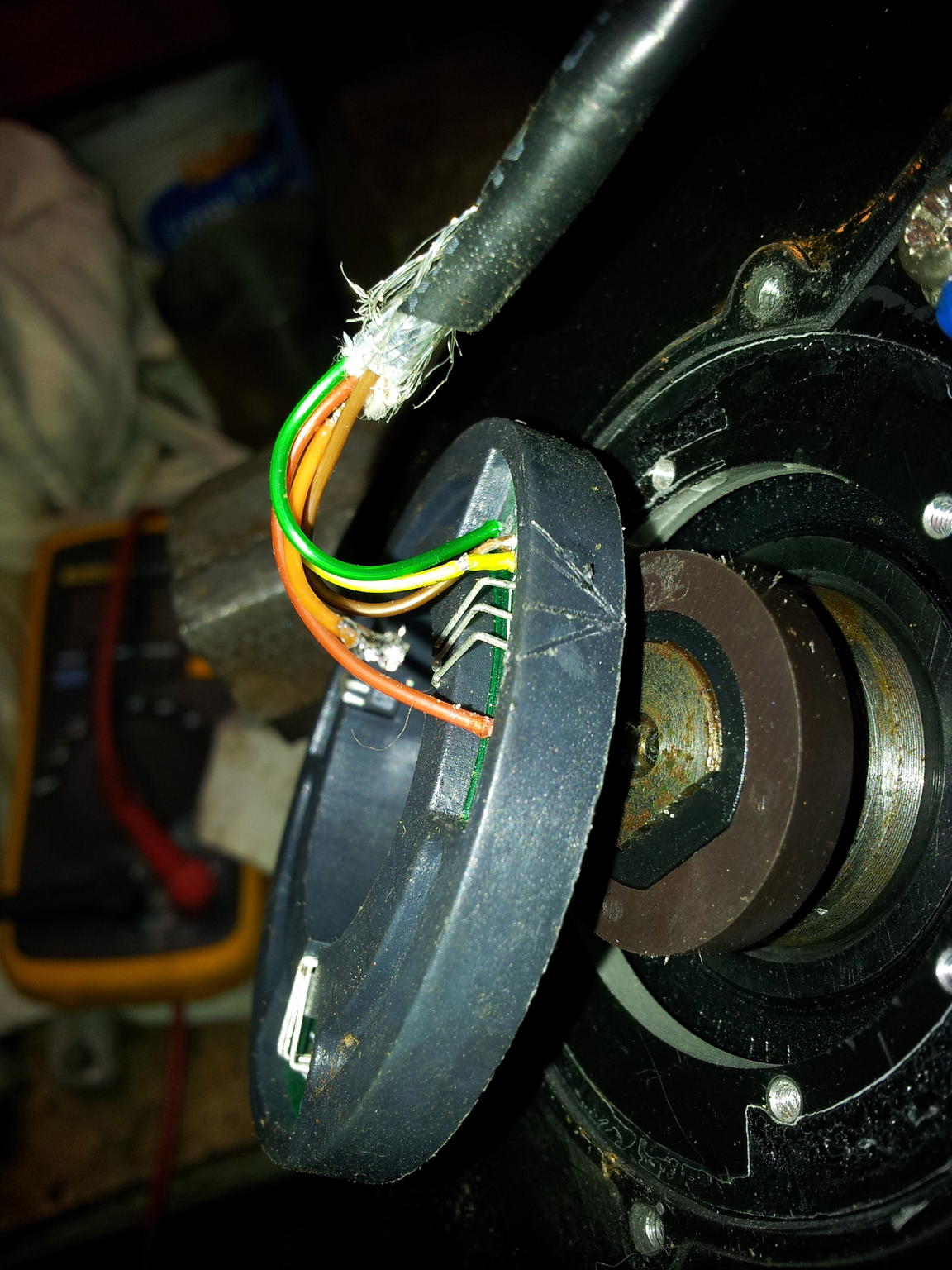

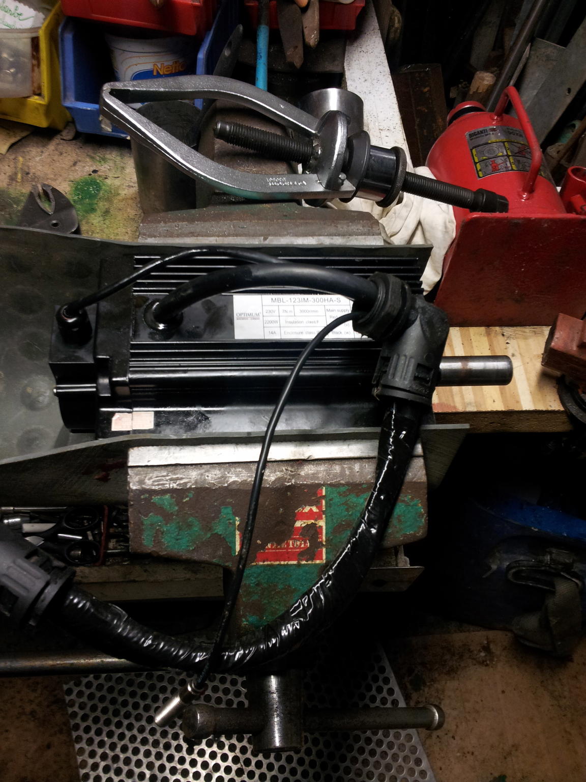

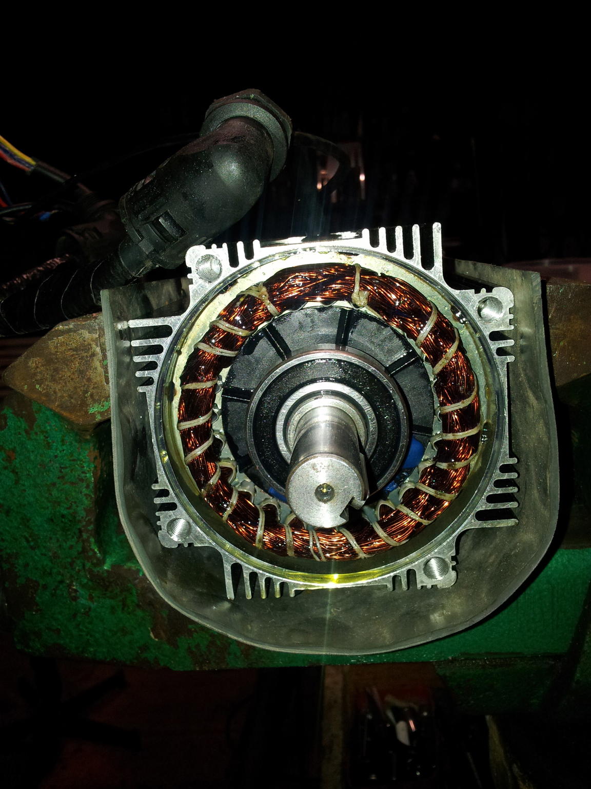

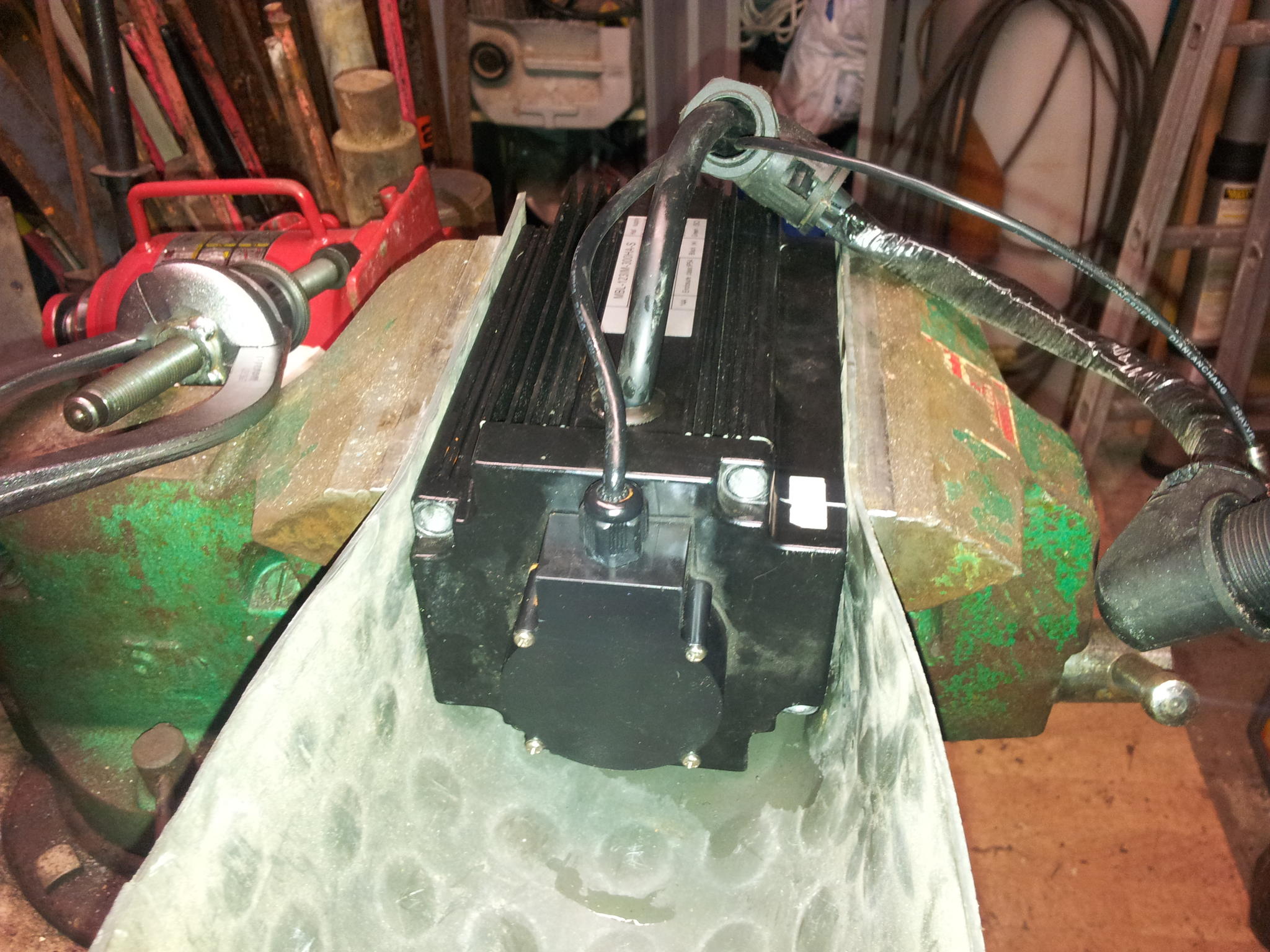

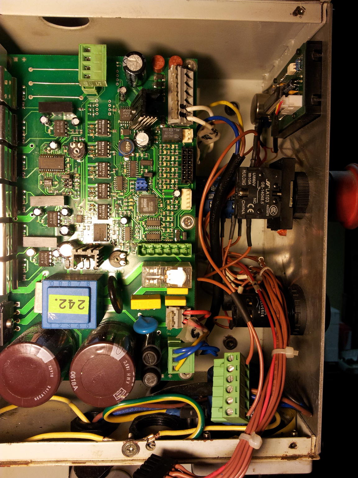

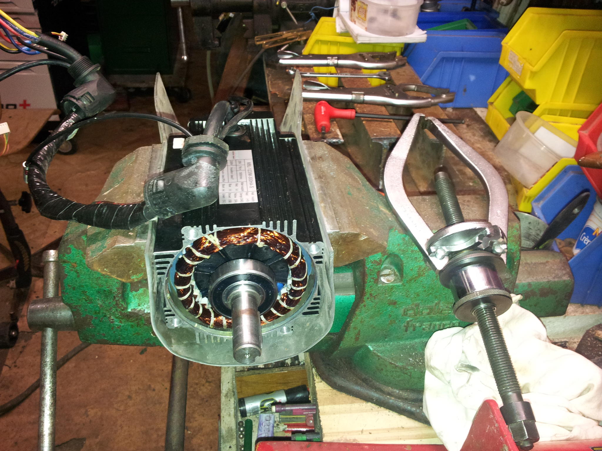

Thank you guys for your comments and brain storming's.
I got the motor out again and clamp it into a vise.
Eventually took some pics.
Oil seems to come from weak seals letting thru during horizontal transport.

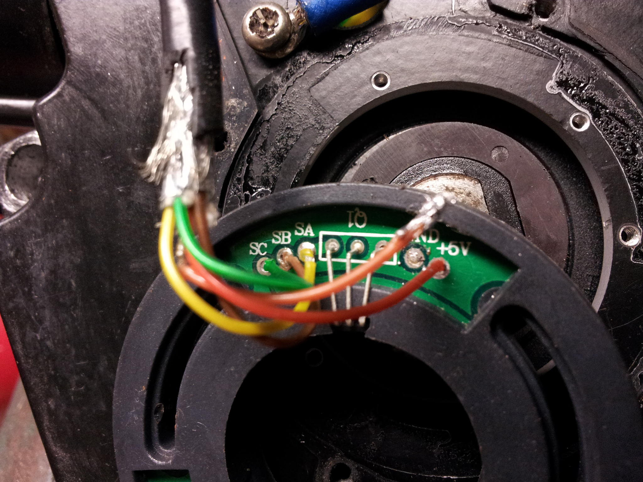

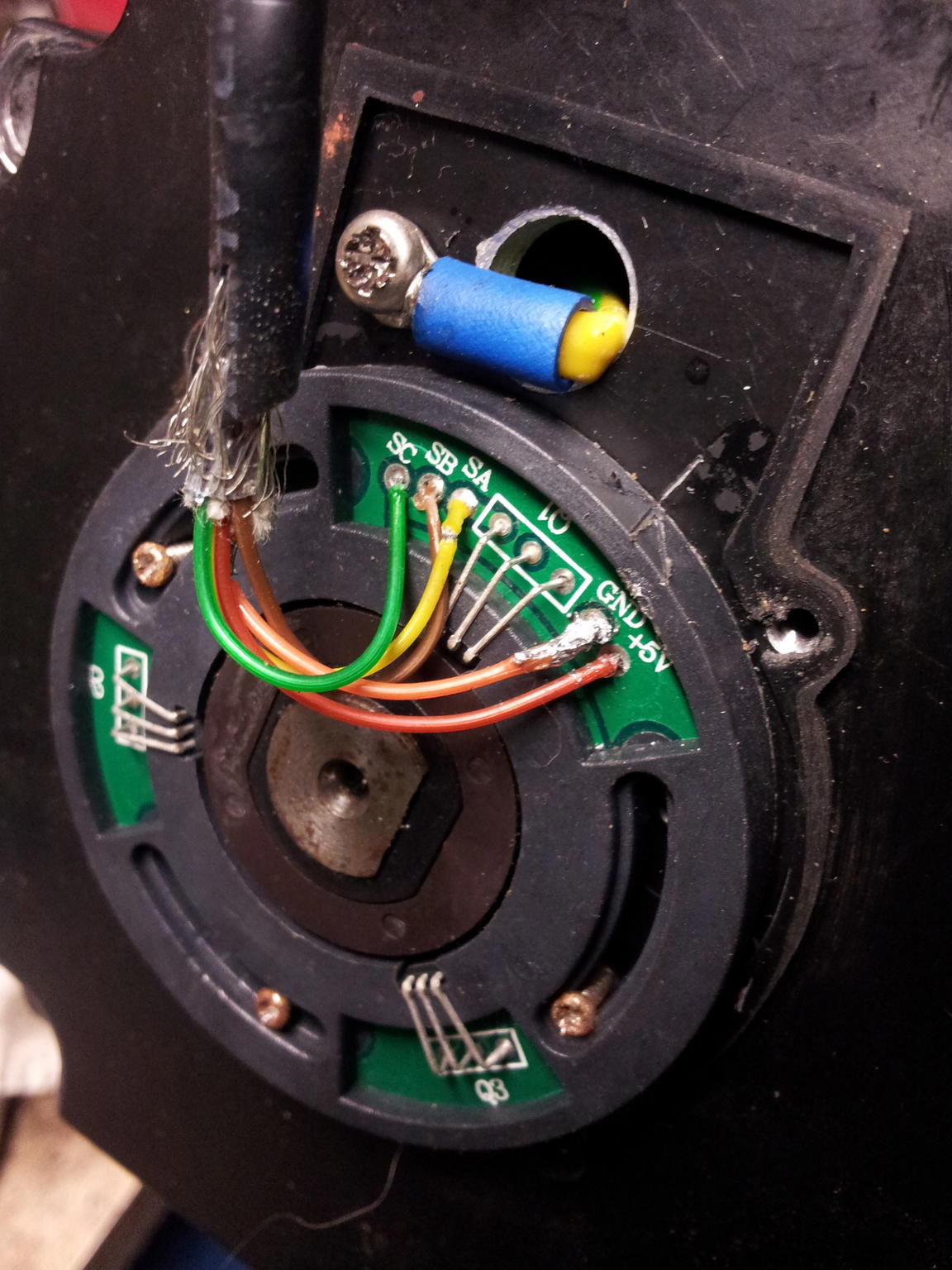

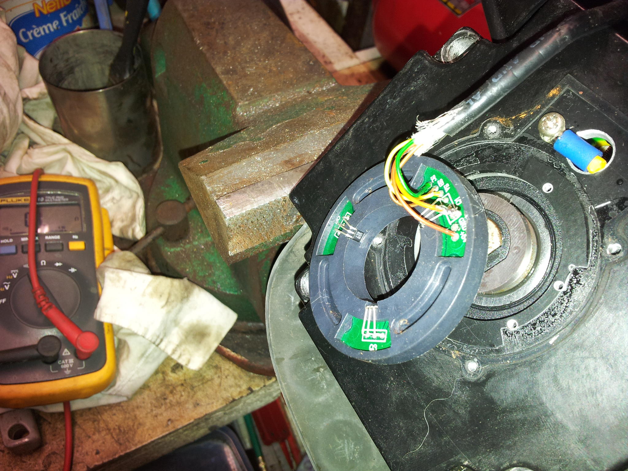

I found one tiny wire i had to sold again on the Hall sensor on top of motor ( inside top cap )
All wires are rigid and insulating plastic of bad quality.

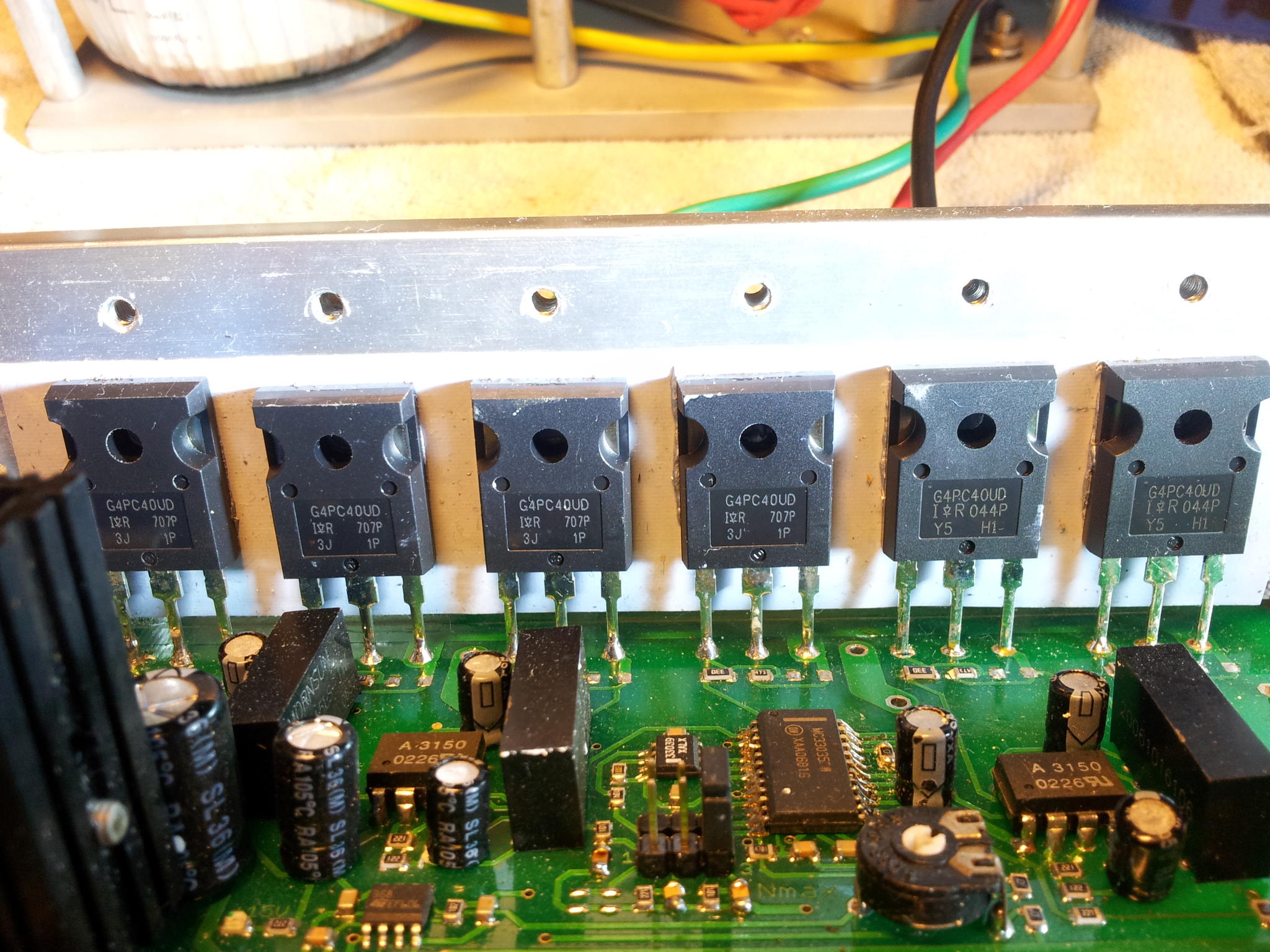

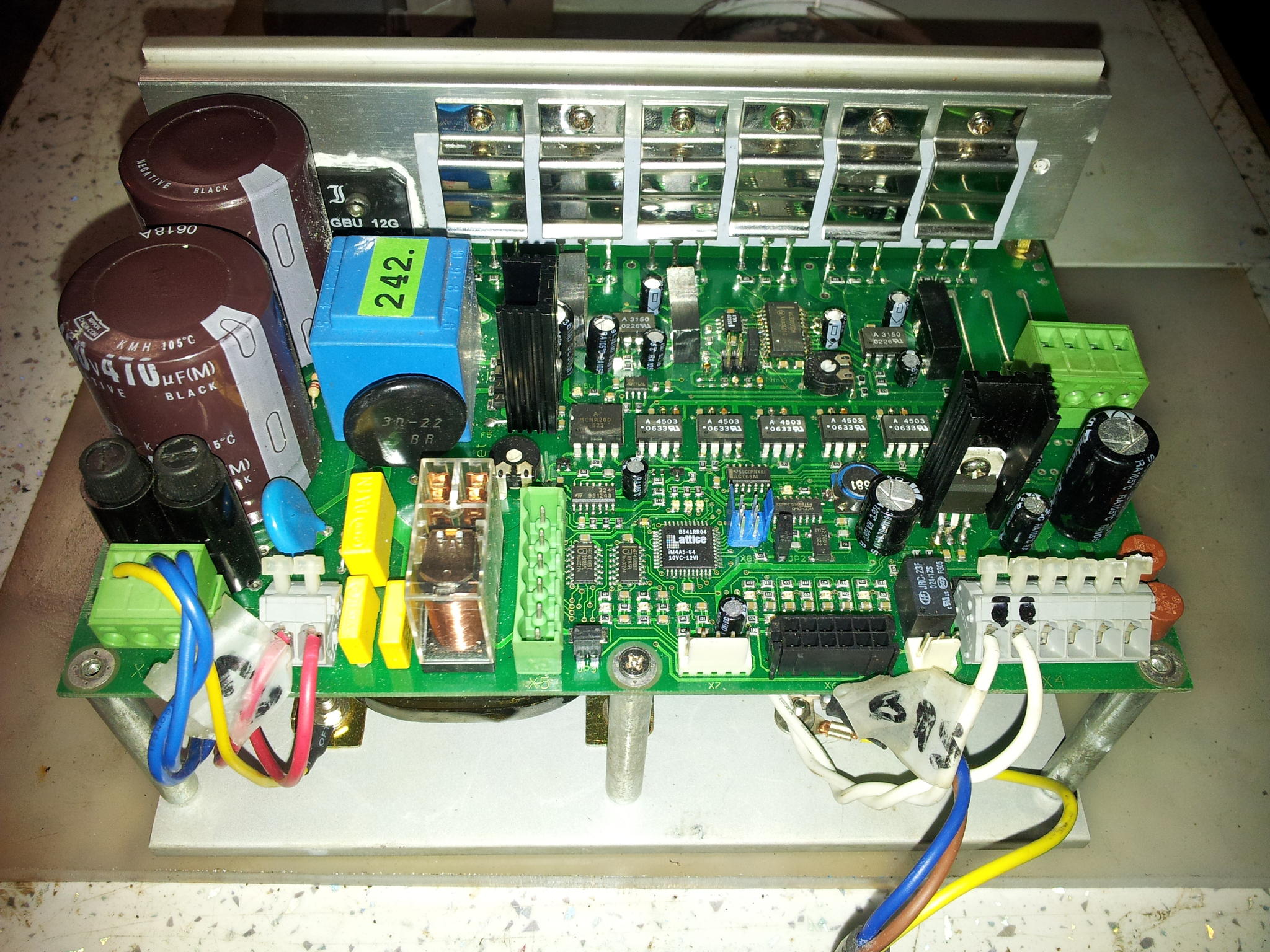

Observing the main control board, there are no hot points or burned points or inflated condensators, any other ideas for what to look for ?

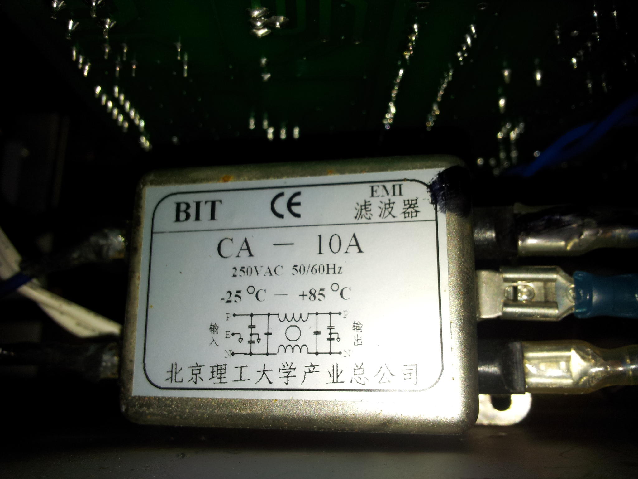

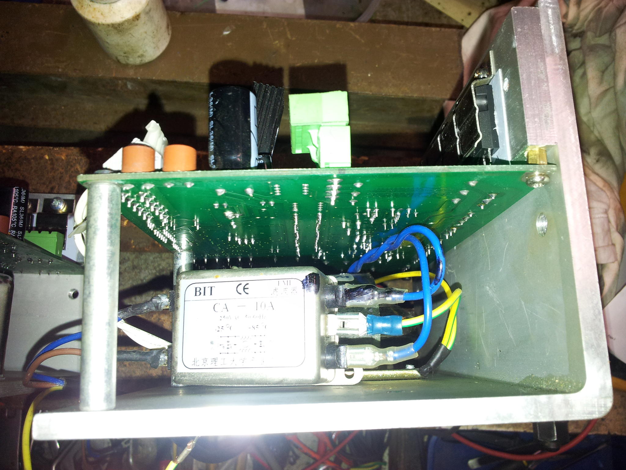

Another question : i can't figure out what is the metallic box under the main control board ? is it a rectifier ? it is sealed ( by soldering stuff ) and written in Chinese on top of it.
I would be happy to find out that the problem is there.... who knows ?
Attachment 11123Attachment 11125Attachment 11126Attachment 11127Attachment 11128Attachment 11129Attachment 11130Attachment 11131Attachment 11132Attachment 11133Attachment 11134Attachment 11135Attachment 11136Attachment 11137Attachment 11141Attachment 11144Attachment 11142
The metallic box in the last pic with the chinese writing is an EMI filter to stop interference & noise from the VFD getting back on the mains supply.
I was busy looking at the pictures when irving replied. The box is as he says a mains filter. If this was faulty it would cause the fuse in the supply plug to blow and not the ones on the control pcb.
You could remove the heatsink clamps from the six power transistors at the rear of the board and check to see if any of them look cracked or burnt. If the motor windings check out ok with your test meter you would need an insulation tester to further check for any insulation faults to other windings or ground.
Have you tried powering up the control pcb without the motor attached to see if it blows the fuses?

Didn't know about EMI filter !

I will remove the heatsink clamps this afternoon to see if any cracks/burnt appears.
Motor checks out OK ( as far as i know ... )

See the circuit board mounted on the end of the motor, make sure it goes back in exatly the same position. You can see it has slots to allow rotation.
If you are using a 500v Megger type insulation tester keep it well away from the same circuit board, only test at the windings (U, V, W), if it's just a multimeter that will not be a problem.
On the main board there is a white connector with 2 white wires going to it, beside it is a 3 leg component mounted on a small vertical heatsink, well the legs on that do not look good, it looks in fact like someone has changed it before. Maybe this is a component that blows often ?
There is a rectifier with GBU 12G written on it, this could also be causing the problem.

-1- Yes i ticked marks to position-back the rotary circuit on top of the motor, but yes i try to test everything on this circuit - including small Hall-effect tripods - is that deadly for them ( my multimeter is a FLUCKE, switched to BuzzerOhm-meter ) ?:apologetic:
-2- I suppose i have to de-solder the GBU12G to test it correct ?
-3- you are right as well for the 3 legs that look re-soldered : do i have to de-solder this component as well and how come is possible to test it ?

Question: the GND wire on the hall sensor pack that you had to resolder. Was that disconnected after the fault or did it become disconnected when you disassembled the motor?

How should i test this motor? Its same as motor allready shown here. Should i open it up and test Hall sensors?
There will probably be 3 main terminals, you should check the resistance between each one and they should all read the same.

Im attaching a picture for this PCB as future reference if someone will google this situation in future. Furthermore i will give discovered procedure for adjusting speed range. Pressing the lower button on small PCB you adjust the maximal speed with speed pot, and pressing the upper button you adjust the minimall allowed speed.

Hi all,
I've just created an account on this forum for DIY enthusiasts.
Sorry for BillyBoum, but i had identical issues with a BF30, of the same manufacturer.
IGBT burnt due to enclosed box, and, this is true, a layer of insulating material, between IGBT tabs and heatsinker !!!!!!!!!!!
DONT TRY TO REMOVE AND RESOLDER THESE PARTS, YOU'RE GOING TO GET SAME DISCREPRANCIES.
Sorry English guies, i'm not really fluent in your language, so i'm going to reply in French to BillyBoum.
Bonjour BillyBoum,
Comme indiqué ci dessus, tu dois avoir - je me permets de te tutoyer - les IGBT qui sont partis en fumée!!!!
En fait, le refroidissement est inexistant - boîte fermée - et les pattes supérieures des IGBT - le tab dans le contenu du dessus - sont isolées du radiateur, par une matière isolante...
La solution, c'est de refaire une carte de A-Z, ou de passer sur VFD et moteur monophasé ou tri de 2 Kw.
Bonne soirée quand même.
