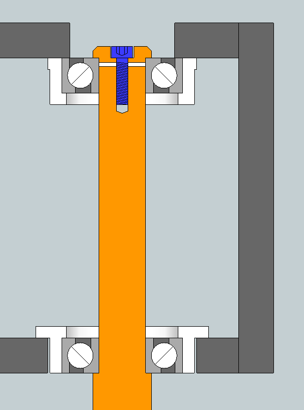

I've decided to ditch the double row AC + floating bearing approach and simply use two single row angular contact bearings mounted back to back:
Attachment 11185
Am I correct to think that the bearings need to be a slide fit on the shaft and a press fit in the housings? preload will be via top cap, with the mounting bolt torqued to ##Nm, not sure on the value though. That or I'll use a locknut with a side grub locking screw.
I'd like for this design to offer as much stiffness as possible, will it work, or is there something I'm missing?

The main thing is whatever bit gets adjusted floats.
However that drawing won't work. Tightening the screw will simply pull the inners towards each other and preload nothing!
You'll have to flip both bearings, which given your application, will probably be better in terms of where the main forces go...

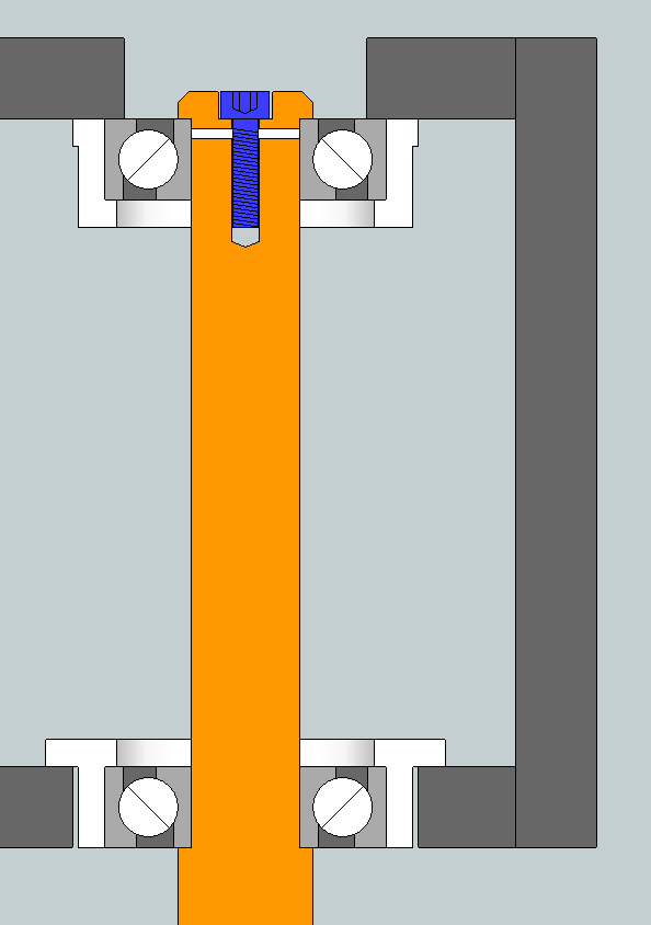

Indeed I've screwed up the lines showing the centers, so the above shows a face-to-face rather than back-to-back (I think). Re done here:
Attachment 11188
Original I had tapper rollers in the design, the issue with those was no seals. ACs offer seals as well, but the idea stays the same.

M_C beat me to it about wrong way around but I would also had that you'll want the locknut approach with locking grub screw rather than the just tightening a thread to a torque value.

One of the snags with separated bearings in that configuration, is that the preload will change if there is differential expansion between spindle and housing :concern:
Re: angular contact bearings - back to back, further apart
Jazz I do have a fancy SKF locknut with a grub screw (pricey little bugger) which I could use, the only issue is accessing the grub screw as it's on the side. The cap / bolt is easier, as I can bolt it up from the top, but proper preload doesn't guarantee the bolt staying where it should without threadlock (I think).
As for expansion John, I'm guessing you meant thermal expansion, which would force the housings further apart and increase the preload? this shouldn't be an issue as all the parts will stay close to room temperature all the time.
