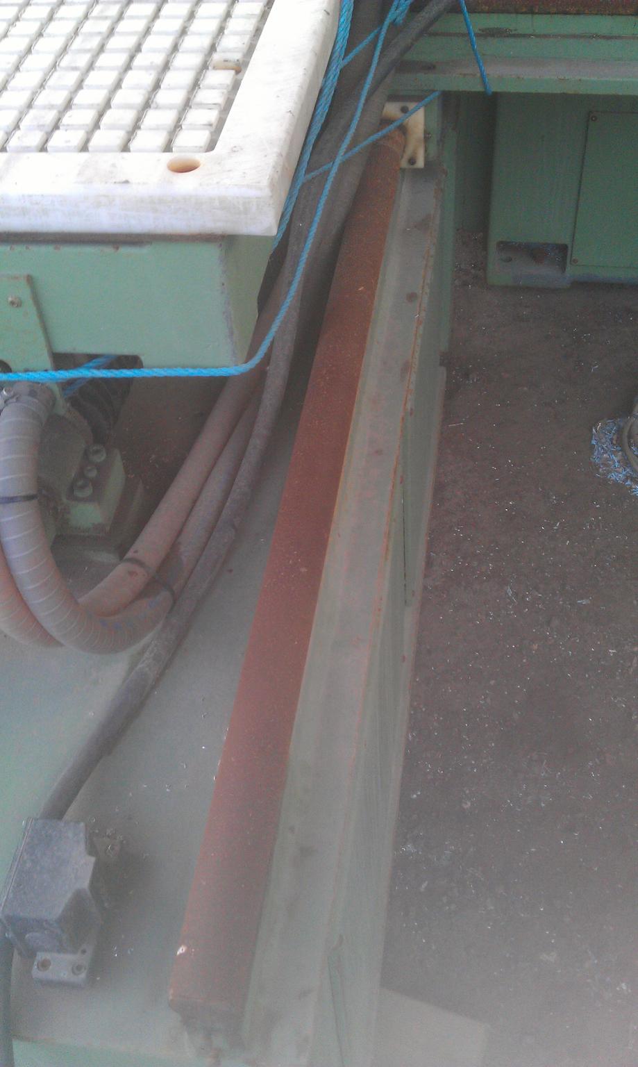

just got back
its been left outside ( undercover ) for a few months, could not test it powered, rails have some surface rust on, box with electics in looks fine, ITS HUGE, just trying to price up delivery before i consider an offer

well, i put a very good offer in and it was not acsepted, with them being scrap dealers not machine resellers, they have not realised it should have been kept inside, shame really, but the rails and baering and ballnuts have rusted, i would have took a risk with the electronics, but when absolutly everything needs replacing, its not worth it.
If anyone else was considering this, you need to go look before you put in an offer because it does not look the same as it does in the photos,

Attachment 11457hi just incase anyone was interested in buyin it, this are some of the pictures i took when i went to have a look, ITS NOT IN THE SAME CONDITION S IT LOOKS IN THE EBAY PHOTO, not by a long shot. its been left outside, shame
really annoys me when sellers do this on ebay, i have more pics if anyone needs them
