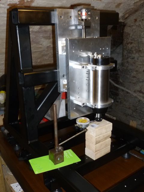

Hi all,
Yep, I know the right answer is zero, but with home-built machines I guess we need to be a little realistic.

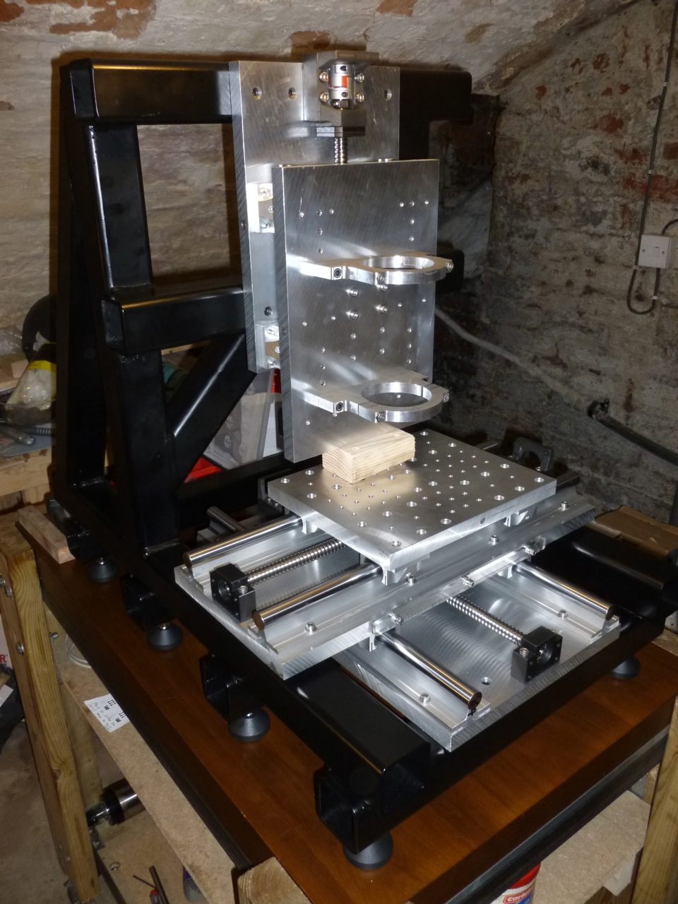

I mounted my z-axis yesterday, here it is:
Attachment 11262
No doubt it'll be on and off a few times more for shimming etc, but while I was at it, I torqued it all up and out of interest measured the deflection at the nose of the spindle with the z near it's downward limit. Pulling hard on the plate that the spindle is mounted to, my dial gauge read 0.05mm. Is that any good?
Vid here:
http://youtu.be/GJzGqhKwNSw
It's on TBR20 supported rails, how big an improvement would I see with profile rails?
Cheers!
Wal.
Nobody can answer that question Wal to many variables mate.!! . . . . . And Anygood for what.?
Edit: Thou I will say it's an order of magnitude better than others will be getting from machines they paid several G's for.!!
Re: How much deflection to expect...
It's a reasonably good starting point, but bear in mind this is only half the story as you need to add to this value the deflection between the bed and frame, for the same force.
If you want a less subjective answer, then measure the force you're applying and divide by the deflection. As a rough guide, if you get at least 1000N/mm stiffness you'll probably be fine for most things, but clearly it depends on what the cutting force and accuracy requirements are.

You'll be fine with those rails to start with. I'm not saying the rails aren't important, but it's the whole picture not just the rails that affects the overall stiffness and the rest of your design looks pretty strong (as it's a fixed gantry) so you'll get away with it. For example, I cut plenty of aluminium on my machine before changing the Z-axis rails to profile rails and didn't notice much difference from the profile rails as the weakest point lies elsewhere.
You can look at it another way which is if the machine stiffness is 1000N/mm, and you are cutting aluminium (guide figure 50N load), then you would see 0.05mm deflection at the tool (50/1000). This assumes a rigid tool (as your data was from the collet), and ignores resonances which would add slightly to the deflection in a difficult to calculate way.
If you can't be bothered with the maths - I just checked our kitchen scales (the flat digital type) and they go up to 5kg (50N). So if you have something similar handy use them to push against the collet until they read 5kg. If the DTI reads less than 0.05mm you are in business (>1000N/mm).

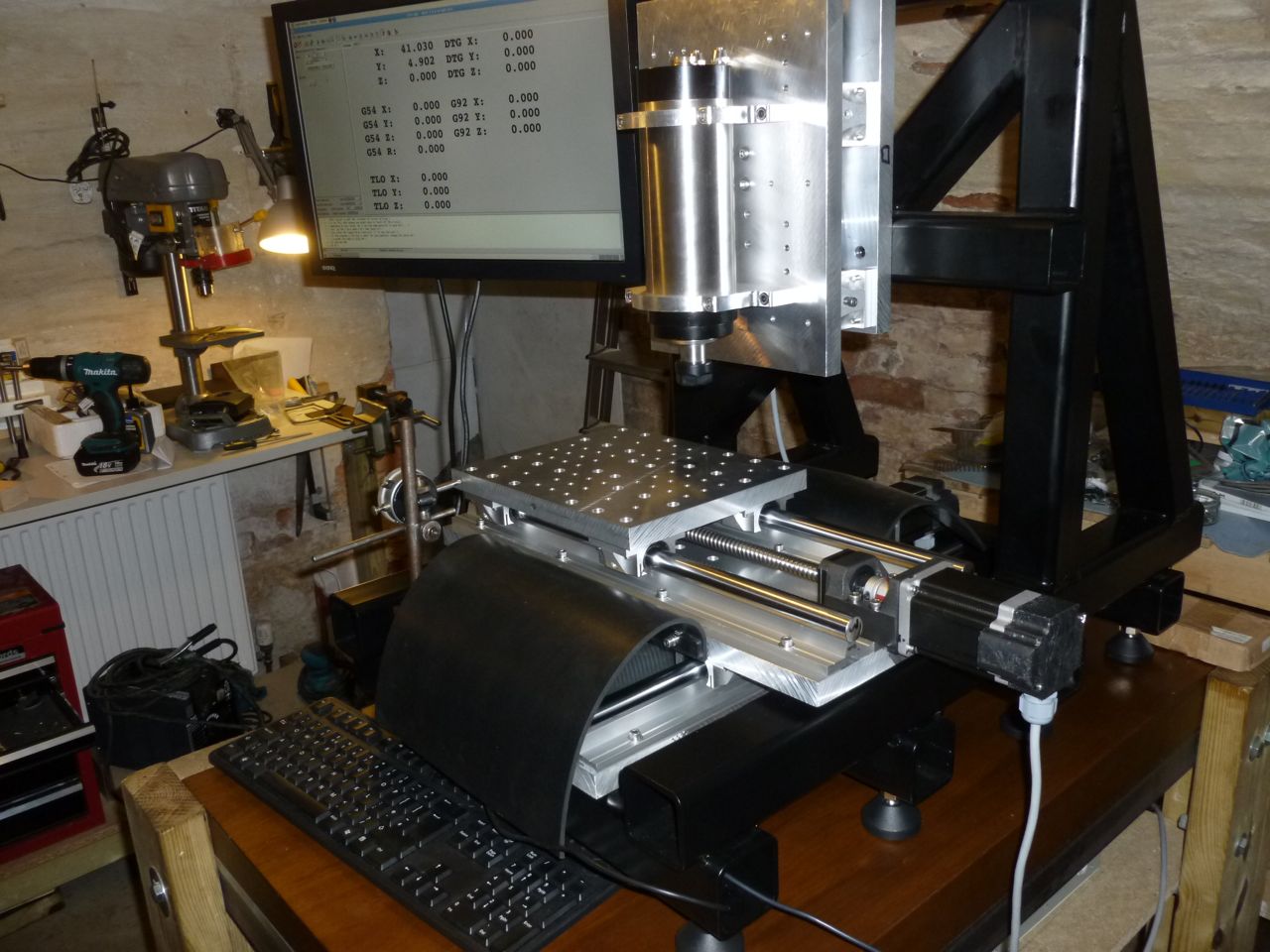

Anyway, today's progress:
Attachment 11272
All coming together reasonably well. I must say that I'm blown away by the minute measuring capabilities of some of these gauges. My dad's a retired engineer whose specialism was in measurement, he hasn't seen the machine and is pretty much bemused by what I'm building, heh - I guess you would be if you're used to measuring hydraulic gear to MOD tolerances... He's retired now and has given me a load of his old gauges, one of which is a Mahr with increments of .002mm - it's mad to see those otherwise imperceptible forces at work!
Anyway, one thing I will say at this stage is that the gantries move fairly smoothly without much effort when turning the screws by hand, although pushing the gantries around (back-feeding the screw) takes a fair bit of effort with a bit of binding towards the ends of the screw. I'm not entirely convinced on the quality/consistency of the screws from China. Pretty sure that the z-screw is slightly bent and I've noticed that the x ball-nut is a bit 'clicky'... Not going to get too anxious about it just yet, I'm keen to see how it all runs under power...

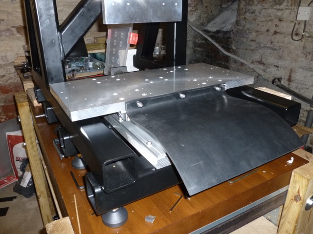

I think I overdid it on the thickness of the rubber aprons I'm hoping to fit to shield the running gear. 4mm is WAY too thick. I think 2mm should do it, even then it might run under the gantry, I'll have to experiment. If anyone has a spare bit of 2mm rubber sheet lying about...

routercnc
Good idea - I used 20kg hanging scales as they're exceptionally cheap on eBay and have a hook on the end which makes is easy to grab a bar/tool in the spindle to pull on. Do remember that, especially for a fixed gantry machine, we need to consider the stiffness of the bed.
You can think of the stiffness readings as spring constants, which can be combined as you would for springs. So in this situation you would have the same force applied to the spindle (i.e. Z-axis) and bed (i.e. X and Y axes), which is like having two springs in series - so to find the overall spring constant (i.e. stiffness), measure them both and use the following formula:
Then if . is greater than 1000N/mm, you're in business. Unfortunately you can't really simplify that, but if one of the stiffness readings is significantly lower than the other (say 10*), then you can just use that as the overall stiffness wont be affected much by the other one.
If it doesn't, you're doing something wrong.
Wal
That's normal.
Wal
Not good! That implies the bearings on either end of your ballscrew(s) are slightly misaligned, so they're applying significant radial force to the nut when the ballnut is near the ends, but not in the middle as the ballscrew itself will just bend. Try moving the nut to one end of the screw, loosen the bearing mount (so it self aligns), retighten carefully, then do the same at the other end. You can also try leaving the bearing fixed and loosening the ballnut mount.
Do it now.. it's the sort of thing that you'll get away with for a while, but will cause problems soon enough as it prematurely wears the bearings/nut.
Wal
I'd look into that sooner rather than later, before it's too late. If you dismantle the ballnut you'll probably find there's a ball in the wrong track, or bits of swarf in it. I've had that problem with new nuts more than once.

An update from the last couple of days, although I guess I ought to start a new build thread really - going a bit OT. I'll make it quick:
- Flipped the rubber - the protective flaps are working now - they look a bit kooky, but so long as they keep the worst off, I'm happy. Will also fit 'em to the table to protect X-running gear.
- Motors mounted and wired in (thanks to Clive S for the covers!)
- Monitor mounted to the frame and PC installed. Really nice having the DRO right next to the work-area.
- All gantries moving, a quick check of run-out along table X shows .07mm - the majority of which happens towards where the hint of binding was showing up - I'll whip the rails off and make sure there aren't any high-points.
All in all coming along quite nicely, still unconvinced by the clicky ball-nuts - I take it that they come pre-greased? Or should I squirt a bit more in..?
