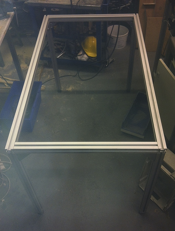

I lashed together a frame today today to get a grip for the size I can build...
http://www.davekearley.co.uk/LinkPics/CNC1.JPG
Its about 4'6" x 2'6"
im thinking of mounting some 75x6mm steel along the long sides to use as guide rail for the gantry carriages, I'm driving it from both sides so the carriages can be quite small, will be using T5 belt and sprockets to drive the gantry with a cross-shaft along the short edge.

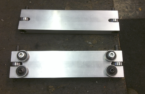

Here's the reduced frame with side tracks fitted...
http://www.davekearley.co.uk/LinkPics/CNC2.JPG
And the two Y-axis trolleys...
Attachment 11306
Coming along nicely.

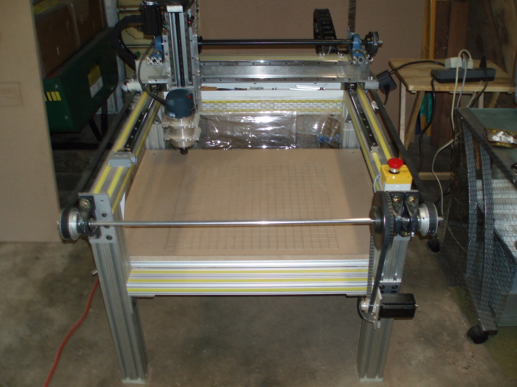

Re: Plasma table build, first question....
As it would be only plasma machine, you could go light and simple on everything. Take a look at the ebay kits they sell and improvise. The Proma kit they sell at they web also. I pointed it to you as the second piece is the Z driver and will simplify things even further if you have not bought the drivers for the motors. Look at his simple Z axis.
it not my machine, cause the part i want to show you is hidden inside, so i can not make photo of it but that's what i meant for clocking the gantry belts:
Attachment 11344
that is good idea for simple Z DIY CNC Plasma cutter axis rail car for nema 23 stepper motors | eBay
If i were at this point where you are, i would buy a 1 second hand wide type square rail with bearing block or two for around 100-200eur shipped to you from ebay for the gantry, as it will be far better than the other solutions. This wider type of rail will hold a very light z perfectly, move it fast and precisely and simplify a lot the build.
something like this LAW21EL+710-2 Linear Bearing 1Rail 2Block NSK Used Wide type K1 lubricate seal | eBay
That picture is almost identical to what I have built :)

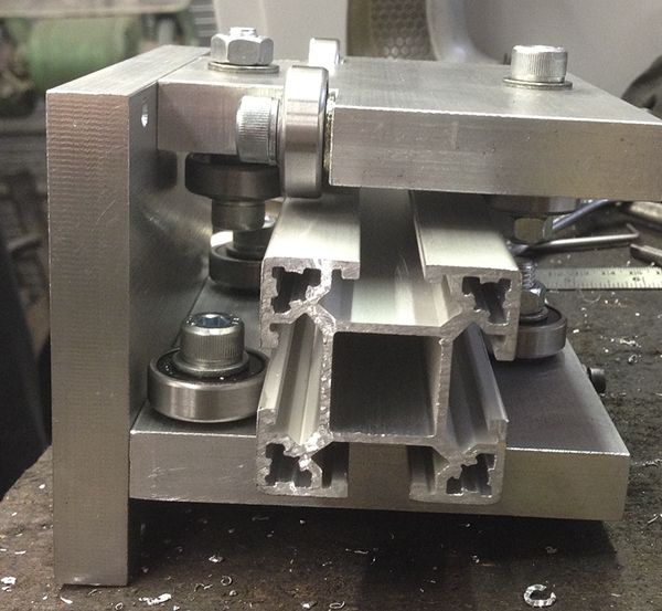

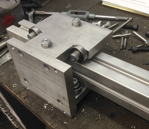

Made the X-axis trolley today, came out lovely...
Attachment 11366
Attachment 11367
The motion is smooth as silk and no twist or slack at all, very happy with that. The front plate is drilled for the motorised Z axis I have already waiting.

Steel bearings running on ali profile? Smooth now but that profile will wear; maybe not as fast on a plasma m/c as no cutting forces but eventually you'll find 'loose' sections...
Yeah I know, but I have a mountain of the stuff :) and it's not going to see production use so we'll see how it goes.
maybe the mk2 will have a steel gantry and welded frame, who knows.
It could be good idea to fashion some kind of cleaning brushes in front of the bearings, or a sponge.
That's possible, maybe some draught-excluder brush stuff.
