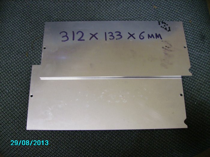

I have some im getting rid of, all offcuts and new material if you still need any. Its 6062 plate and the most common machining grade. Please feel free to pm me.
Kind regards
Attachment 11502
