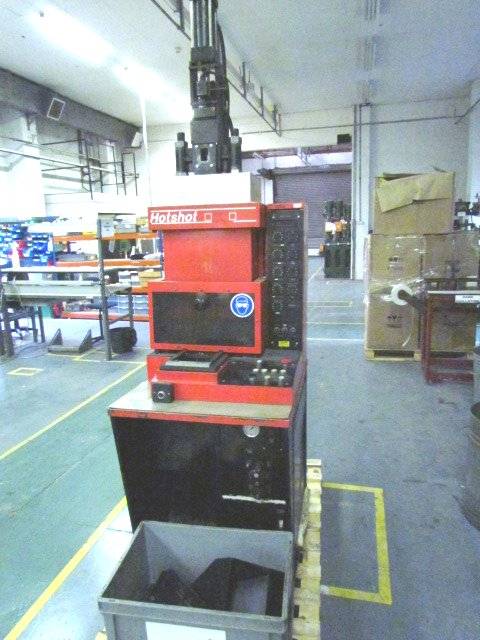

Attachment 11559
ive just bought a moulder identical to one in the image blind.. 100 notes.. it has an oil pump issue and its 3 phase.. in the event its too much to fix and i cant use an inverter it should make a good donor
Re: threading ground bar ends
Nice buy!
Definetly won't work of a standard inverter though, as a standard inverter won't be capable of powering the heating coils.
You'd need to look into a rotary converter if the heating coils run of 415V 3 phase.
Any idea the KW rating of the heaters are?

im not sure yet m-c ,driving up there tommorrow to give it a once over and arrange delivery be a shame to break it up but i dont have 3 phase.i will get the particulars tommorrow

Nice find Deisel look like a perfect small scale moulder. Looks like that thin can apply a fair bit of pressure if it is using hydraulics
gavztheouch
ive passed on it gav,i just got back from there,its a nice bit of kit but the images regarding size are a little deceiving thing stands about 8 ft tall an heavy,too tall for my shed and a fair lump to get from the road to the top of my yard.
it is too good to break everything powers up .
so if anyones interested there just off the M1 NOTTS and will deliver at a 1 a mile.pm for details.

I did wonder just how big it was.
Did you get a look at any power requirements for it?
i didnt m_c ,didnt want to waste anymore of there time with them running a business
No problem.
I'm trying to avoid buying any new projects just now, so it's probably for the best!
