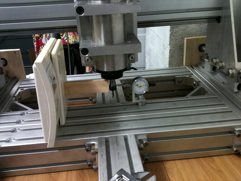

I've been making some stiffness measurements of my machine - build thread here:
http://www.mycncuk.com/forums/gantry...ercnc_mk3.html
Initial basic measurements were made as follows:
Y axis jogged to centre of gantry (worst case)
X axis jogged away from home, position arbitrary
Z axis lowered 50mm from home position, in a typical machining position
DTI clamped to bed with probe touching round section of collet nut (just above the flats)
Force of 50N applied (5kg) by hand using digital kitchen scales - guide figure for machining aluminium
DTI reading taken

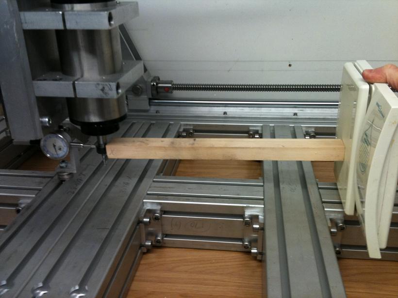

X direction:
Attachment 11575

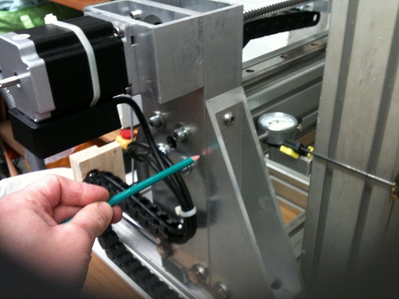

Y direction:
Attachment 11576

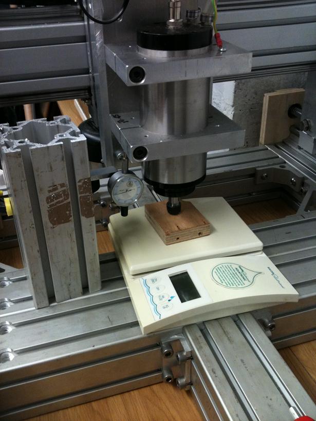

Z direction:
Attachment 11577
(although this photo looks like I jogged the machine onto the scales I did not do that - I pushed the scales up into the collet to take the DTI reading)
For the X direction I applied 50N and measured a deflection of 0.04mm. Stiffness is then calculated from 50/0.04 which is 1250N/mm. The other axes were calculated the same way and were:
X 1250N/mm
Y 1000N/mm
Z 2450N/mm
I was hoping for at least 1000N/mm to give 50N load and 0.05mm deflection during aluminium machining (simplistically).

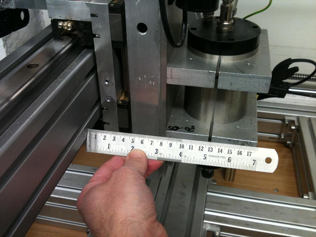

So exploring the Y axis stiffness in more detail I took measurements at various distances on the Y/Z axis components, starting at the tool location and working back to the gantry centre. In this way I could plot the loss of stiffness from the machine gantry all the way out to the tool location. These results are below, with a photo showing a ruler to help you see where the measurements were collected on the machine.
Attachment 11578
Y axis plate, distance from gantry face 10mm, stiffness 5000N/mm
Z axis rail, distance from gantry face 32mm, stiffness 3333N/mm
Z plate, distance from gantry face 55mm, stiffness 2500N/mm
Tool Centre, distance from gantry face 130mm, stiffness 1000N/mm
These were taken along a line shown by the ruler.
You can see that the stiffness quickly drops off as you move towards the tool centre, and the importance of minimising the distance and maximising the design at the concept stage.

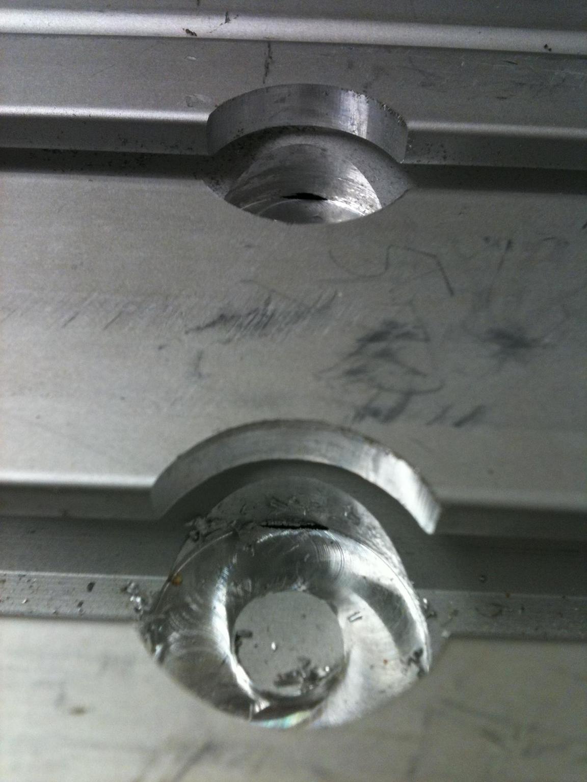

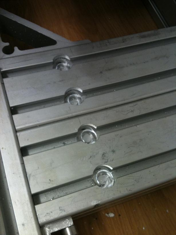

. . . .Can you relate the stiffness numbers you have obtained to actual cutting speed, DOC, surface finish, etc, results?

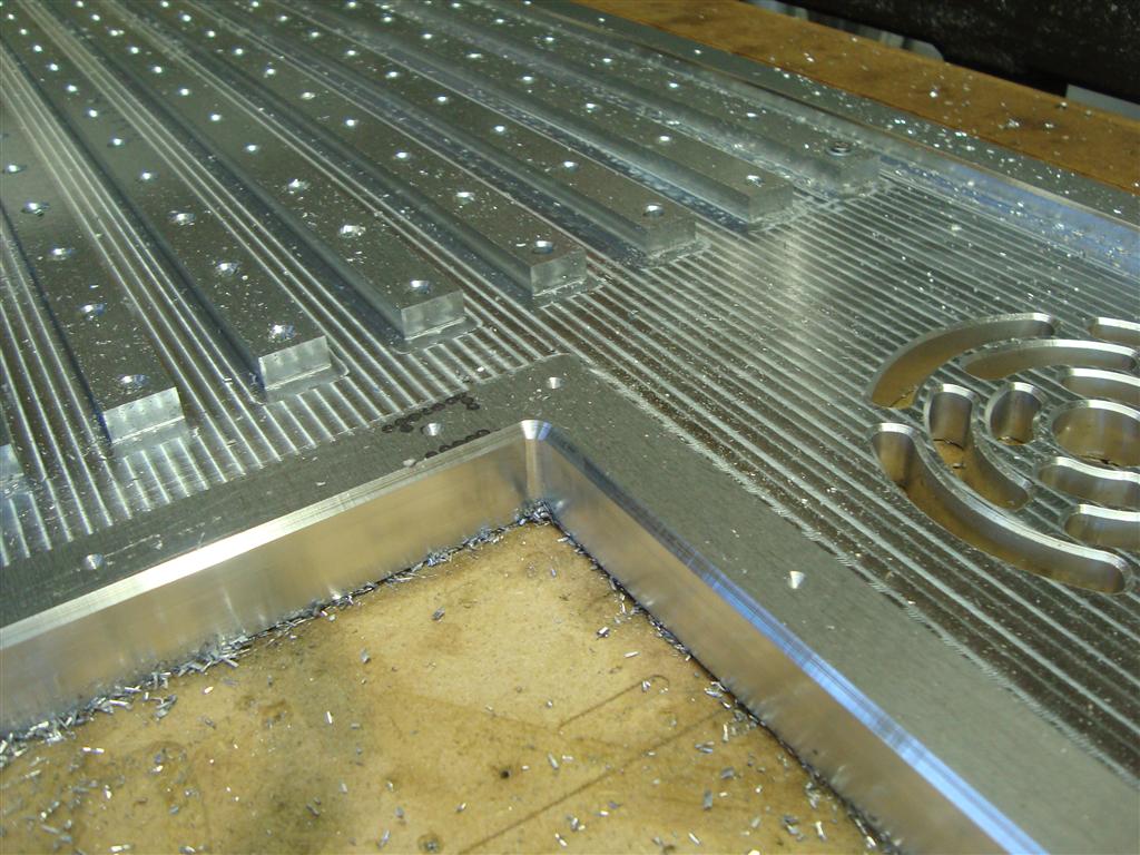

I'm still playing around with DOC, F&S, but here are some photos of holes I cut in the bed to allow nuts to be added for clamping things down. Finish is not too bad - you can see the finish on the sides of the hole, and at the bottom of the hole.
Attachment 11681
Attachment 11682

3 Attachment(s)
Re: stiffness measurements cnc mk3
Hi Neale,
Neale
However, it's difficult to know where "acceptable" is on that kind of scale, which is why seeing some measured numbers helps. Is your machine currently usable? Can you relate the stiffness numbers you have obtained to actual cutting speed, DOC, surface finish, etc, results?
I've been cutting out a few 20mm thick upgrade parts (will post in the build log soon) and have taken some photos of the edges of one of them. These were cut using the following:
6mm carbide 2 flute
1.0mm DOC
600mm/min feedrate
occasional spray of duckoil
cutting in the X direction
(there was a fair bit of what sounds like cutter resonance in this direction)
Attachment 12242
cutting in the Y direction
(much less chatter/resonance sounds in this direction)
Attachment 12241
My X & Y axes are currently 1000N/mm and 1250N/mm respectively at 50mm Z extension (measured on the collet nut). But these parts were cut at a longer reach, closer to 100mm as they were almost on the bed so the actual stiffness for these cuts would be lower.
I don't have an airline at home so can't clear the cutter path and suspect some of marks are chip re-cutting damage. But some look like cutter resonance as they are so regular. This suggests if you regularly want to cut a lot of aluminium, and want a nice finish, then you need a stiffer machine than my mk3 machine, perhaps more like 2000-3000N/mm in X&Y @ 50mm Z.
For the latest part, the Z axis motor mount plate, I followed the cutter with the workshop vacuum cleaner to remove as many chips as possible and got a better finish in terms of surface nicks etc. It's better but the resonance type stripes are still present although in this photo you can't see them that well. Here is the start of the job pocketing for the stepper motor:
Attachment 12243
Hope this helps.

Hi Jonathan,
If you look at the last photo in post 19 you can see that I generally use an 18mm piece of chipboard if I need to cut all the way through. The part I cut out in the last photo does actually have a better finish than the parts in the first 2 photos - possibly because it is cut out of a much larger sheet.
If you look at the bed you can see gaps between the profile sections used to make up to bed. The machine is used primarily for cutting wood and in that mode it has a large sacrificial wooden sheet which sits on the bed. This works well for wood machining.
If I end up doing a lot more aluminium I can see that I may need to either add a lot more profile sections to give less gaps, or invest in a large thick aluminium sheet to bolt to the bed, skim it, drill and tap lots of holes.
I'll keep experimenting with F&S as I machine out more upgrade parts, plus try some with a finishing pass.
