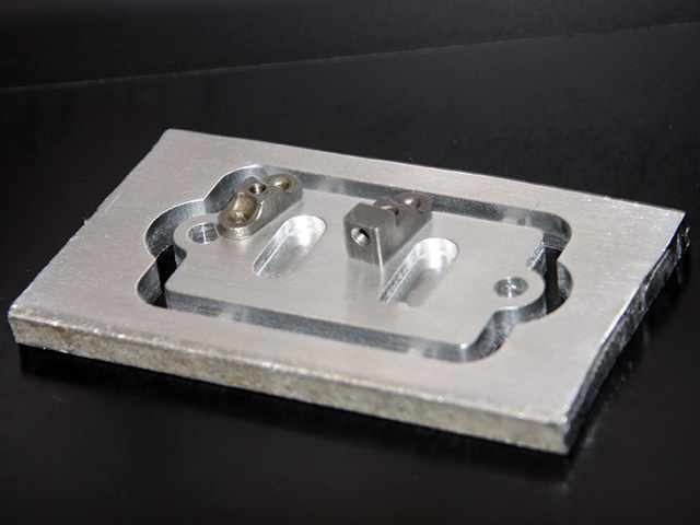

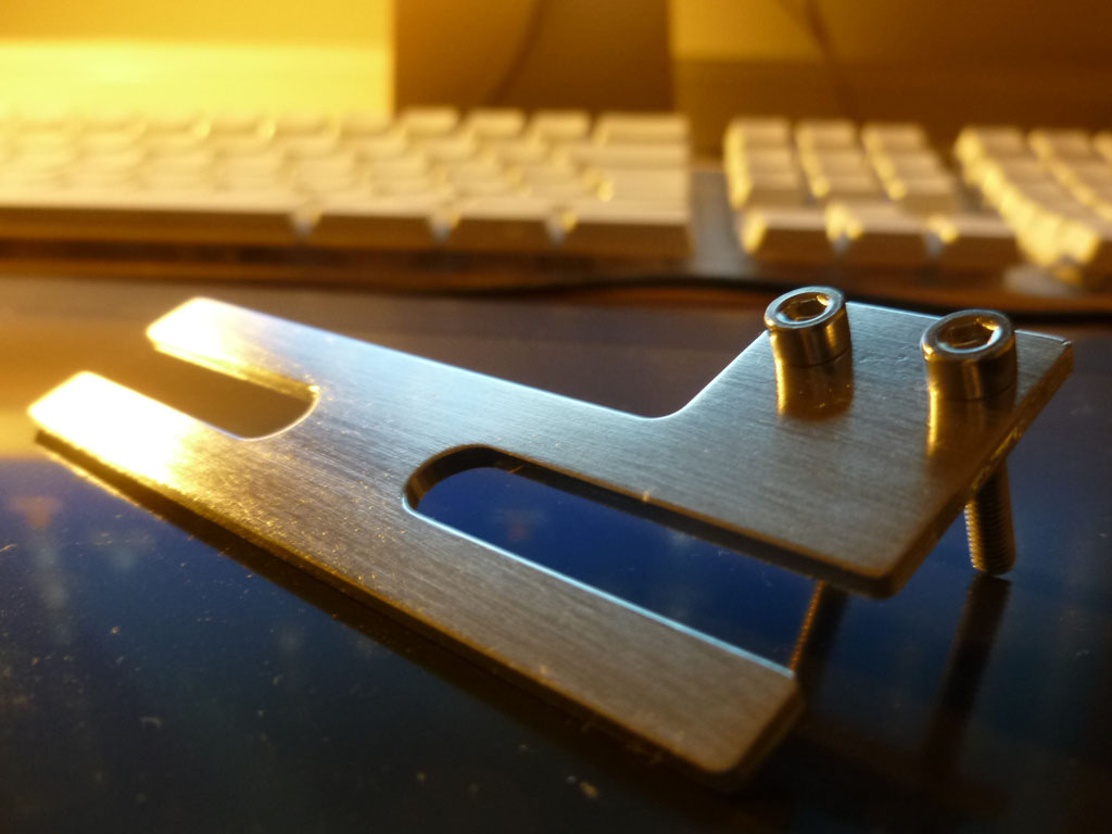

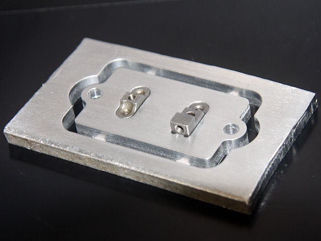

Great stuff ! , regarding the switch mount, how did you get that nice rounded edge around the perimeter ?
Re: First couple of parts...
EddyCurrent
Wal,
That's just a by-product of the once over with the wire wool, I think... The metal was pretty soft..!

Well done Wal. It must give you a great sense of satisfaction. Design a machine, build it and then start to produce meaningful work with it.WOW. G.

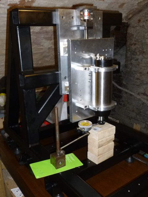

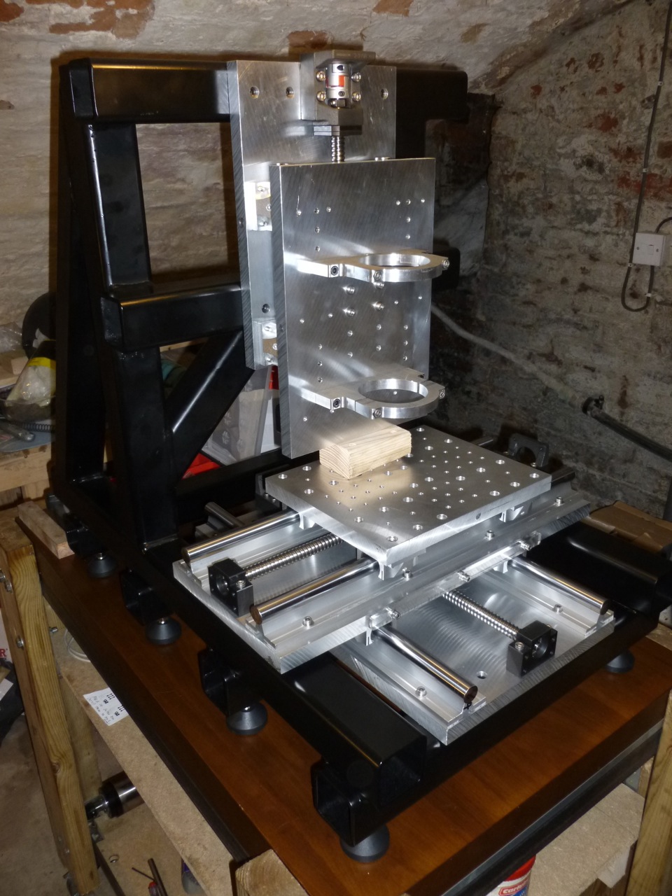

Really nice wal, great job on both the machine and the first jobs! Are you pleased with the accuracy? Jim
Great stuff Wal, good to see things cut by your machine. Must give you great satisfaction!
Great stuff and always nice to see parts coming off of a machine.
What CAM software did you use for those?

Jim - accuracy wise, yep, for the kind of stuff I'm going to be making I'm reasonably happy with the accuracy. Of course, compare this to real world precision engineering and it's just a toy - to take it to the next level would require not only better grades of accuracy/stiffness in the components used, but also a more refined approach to assembling/measuring/adjusting the finished machine. For example, (using the rather laborious process of shimming) I can get the dial gauge mounted in the spindle to stay at 0 spinning it from the left to the right of the table - however, front to back I'm seeing a 0.05mm rise over around 20cms. I'll try to iron that out, but for the moment I'm living with it.
Adrian, software wise - .pdf of the profiles/pockets/drill holes etc. generated in Illustrator. Toolpaths created with Vectric's Cut2D (really nice, easy to use piece of software - can't recommend it highly enough...) Machine control by LinuxCNC - again, top software and easy to get a handle on the basics of operating it (which is as far as I've got).

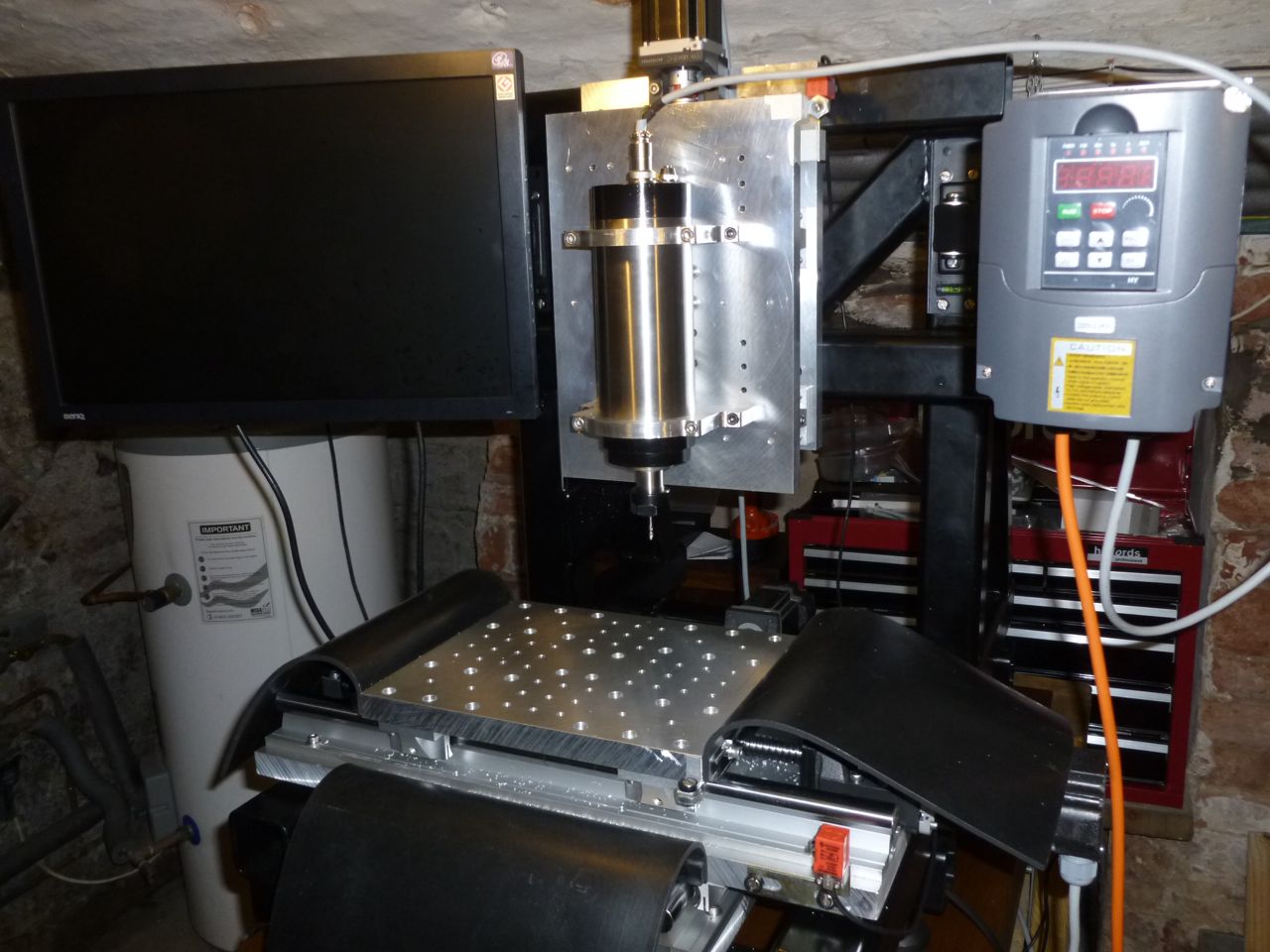

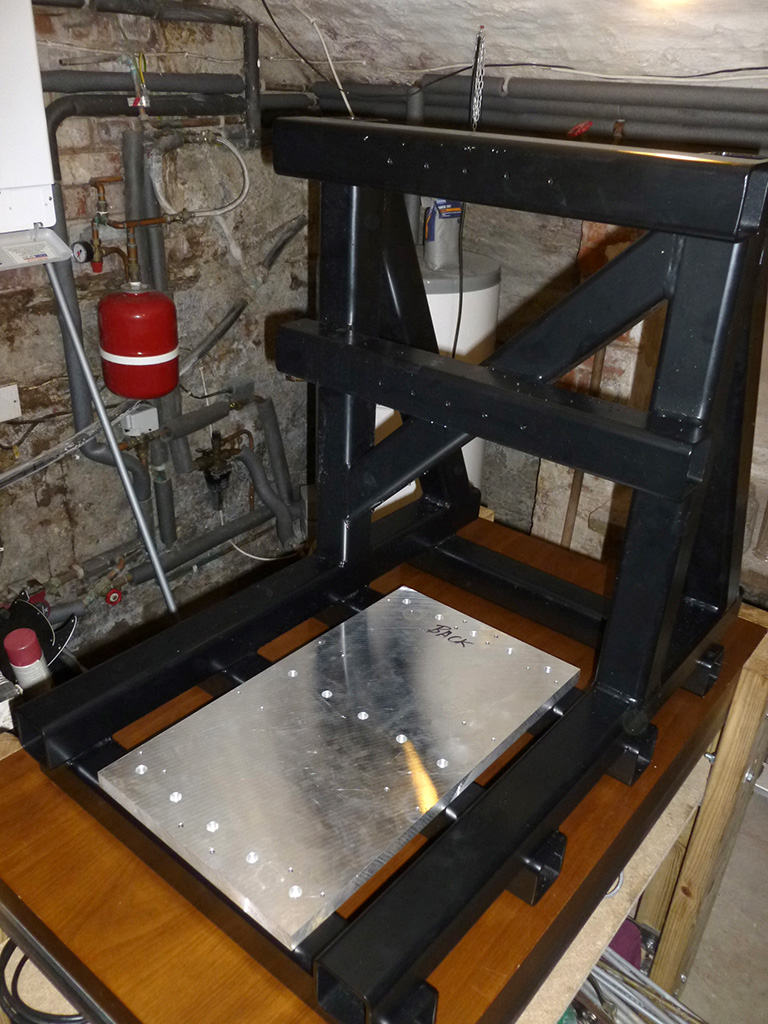

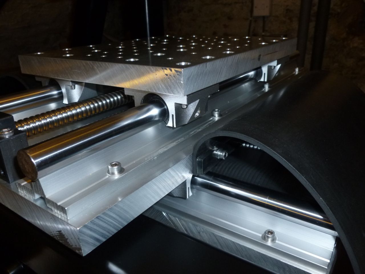

Wal, I can't remember seeing finished pics of your machine? Are they somewhere and I'm blind or you keeping it a secret? :tongue:
5 Attachment(s)
Hi Neil,
I think I posted pics on one of the other threads, but this should give you an idea:
Attachment 11607 Attachment 11606 Attachment 11605 Attachment 11604 Attachment 11603
I'll be putting together a retrospective build diary at some point in the not too distant future.
Wal.
