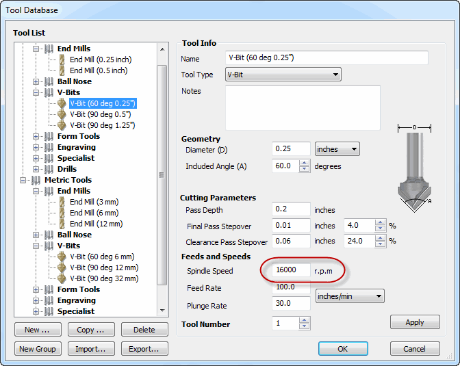

Hi Suesi, I tend to use whatever settings are recomended in my tool path software. They have far more experience at that sort of thing than me. Im Lucky as my spindle will hit 50k rpm if needed.
Attachment 11704
