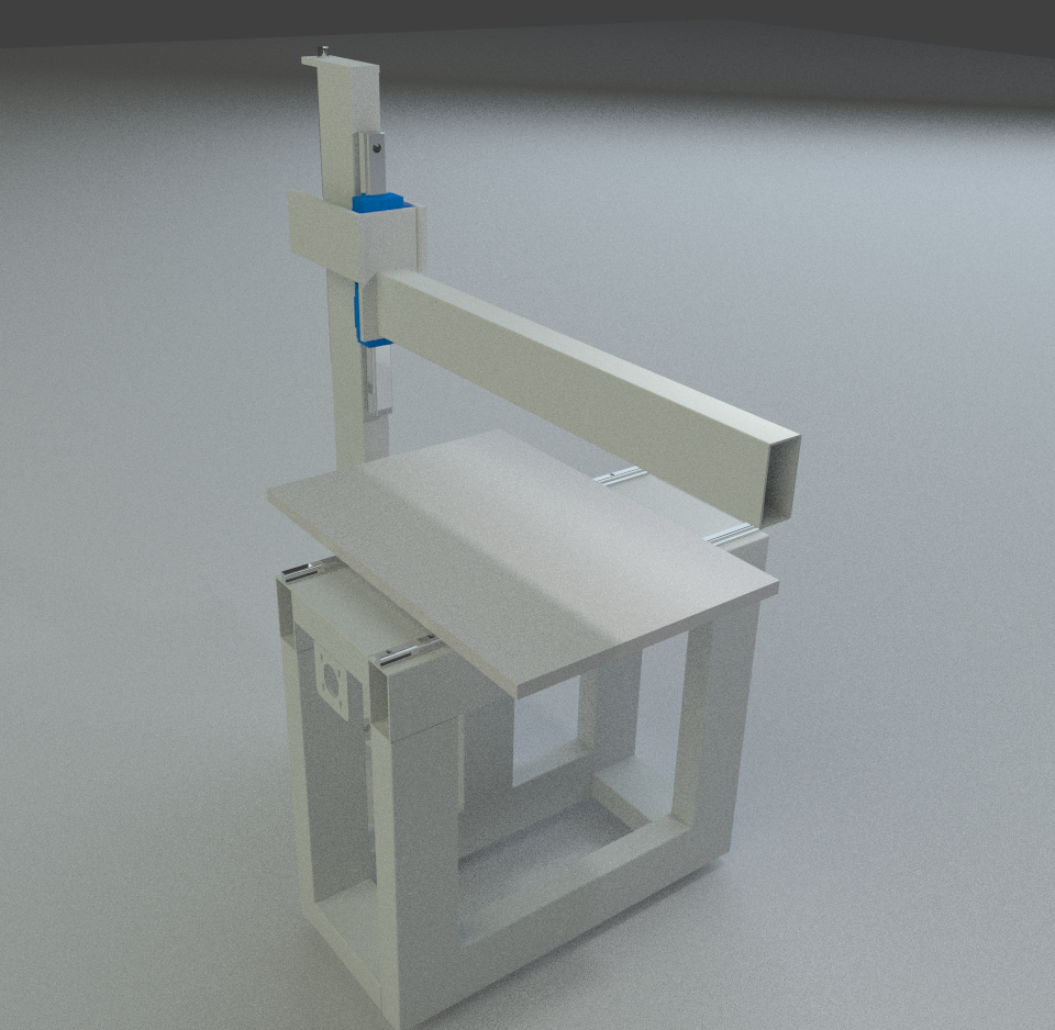

Im thinking about a steel frame to mount a ballscrew driven y axis (moving table) and then a cantilever x axis with either ballscrews again or belt drive. The X axis needs to be faster for raster engraving but the best laser results I have seen are from Tweekie cnc little router/mill/laser contraption and his great machine uses screws or ballscrews?
The cantilever x-axis can move up and down in the Z to allow for different work heights and then laser head optics will also be adjustable for fine tuning.

I have been thinking about how to lower and raise the cantilever gantry on the laser.
A couple of linear rails with a lead screw down the middle that can be turned via a hand wheel is one way. This would be locked off with a clamp of some sort. I am missing an easier and cheaper way of doing this.
If I went with profiled rails I could get away with using a set of second hand rails as accuracy is not too important.

Simple 3d layout
