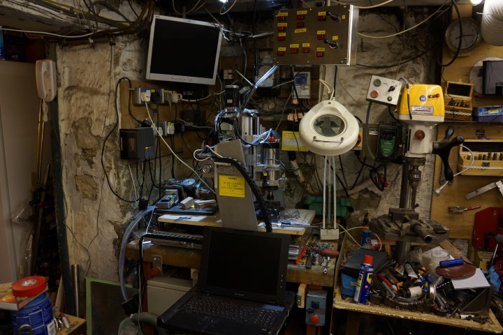

Heres my finished panel
Many thanks to Jazz for his patient help on the phone explaining to a numpty like me how to use the screen software
I've dangled the box from the ceiling so I can use it easily stood up while setting things on the router
Works perfectly for what I need to do very please with itAttachment 11935Attachment 11936Attachment 11937

Your Welcome and pleased your working.! . . . It's also nice to see someone else have the same " I know where everything is" organised workshop. .:beer:

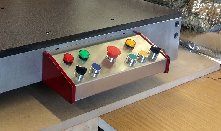

Not seen a thread on control panels but it's not difficult provided you have enough inputs or some keyboard emulator. I don't build control panels as such but do build in some small form of control on front of machines. Like this.!
Latest one just done has a joy stick on and few other buttons for Axis Jogging but not no pic sorry.!
Attachment 13308

Any chance you could list the controls for me? There are a lot of buttons on the Mach3 interface I haven't tried yet, some of them might be useful for all I know.
Re: Mach 3 control panel help
Can do but not all are controlling mach3 modes in fact only 3 mach buttons are controlled via trigger codes. Cycle start, feed hold and Reset. Some signals are sent to Mach inputs to inform about E-stop and to reset after E-stop etc.
Starting left to right.
#1 On/off switch and LED This just turns off 24v to control system so nothing can be turned on.
#2 Momentary Reset and Led which latches safety E-stop circuit(relay) on and Reset's Mach.(Trigger/Button)
#3 Oh shite Button connected to latching circuit and Signal back to mach informing E-stop(Input)
#4 Cycle start (Trigger/Button)
#5 Feed hold (Trigger/Button)
#6 Limit override
