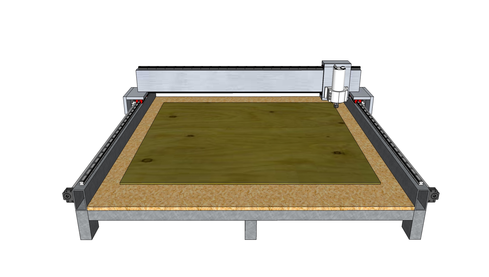

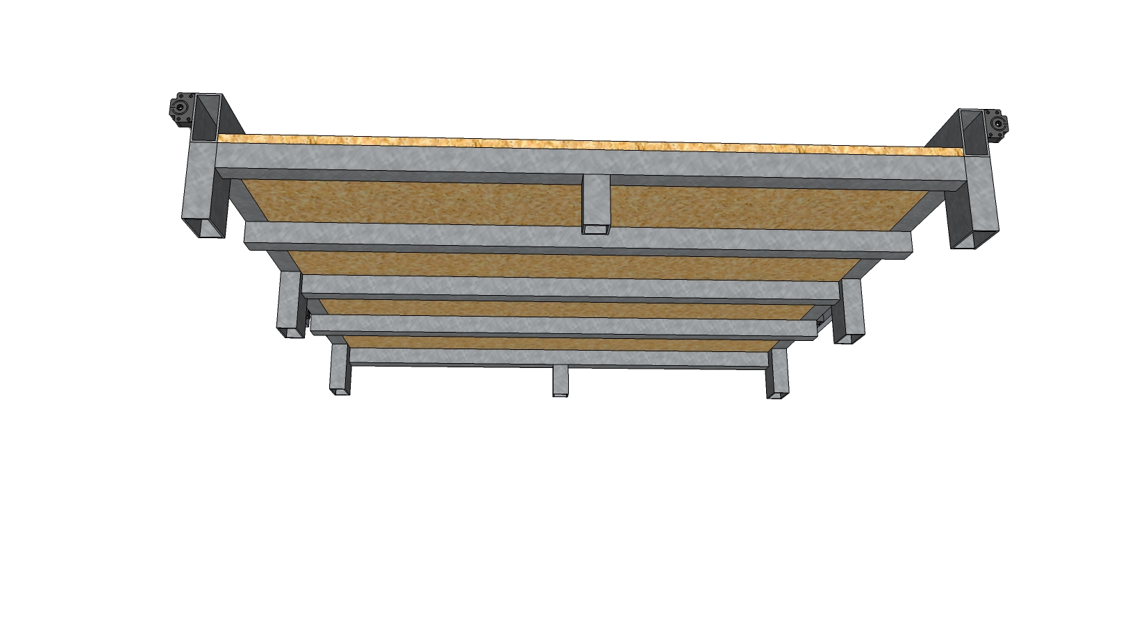

2 Attachment(s)
Re: NEW TO CNC - Starting design and so forth
Question is what is your budget? Just spent 10 mins knocking up a quick design on Sketchup and I reckon you can build the base out of one 7.5m length of 100x50x4mm, one 7.5m length of 50x50x4 steel and one 3m length (chopped into 2 x 1.5m lengths) of 100x50x6mm Ali plus a spoil board of either MDF or Ply. With a length of 1.6m you could just get away (I'm sure Jazz or someone else will confirm) RM1610 ballscrews and 3Nm Nema 23 steppers. If you were frugal it could be done for approx. £2k with half decent electronics (like AM882 drivers, PDMX126 BOB, home made PSU etc.) and second hand (from fleabay) THK or NSK linear rails.
I've not drawn everything in, but it should give you an idea. The frame/bed will need more bracing and supporting but you'll get the idea from the sketch...
Attachment 11776Attachment 11777

i could do 2K, it would be a well used tool in my workshop so if needed i could push the budget further. that design is exactly what i intended to draw but i have no experience of machine design. thanks for spending time drawing it, i didnt expect anyone to go that far. amazing help.
where can i read simple info to help me understand the mechanics behind it all? i have unanswered questions, like how to set up a stepper to drive the x, and how long is the belt going to be to fit exactly, or do i make an adjustable mount for the stepper to tighten the belt up once fitted?
if i were to produce a full sheet cutting bed, what would i use instead of ballscrews, and how do i work that out or are there examples on other build logs that you can point me to?

Yes it's for the Gantry, with a 10mm Ali plate bolted to the front.
Generally people only go for one ball screw on the Y axis as the bearings aren't spaced that far apart. See added components in pic below.
You're welcome to have the SKP model if you want, PM me your email addy and I'll send it to you.
Attachment 11780

Hi all,
after a chat with a few people, and a lot of help from one in particular, this is my new and possibly final design for base framework.
Attachment 11877
If the 'top' view shows the actual bed, then I think most would put an additional support right down the centre, top to bottom on your drawing. Also on the screen I'm using just now I can't read the dimensions due to their colour.
