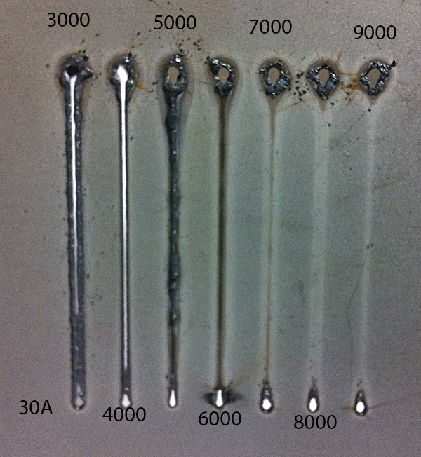

i had a chat with the plasma supplier, told them of my woes and the only suggestion they had was to rive an earth rod, connect the terminal on the cutter to that and then connect the CNC table likewise. Unfortunately I couldn't drill a hole through the factory floor so I just connected the terminal to the table frame.
I tried that and managed three pierce tests this time but then locked up again.
Then I disconnected the earth from star point to PC case and it worked! Passed repeated pierce tests, then I run a simple cut-line test of six 70mm lines at reducing speeds, table was still responding so I ran another test pass followed by a more detailed test and it still responded afterwards!
here's the results...
Attachment 11783
numbers are mm/min at 30A.
i like the result at 4000mm/min, it's very fine and about 0.75mm kerf, this is 1.5mm sheet so very thin.
i gather the point where it closes up at the end is due to deceleration?
anyway, it was getting late so I quickly dialled in 4000mm to my next test in sheetcam and compiled the g-code.

Well, all is still not well.
I had some more play time today, tried some 30A test cuts and it's messing about, stopping cut motion midway, throwing e-stops, losing co-ordination etc.
It will be even worse if i plug the PC into the same extension as the system, I have to run two extension leads back to the wall socket just to get a partial success.
If it was 100% because i have no ground rod then i would stop testing until I take the machine home where I can fit one, but I'm not totally convinced it is that.
The system has a filtered plug fitted and the pc has an in-line filter fitted.
Not sure where to focus my efforts now????

Re: What has gone wrong????
Just had a chat with the suppliers and they feel the generator is not switching to full power i.e. I am cutting (or trying to) with pilot arc power which is about 20A on this model http://bbs.homeshopmachinist.net/ima...lies/frown.png
They are sending me a new (tested good) hand-held torch for test purposes and while waiting they have advised me to try upping the air pressure to 75psi just for a test.
But basically at 30A and 1.5mm sheet, it should practically vaporise the damn thing at the slow speeds I have been trying!!
Will know more tomorrow.
