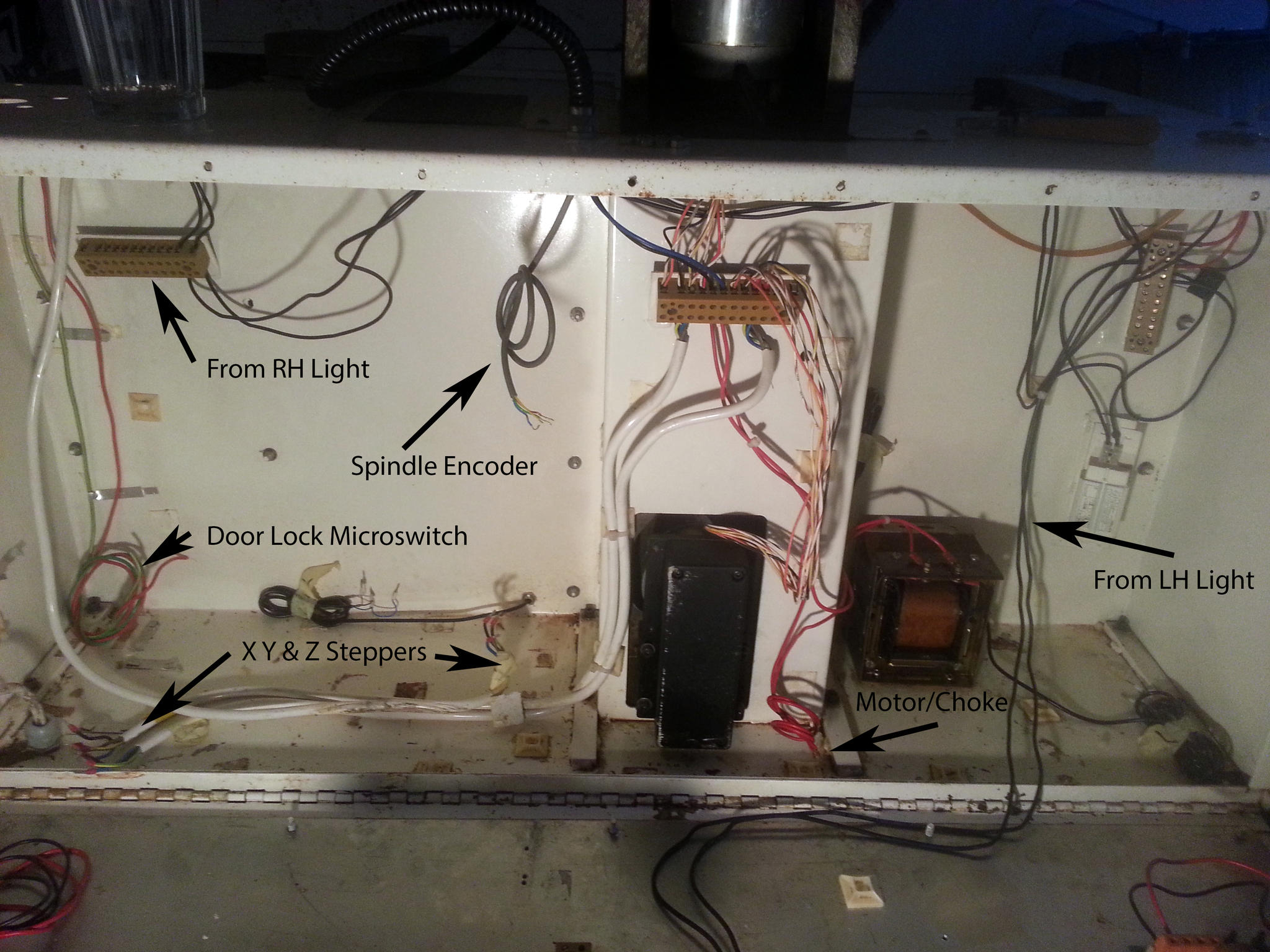

6 Attachment(s)
Re: Boxford vmc260 to mach3 conversion

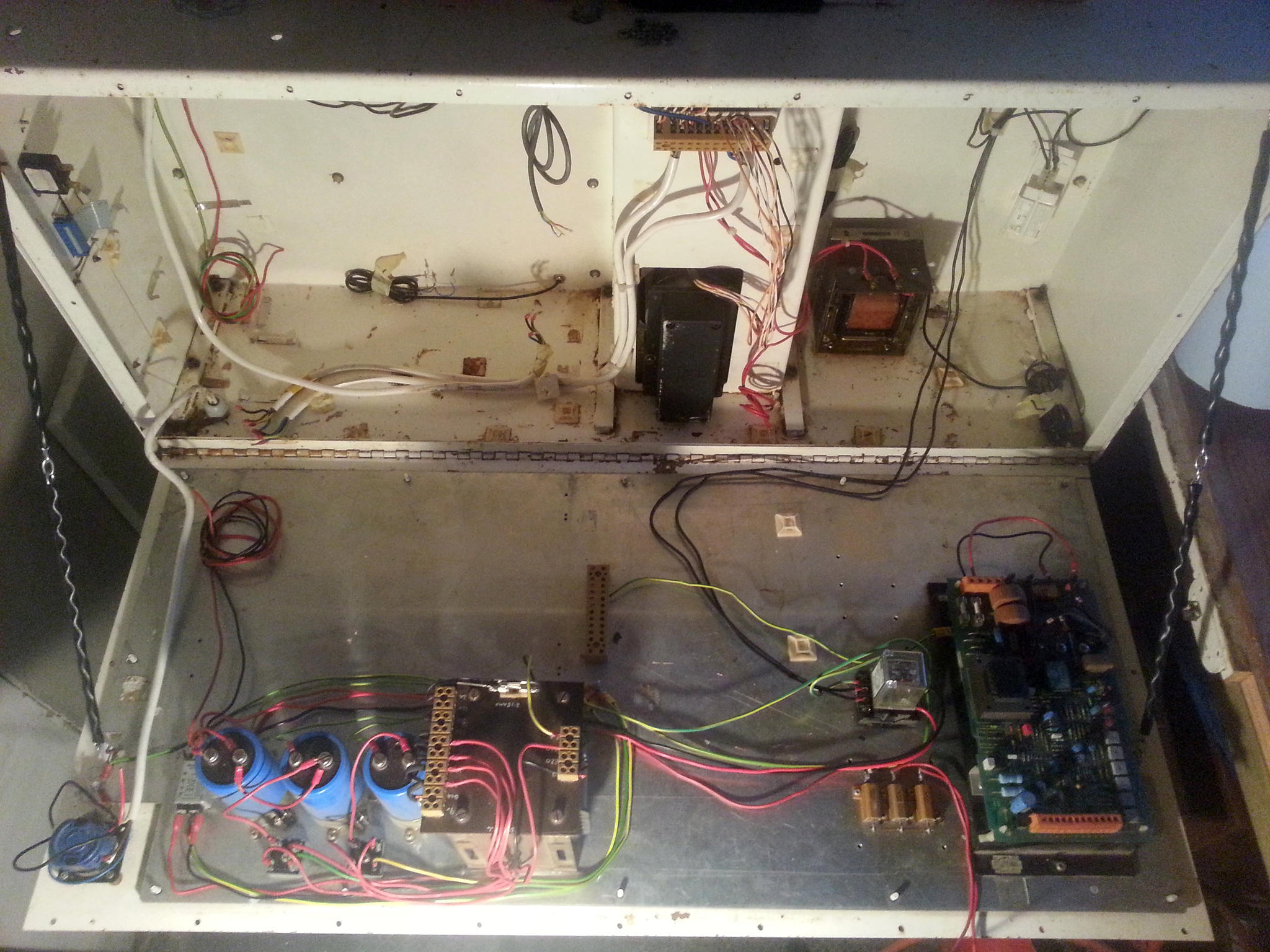

I tidied up the wiring in the back of the cabinet, I removed the Yasaka contactors as I don't need the CCW spindle functionality.
http://www.mycncuk.com/attachment.ph...id=14918&stc=1http://www.mycncuk.com/attachment.ph...id=14919&stc=1

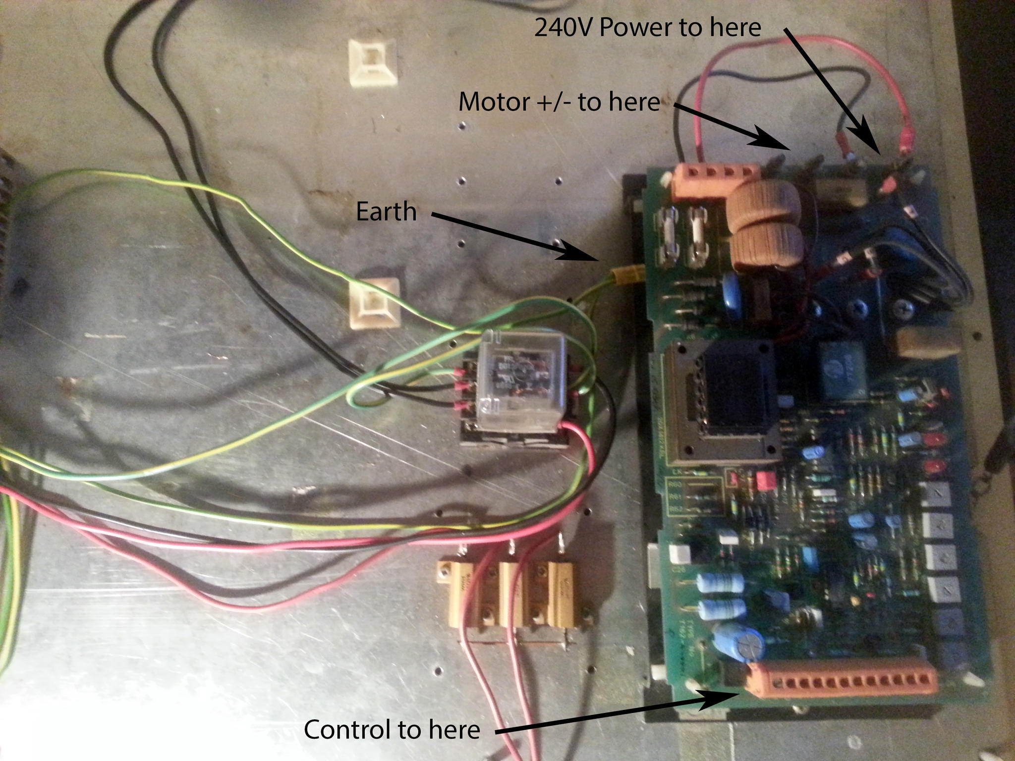

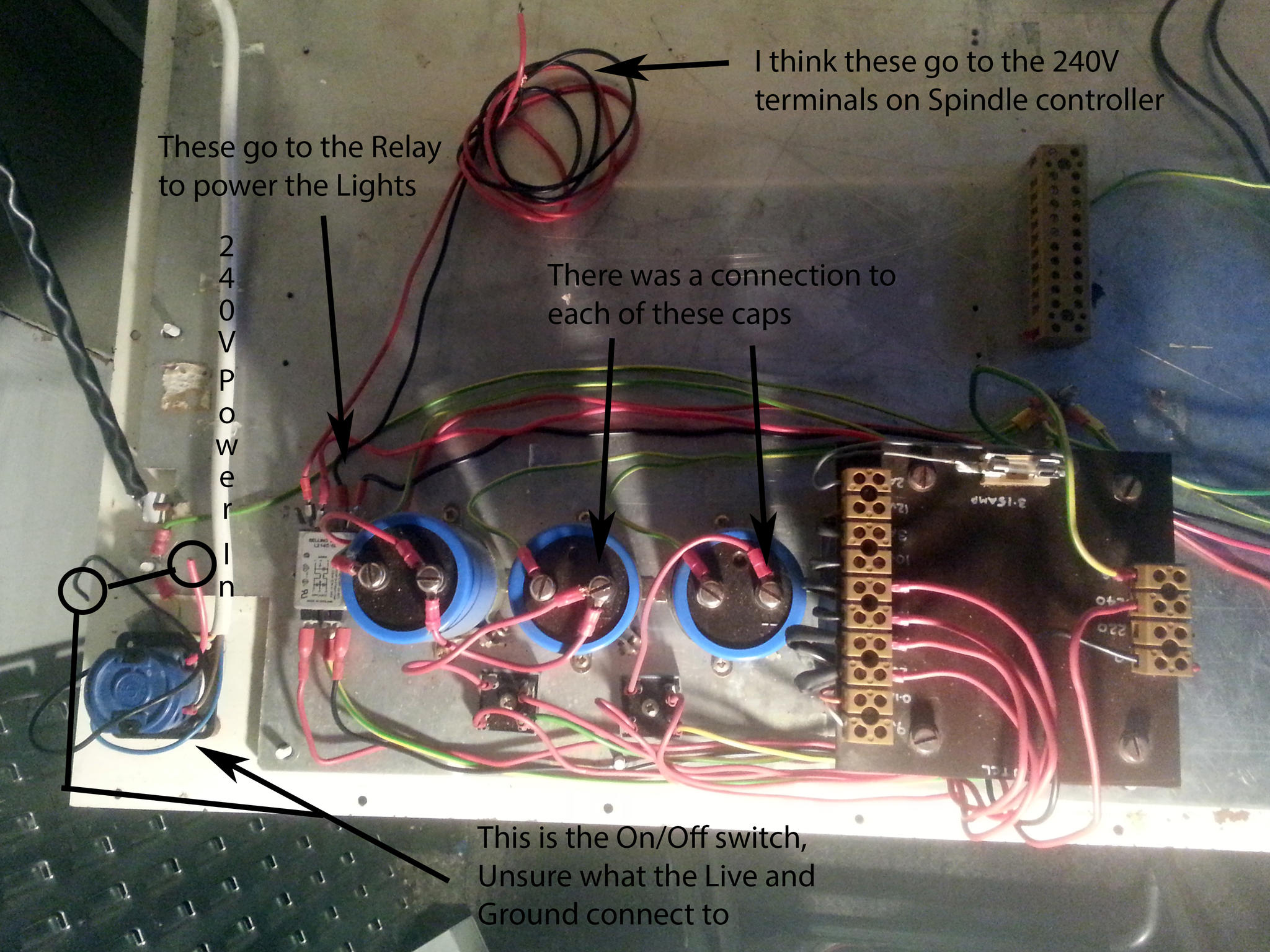

Here are some close ups of the Power supply and Spindle Controller
http://www.mycncuk.com/attachment.ph...id=14920&stc=1http://www.mycncuk.com/attachment.ph...id=14921&stc=1

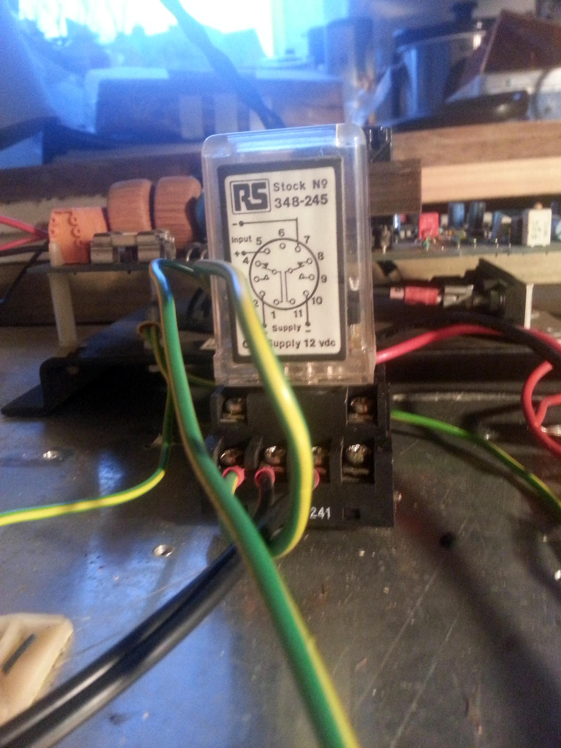

I am guessing that I can remove this relay as it would have been for the lights switch on the main front panel.
http://www.mycncuk.com/attachment.ph...id=14922&stc=1

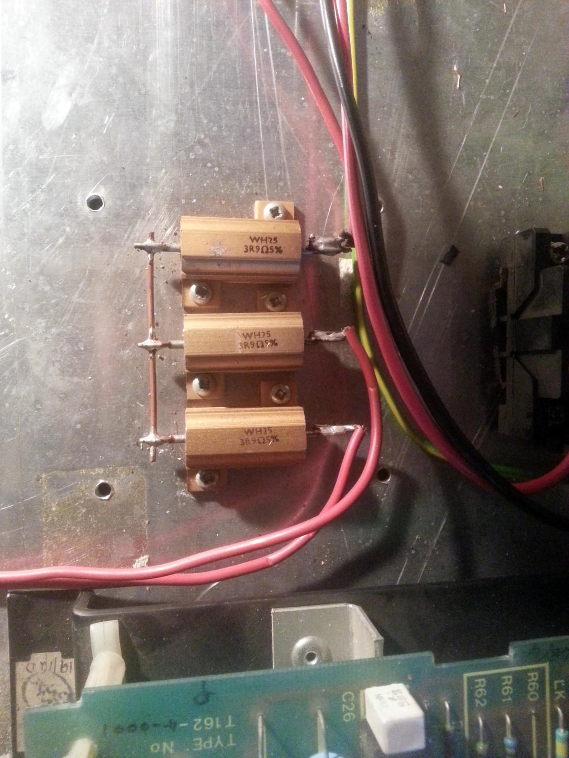

Not sure what these resistors(?) are connected to...
http://www.mycncuk.com/attachment.ph...id=14923&stc=1

Hi Nat, I found the original Boxford control/boards and wiring very confusing so have stripped down the machine to just the bits I will be keeping,
I have found some information on the door interlock...
http://blog.ckdevices.com/?p=12
http://www.machsupport.com/forum/ind...70.5/wap2.html
https://www.machsupport.com/forum/in...;topic=11590.0
It seems most people wire a connection across pins 3 and 9 on the speed controller to bypass the killswitch, I would guess that you could wire your E-Stop and door microswitch in series between these two pins depending on if they are NO or NC.
Sorry cant help with the resistors, does your machine work without them wired up to anything?

Hiya, yes the wiring is confusing.
most of mine is in a pile along with original electronics.i have used some of the cables to retire up my machine.
i am using a BOB board as I said earlier in post. The one I used has a 10v speed out for the spindle so I didn't need the spindlev4 board I bouht in the end. I blew a BOB board prior so went and bought some new ones.
the dspindle lead 3 to 9 is for the door lock, but as I have wired it currently, it only stops the spindle and the machine still currently runs in axis so sure way to break tool bits! I have it going 3 to front control panel chocblock where it is wired into the door interlocks, then returns to pin 9. I'm sure there is some link to emergency stop I should put in but I need to investigate this.
the 3 resistors I believe reduced the current going into the power into the relays to stop them burning out when in operation.
the mains filter feeds supply to the spindle controller and the lights so your correct there.
2 big blue caps are wired together and provide 18v dc, the other is 28v dc, you can get rid of one of the 18v dc caps and just use 1.
the relay is for the lights. handy to keep hold of it to fit later on, as provides good lighting to the unit. However prob easier to fit lights on when machine is on and bypass relay, or to fit 24v Led lights and run off 18v? Again to run continuously.
the spindle sensor is an optical unit, and unless you have some custom electronics to display spindle speed, or wire it into your controller, it's not necessary.
on the spindle controller, the are 2 rotary dials which adjust the lowest speed, and highest speed. I set mine up when it was running, but be careful, as its mains! Looks like your cover isn't with the machine, the orange plastic cover.
ground from the mains is earthed to machine the big aluminium plate. Live goes from the input, to the key switch, then back to the reset fuse the green and red button thing on the side, then back down to filter and spindle. I have my complete wiring diagrams at work, so will add them to my Flickr pool for you to see.

My resistors I have removed. They are connected to 28v and fed into the chocblock I believe they then went into the tool rotation circuit board and the boards in the electronics, but I didn't write these cables down post the chocblock, I forgot to do that one...
It is really good to have your emergency stop switch in, forgot to say that in the mains in, the emergancy stop has 3 connections switches. 2Nc and 1 no. The nc ones are red, no is green. One of the red switches are wired into the spindle mains supply to break mains power to the spindle controller. The other nc I have wired to the motor power so that the 28v to motors are killed so machine stops moving, but electronics are still powerd not the stepper drives. The no I have wired into my BOb so when it's pressed mach3 sees this as an emergancy stop.
the end stop electronic switches the small orange switches bolted onto x y and z, are important as the axis can ram into the metal frame of the axis, and potentially on the x it could let the ballnut off from the screw, although it would hit the chassis edge before, so... Yeah. They have 3 wires, black brown and blue, they are powered 10-36v so I power mine from 28v or was it 18.. The signal wire is connected to the switch input in your controller, and ground is put onto common ground.

Hi, thanks for the replies. I'll remove the resistors as I have taken the tool carousel off to make room for the monitor.
I have a homing switch fitted to each axis, forgot to label them in the pictures. Do you have hard limits set at the end of each axis or do you just use the homing position to set up software limits?
I have a pilz safety relay for my E-Stop chain, the CSMIO controller comes with a circuit diagram for setting it up. Ill post a picture when I have a chance.
I also have the same stepper drivers as you, the Parker SD3's, have you identified what colour cables are the step and Dir from the motors?
