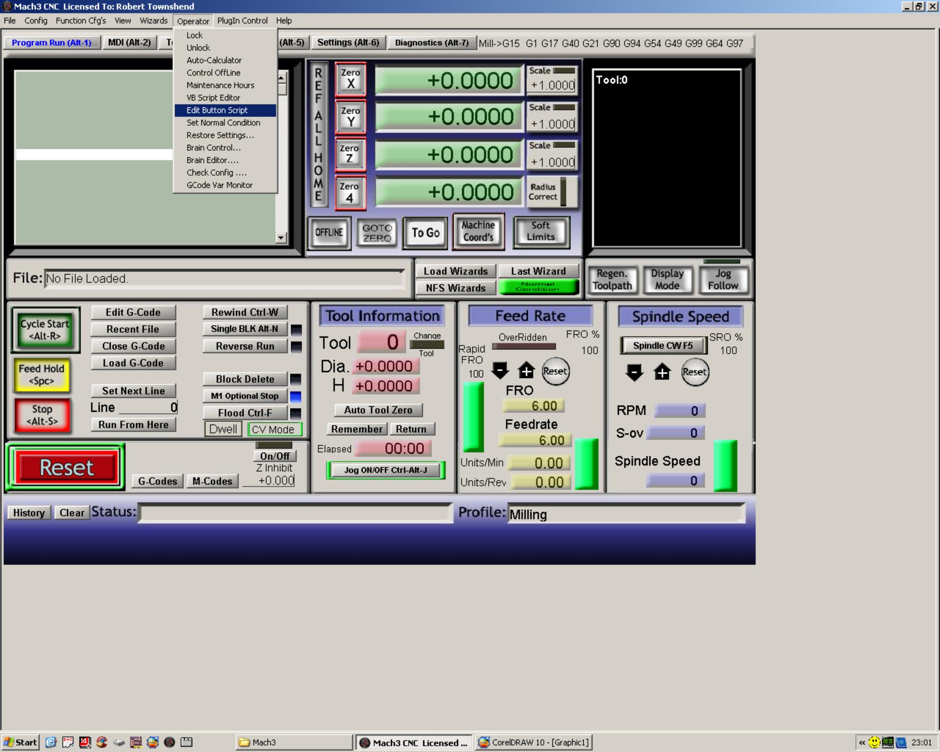

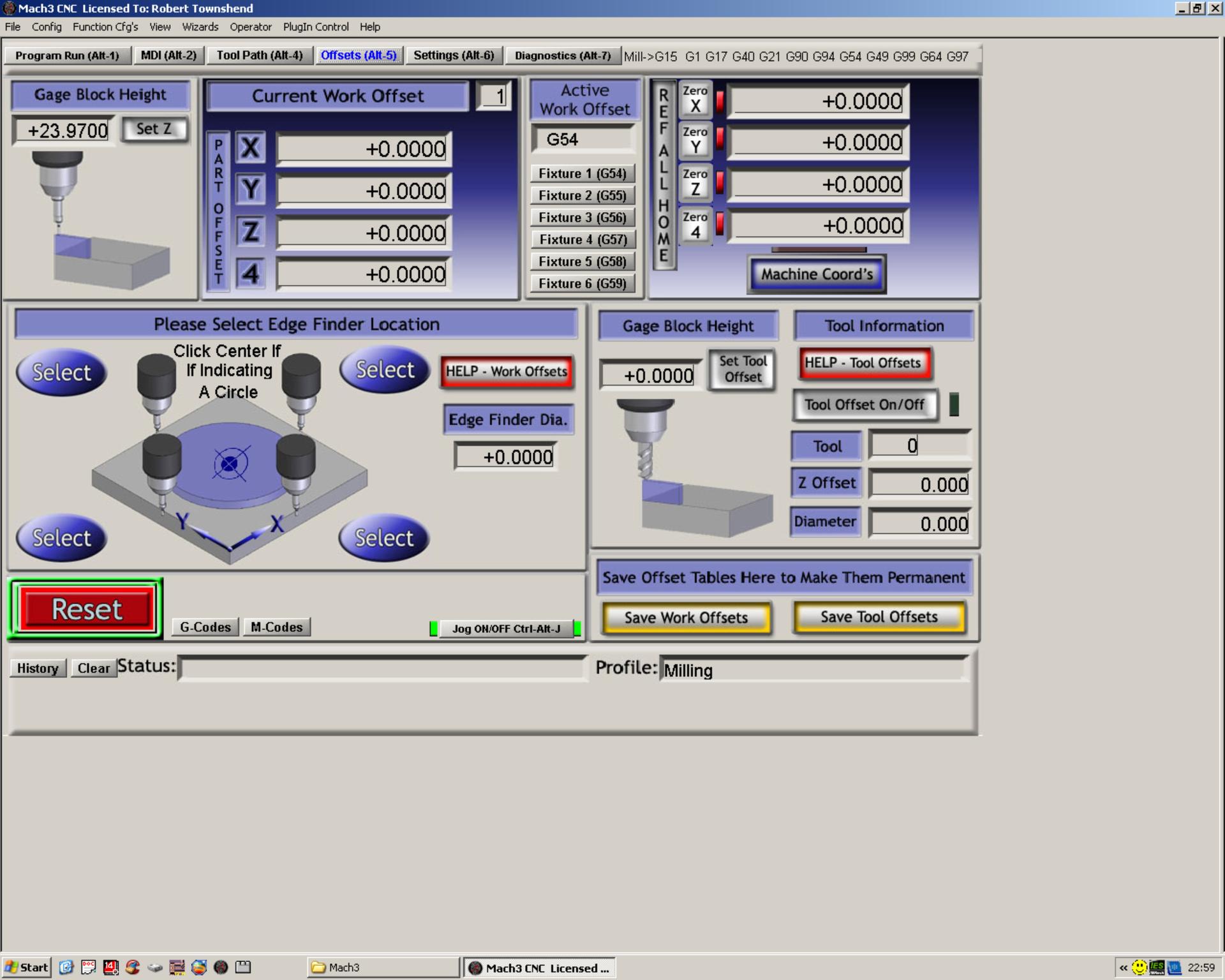

2 Attachment(s)
Re: Any ideas or thoughts on making a edge finder come touch off tool
Attachment 11875Attachment 11876
Have a look at these files.
Copy the code below into your clipboard.
Graphic 1 is the Offsets screen where you put in the plate height, in my case 23.97mm
On the main screen as shown in graphic 2 it shows the drop down 'Operator' and from that list select 'Edit Button Script'
Various buttons on the screen will flash, Click on 'Auto Tool Zero'
a window will open and whatever is in it select it all and paste over it with the clipboard contents from step 1. This is shown below. File, Save and Close the Script window.
'Tool Zero Setting Macro
' Change the following three lines to suit your machine
PlateThickness = GetOEMDRO(1001) ' Thickness of touch plate - leave this line, it is the value in the gage block height

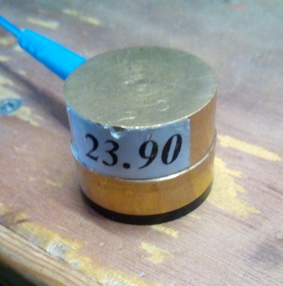

I am still using the touch-off block I made about 5 years ago, although it is getting a bit old and battered.
Attachment 26969
A simple bit of brass stock, faced off and an acrylic disc bonded to it and trimmed on the lathe. Turn it round and face the top and then mike it up to make sure the faces are parallel. Drill a 4m 'ole in the side for a banana plug et voila!
I find it more convenient to touch off the tool as I have a simple collets pindle.
